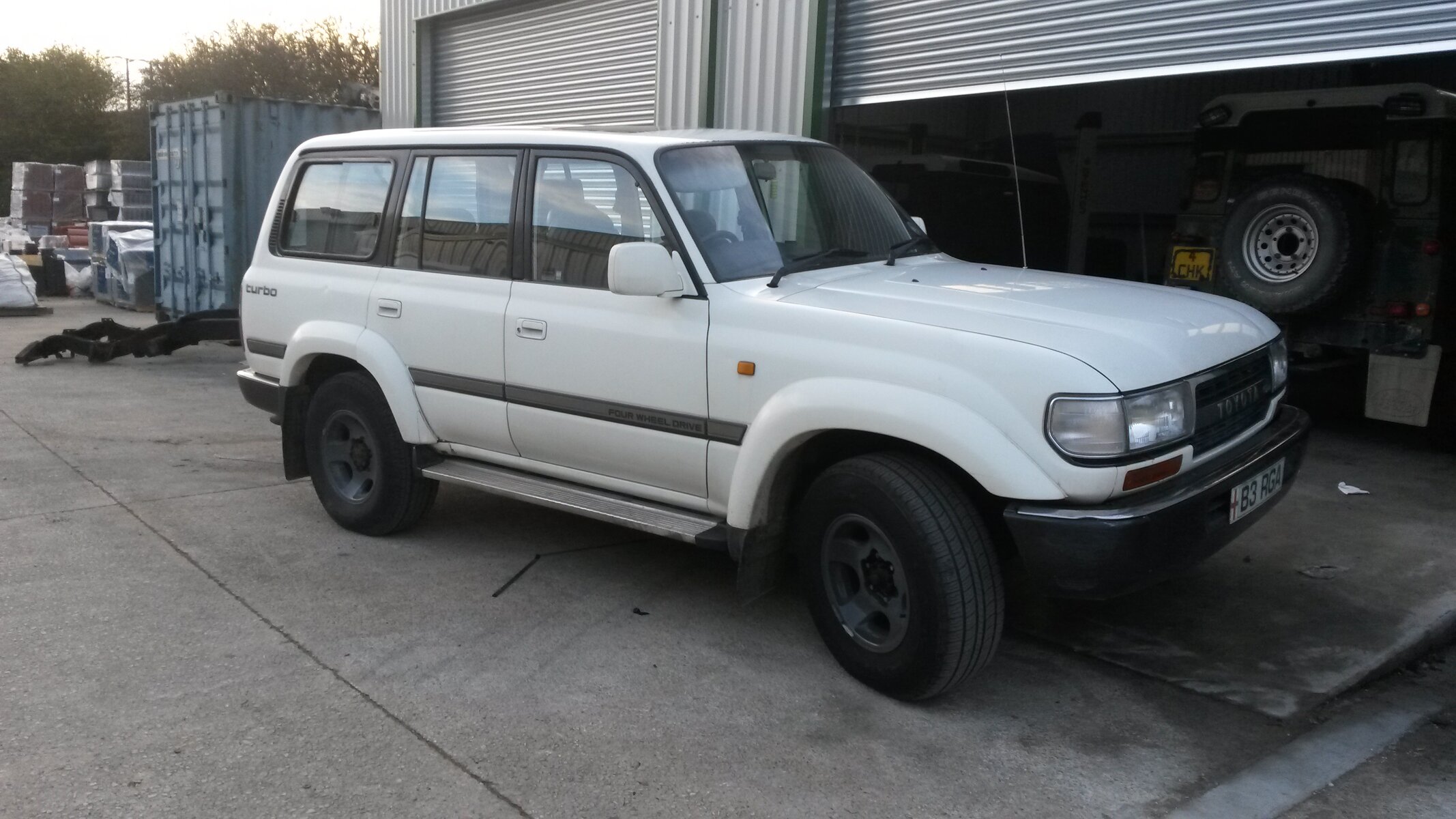

Time to start a thread about my new project. Although i previously owned an 80 series about 10 years ago i am a land rover man at heart (and i do land rovers for a living) but when i was offered this 80 in p/x for my supercharged range rover a couple of weeks ago i couldn't resist

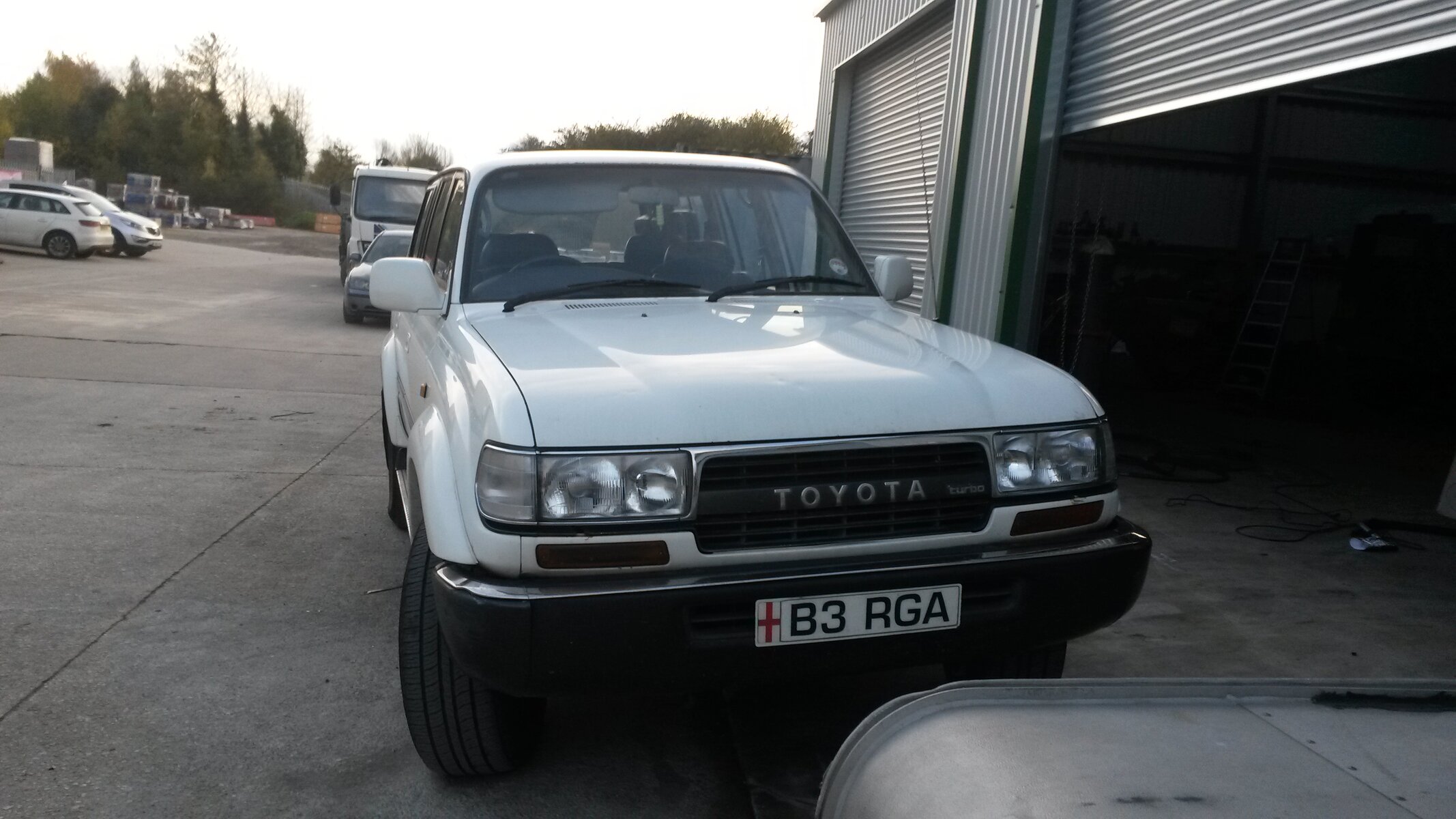

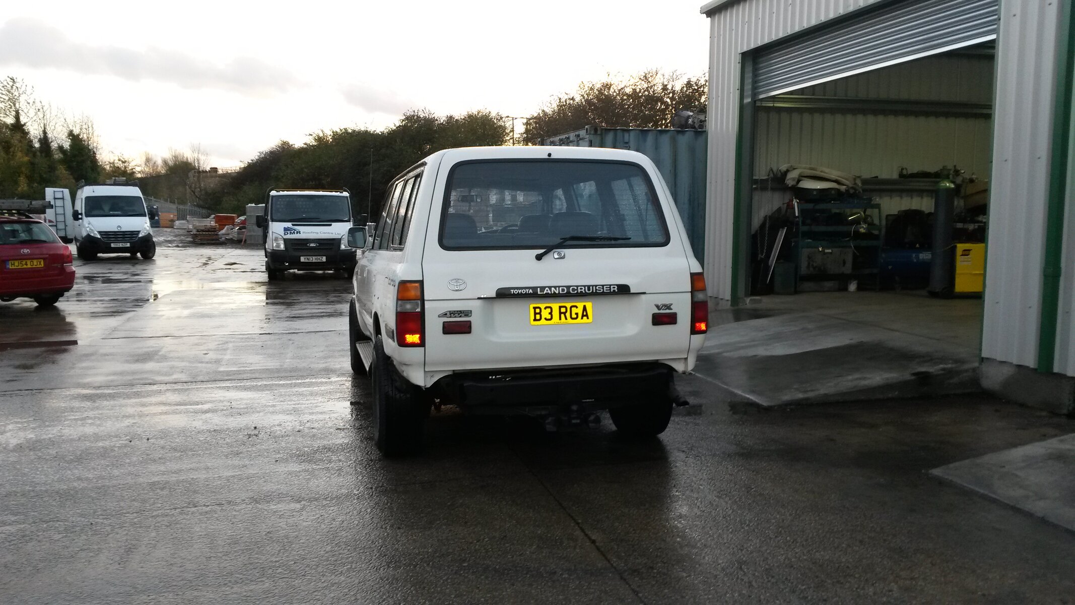

How it came to me a fortnight ago

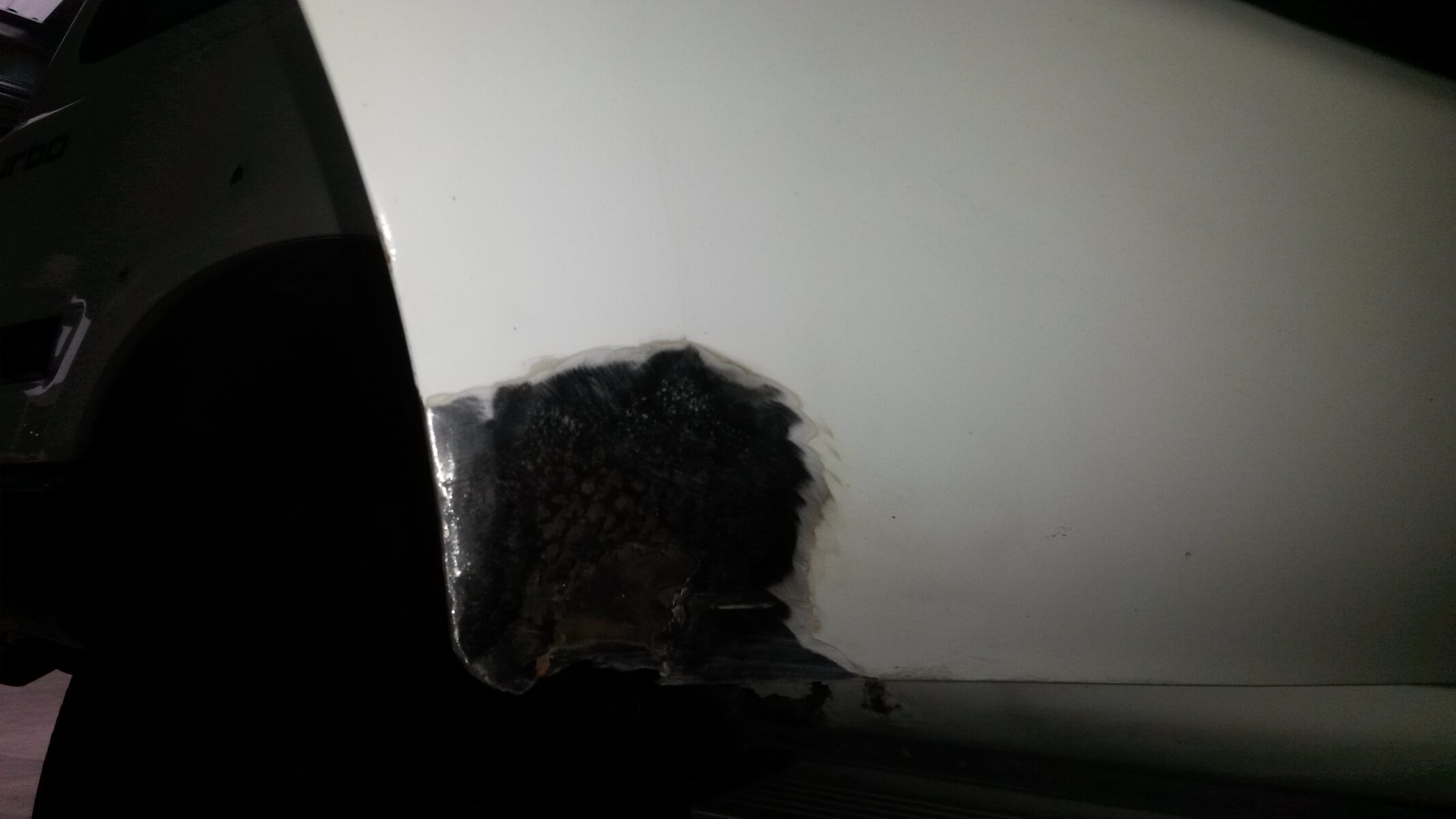

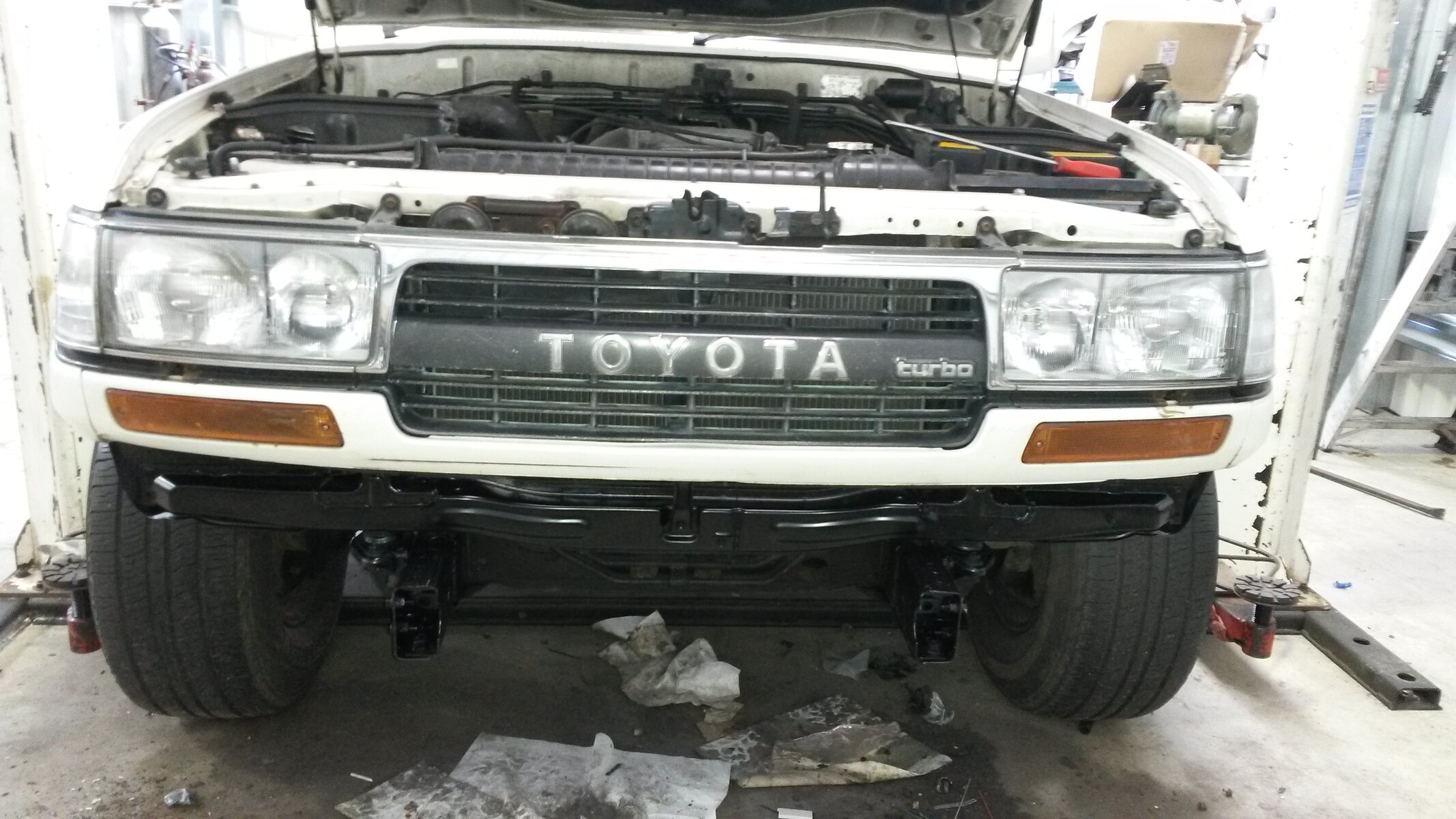

First jobs were to remove the wheel arches to get to the corrosion that was starting, sort a few electrical gremlins and tweak the fuel pump (surprisingly easy as its basically the same pump as fitted to TDi land rovers albeit with 2 more ports)

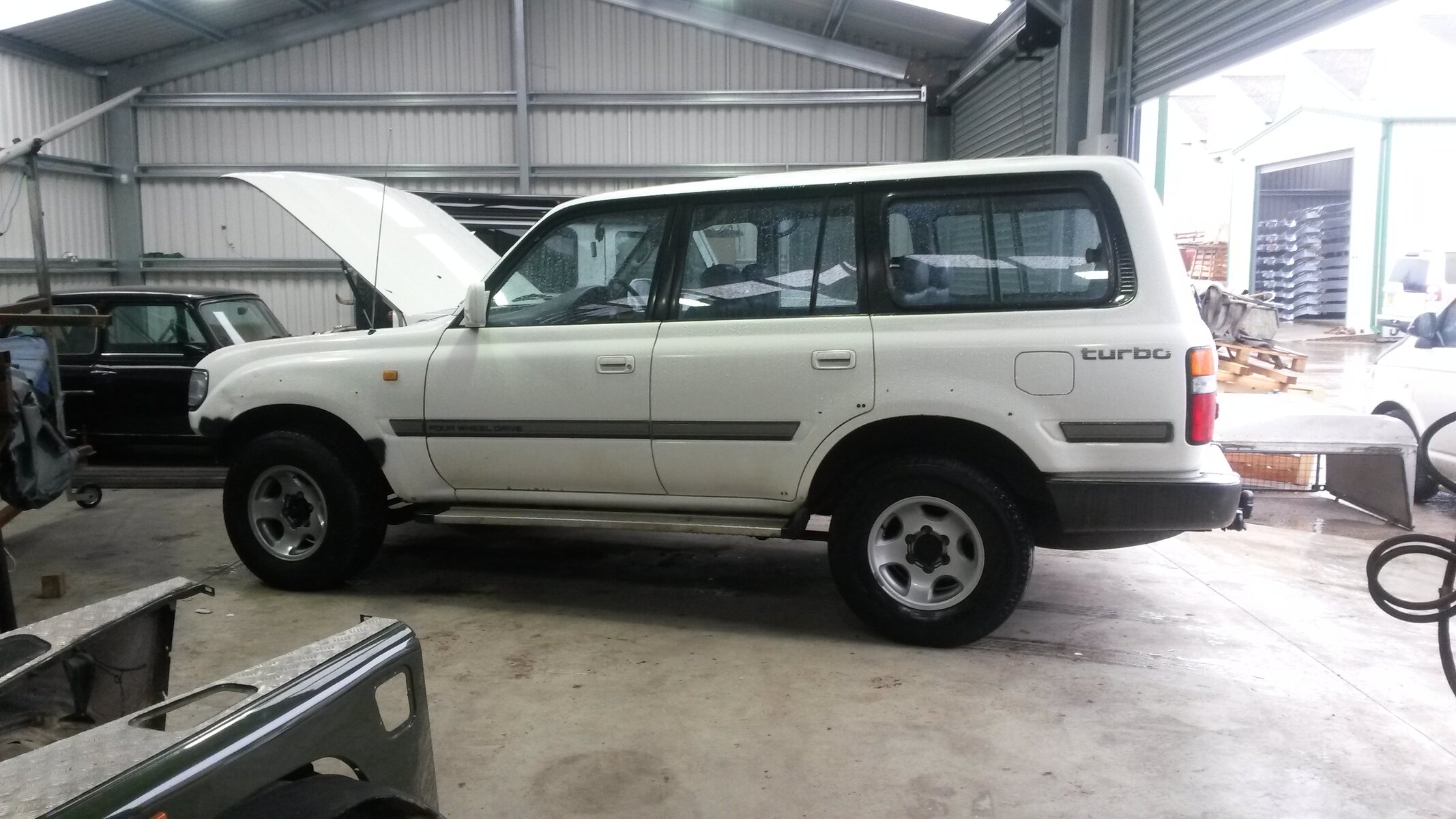

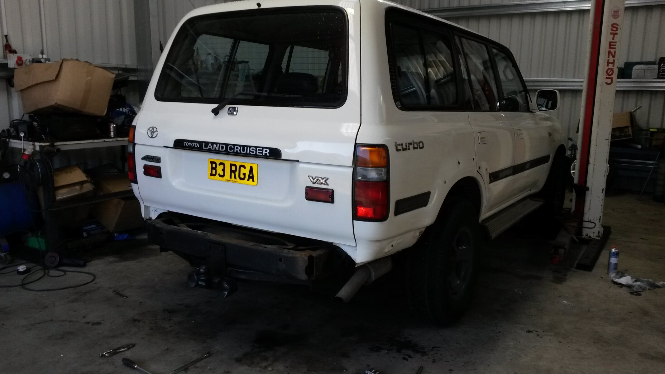

I made the decision that i preferred the look of it without the arches so set about welding the holes up and patching the rear drivers side door (although i may live to regret doing away with the arches as i am now looking at bigger tyres). I also started making a winch bumper

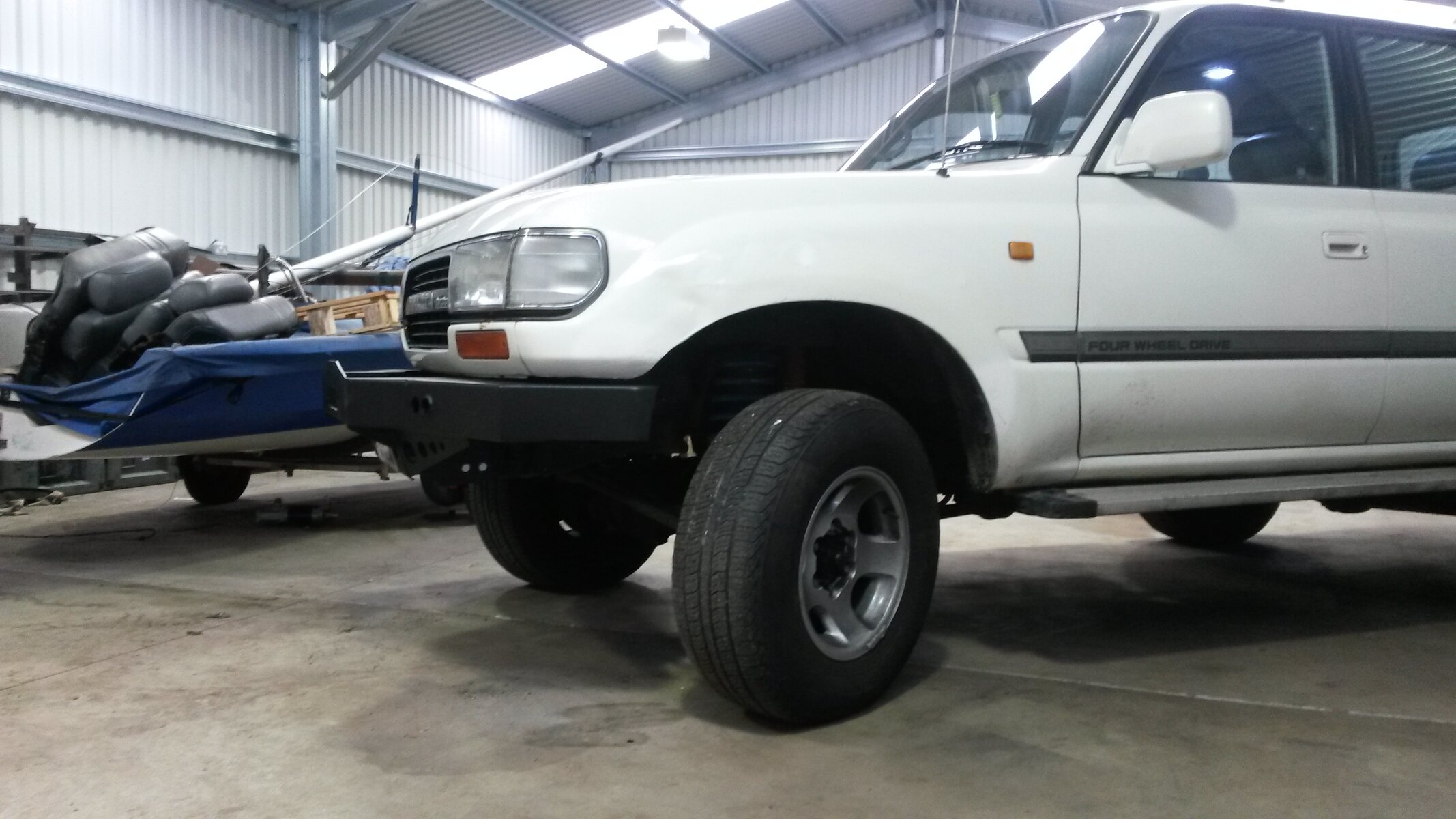

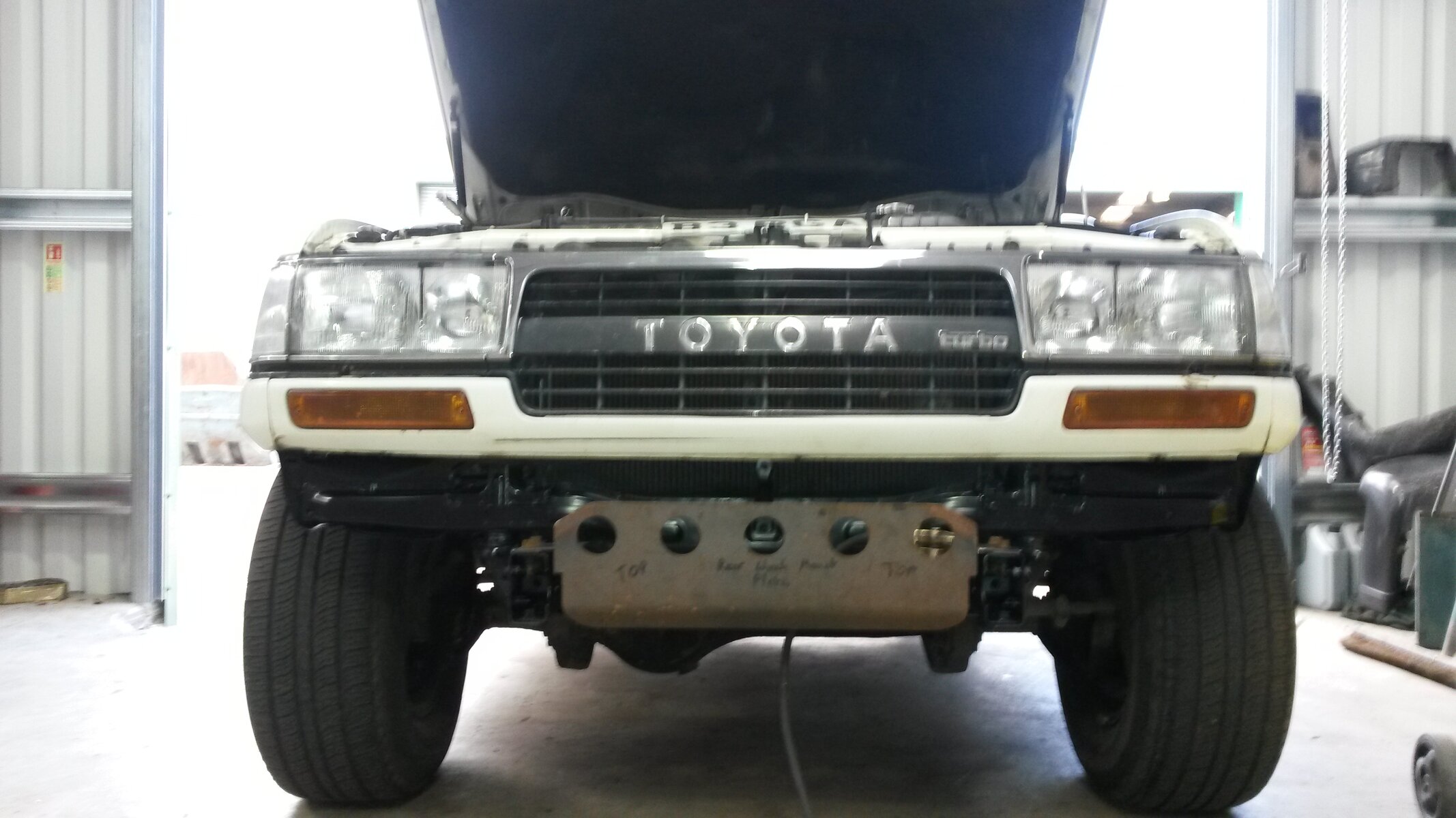

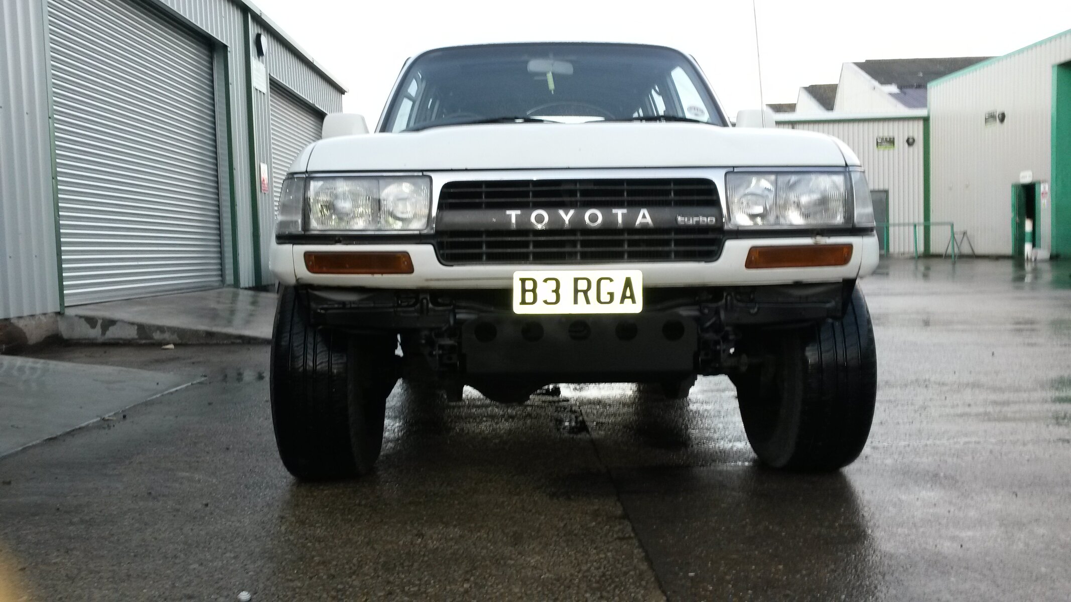

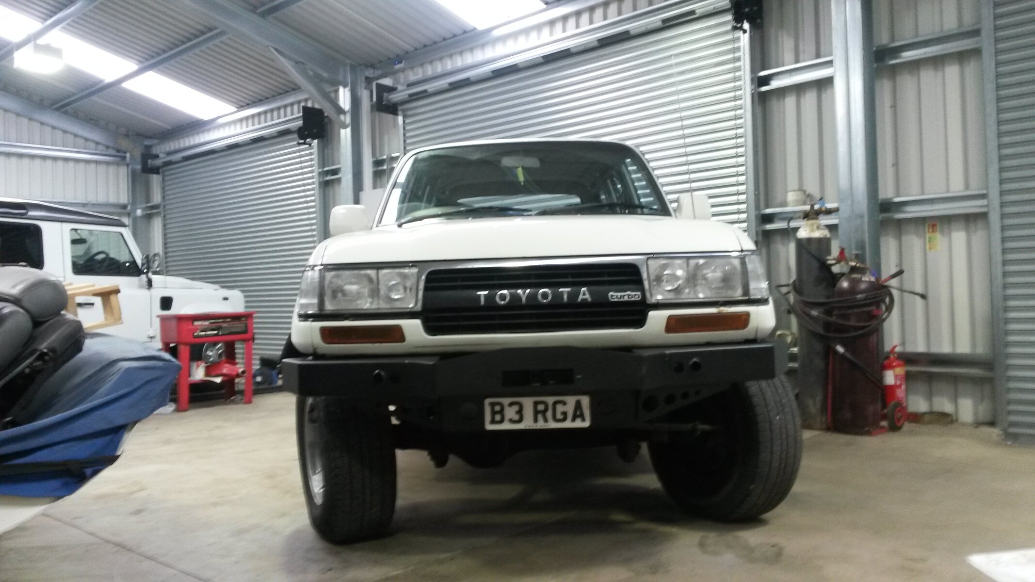

Next job was a 2" lift, which turned out to be more like a 5" lift due to how much the originals had sagged and i also found a winch bumper for sale on Ebay so decided to buy that instead of making my own
And thats about it for now, next job is some bigger tyres and rig the winch up:thumbup:

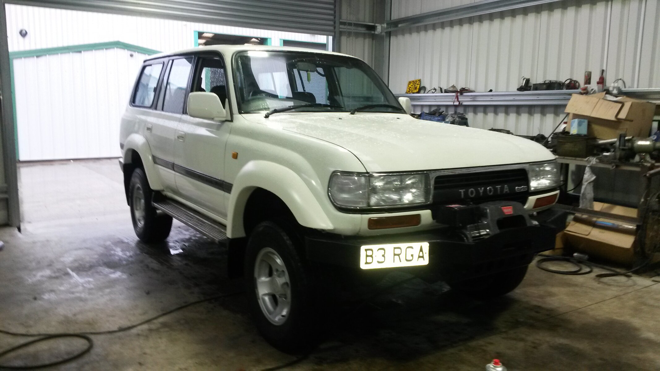

Bit of an update. Got the window rubbers fitted so now the windows wind up and down:icon-biggrin:. Have rebuilt one of my old winches and fitted it. Removed the full exhaust system and made a 3" straight through, although this will be getting some more work as it is currently too loud:icon-twisted:
I have also sprayed and refitted the wheel arches in readiness for bigger tyres

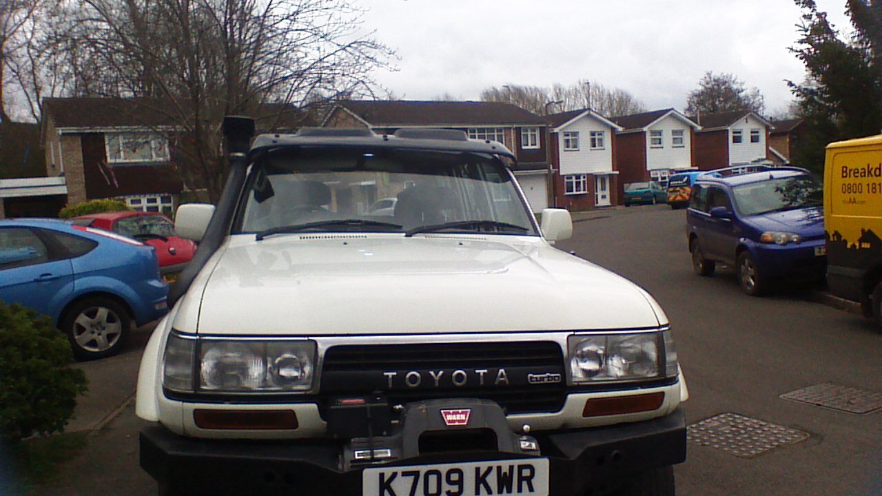

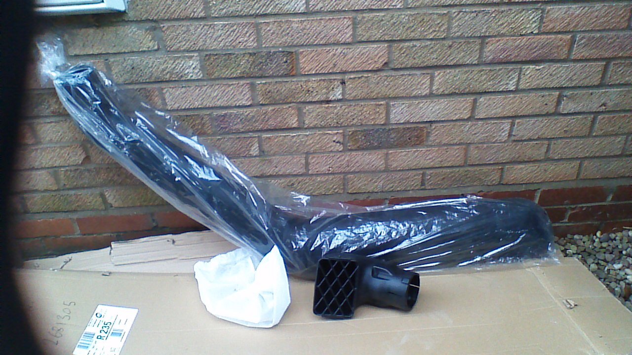

Hi guys being the new proud owner i was going to start a new thread but thought i might as well carry it on in this one.
Don't pick the truck up till next week but buying toys already, just bought a snorkel off fleabag for 59 quid, had one of these on the other truck for 3 years no issues, can't really go wrong for 59 quid, just need the truck now...can't wait.:icon-smile:

Sorry made a mistake, the snorkel wasn't 59 quid, it was 47 quid including delivery.... god bless China:pray:

WIN_20160205_154132.JPGToday i had a play with the truck, fitted the snorkel, had to arse about with it for an hour to make it fit (that's why it was 47 quid) but its on now.
Fitted my gypo windscreen sun visor off the old truck, was going to put a new one on but nobody stocks them any more, just wheels to sort now:thumbup:
Peanuts happy with his new expensive kennel:icon-biggrin:

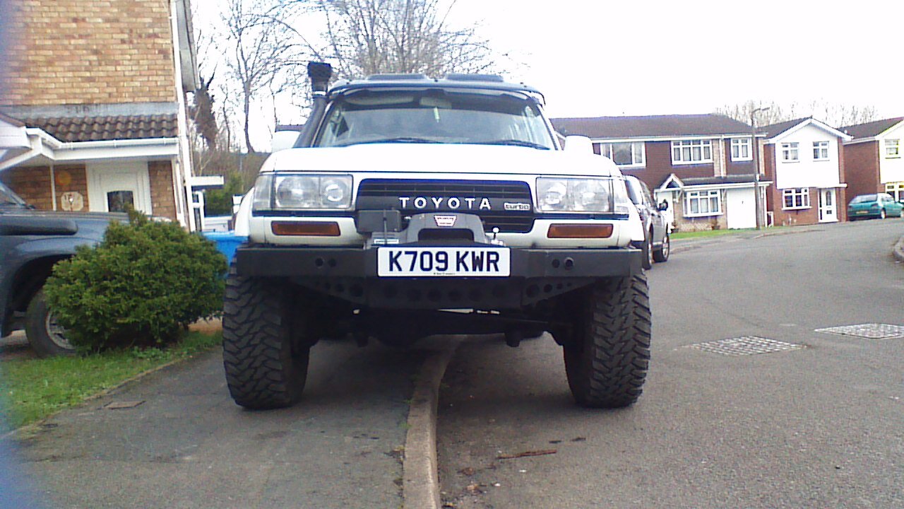

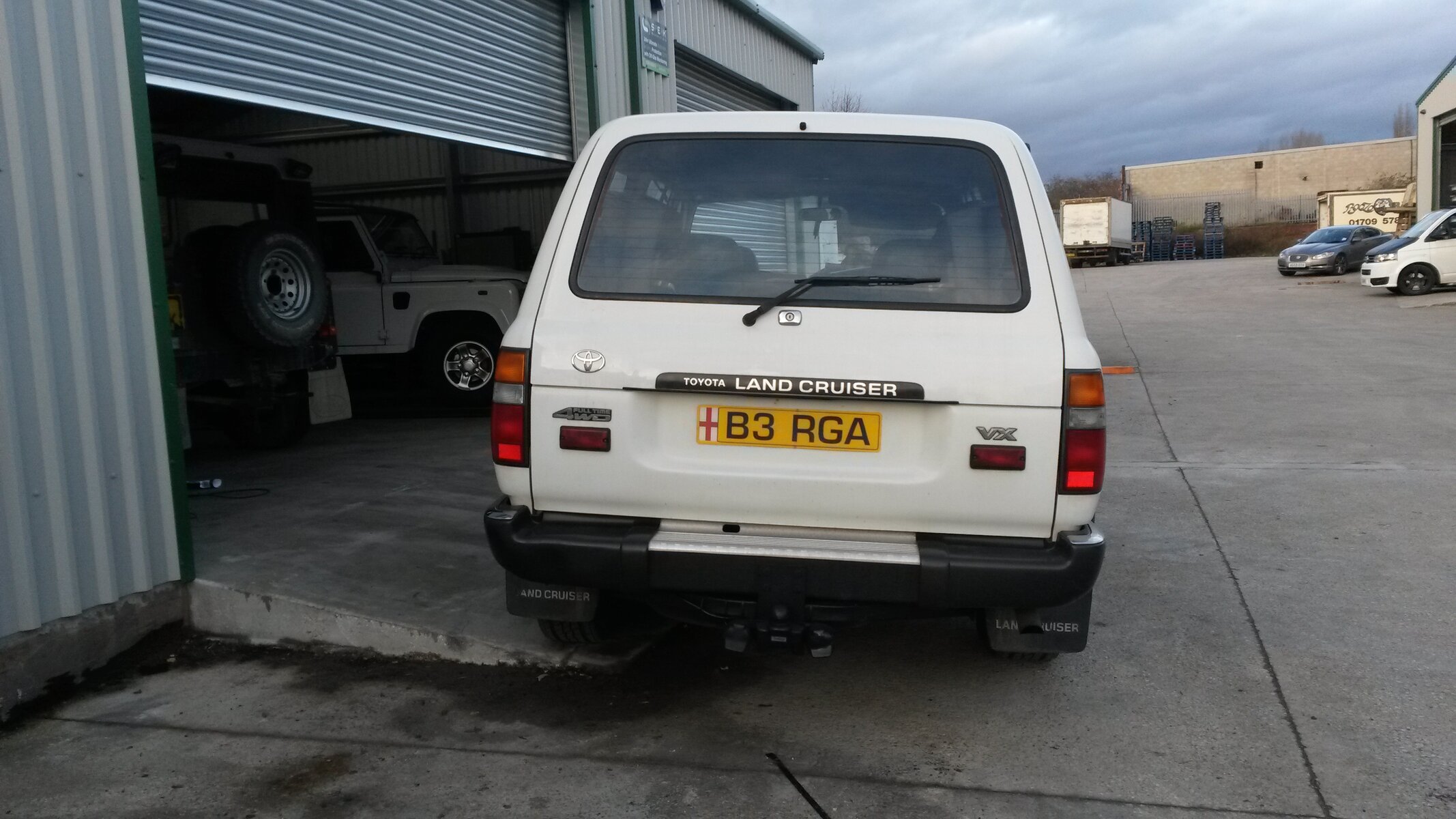

Got the wheels on today, had to use 30mm spacers to make em fit, not really a big fan of spacers, seen some come off..... not pretty:icon-sad:.
Only bought the tyres week before Xmas, so they were going on it no matter what, looks better and at least my 12 year old daughter doesn't think it looks gay anymore:icon-biggrin:.
Going to give it a run to Ynyslas beach tomorrow... just for the hell of it:thumbup:.
