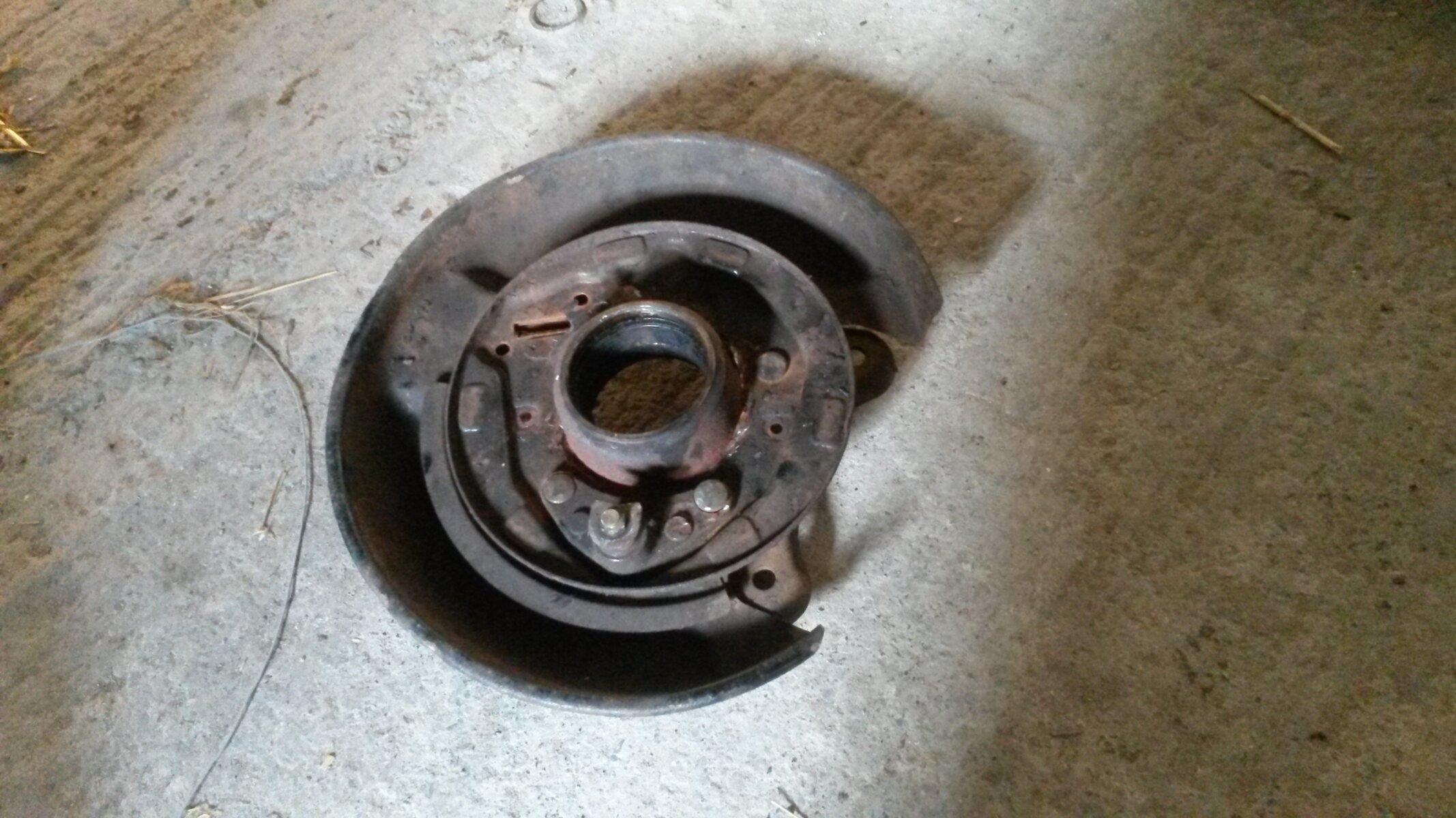

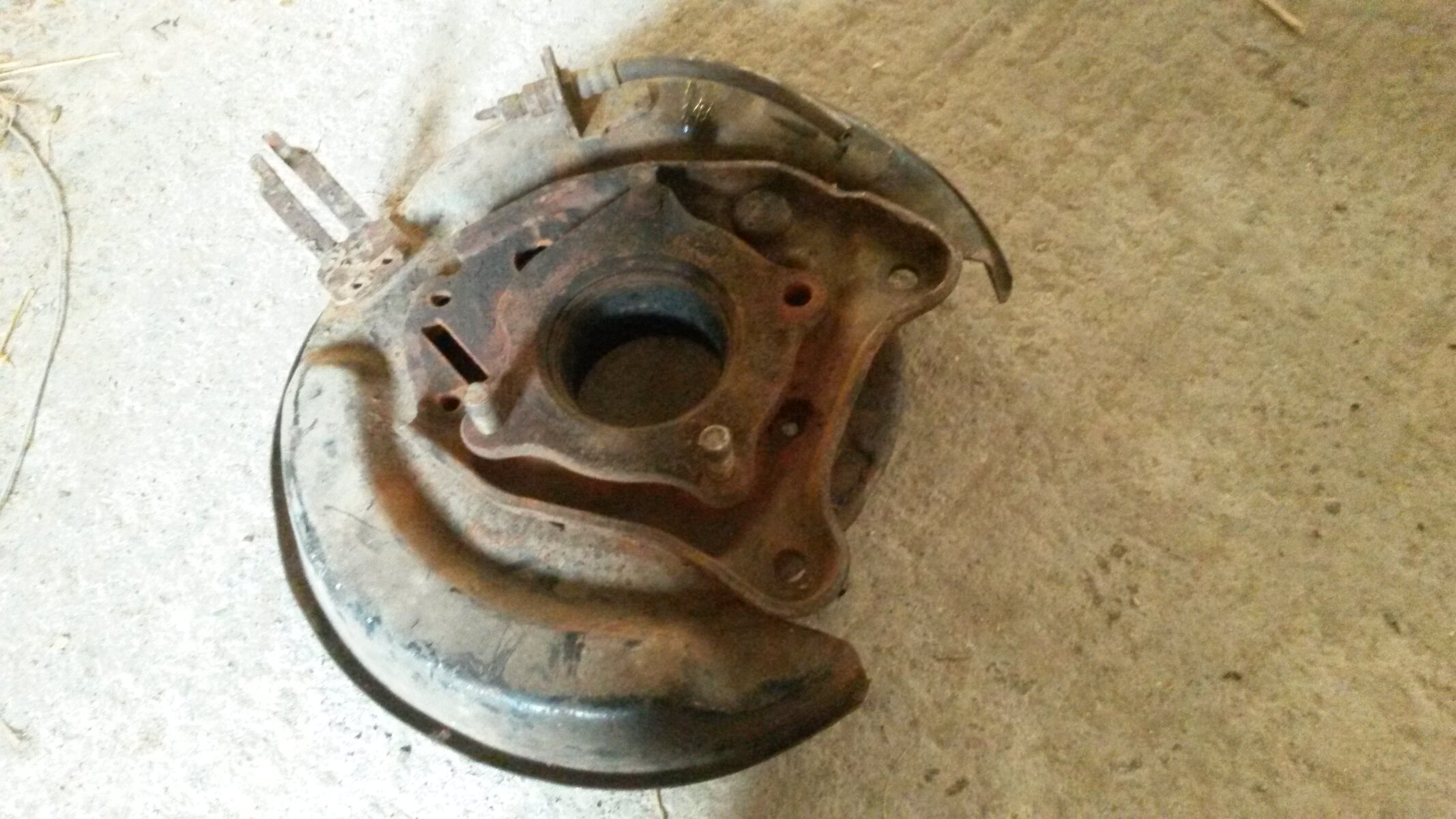

You can use the disc and caliper. . To leave out the inner hand brake setup.
But you need the carrier that has the wheel bearing and the caliper mount.
Like this... maybe someone will say its the same as a 90 series, which I suspect it is.
Good luck with it mate:thumbup:
