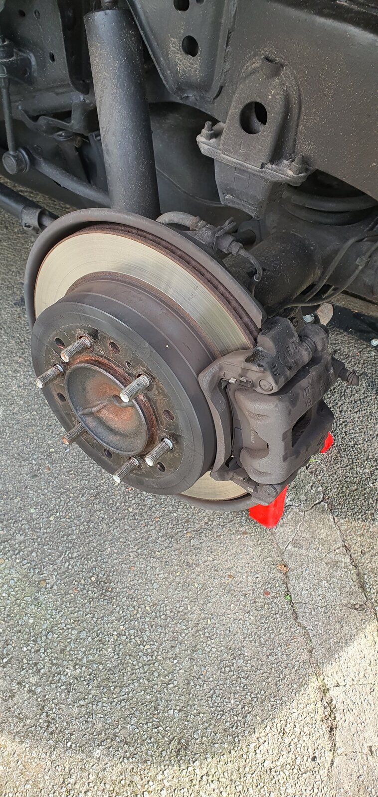

Ummm, I think the rears are sliders? ... But I havent had to do the brakes on mine yet, so you might well be right!
Questioning myself now Karl and happy to be wrong, if they are sliders then they need lubing and making sure there's nothing catching preventing them releasing fully when one releases the brake.
The Forester brakes are sliders all round, but could have sworn the 120 rears were opposed design.
Found a pic!

No not at all, I had to check as well ! Plus the front are opposed pistons arent they?
As you say then, slider pins number one suspect?
