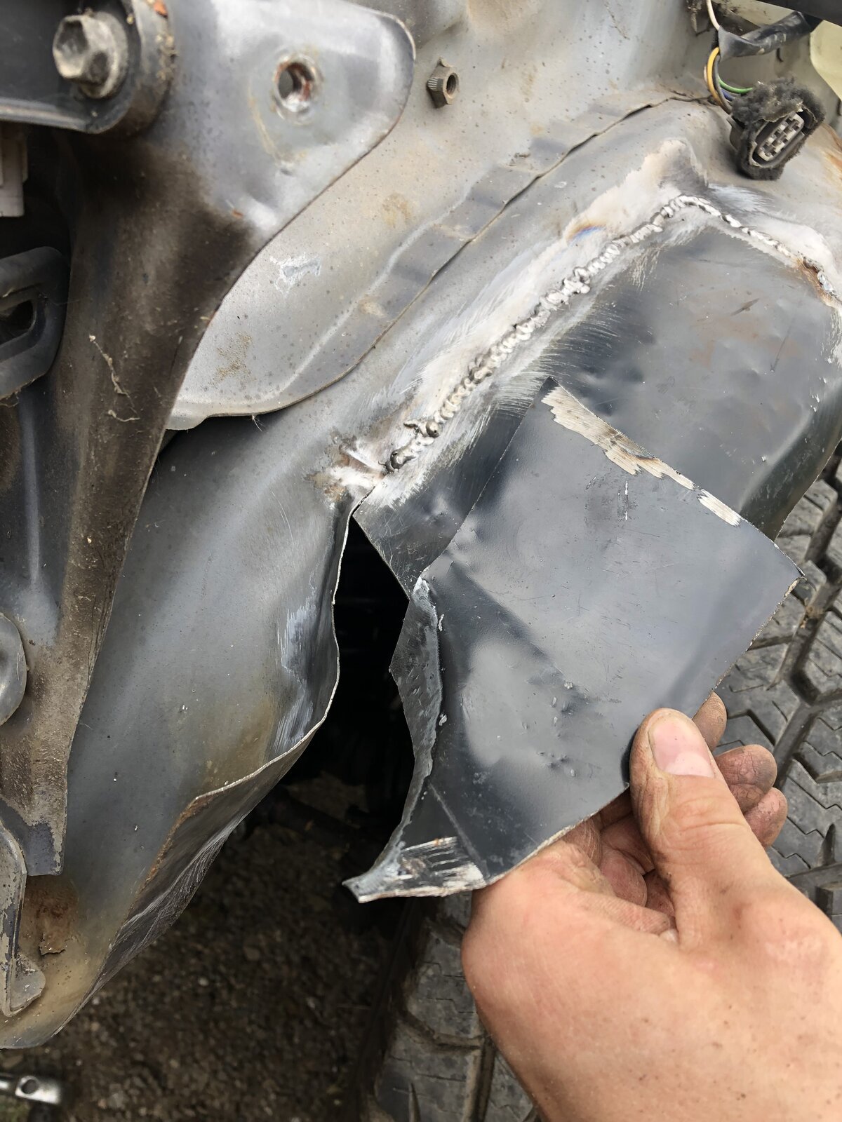

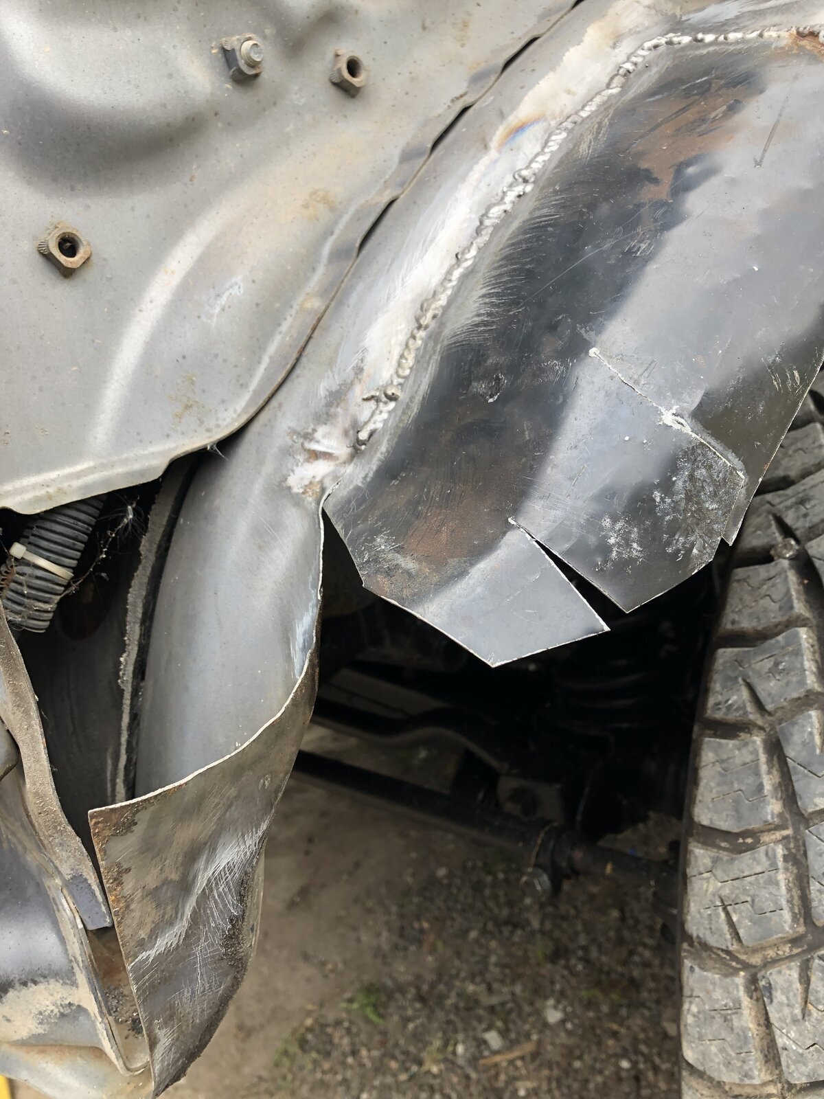

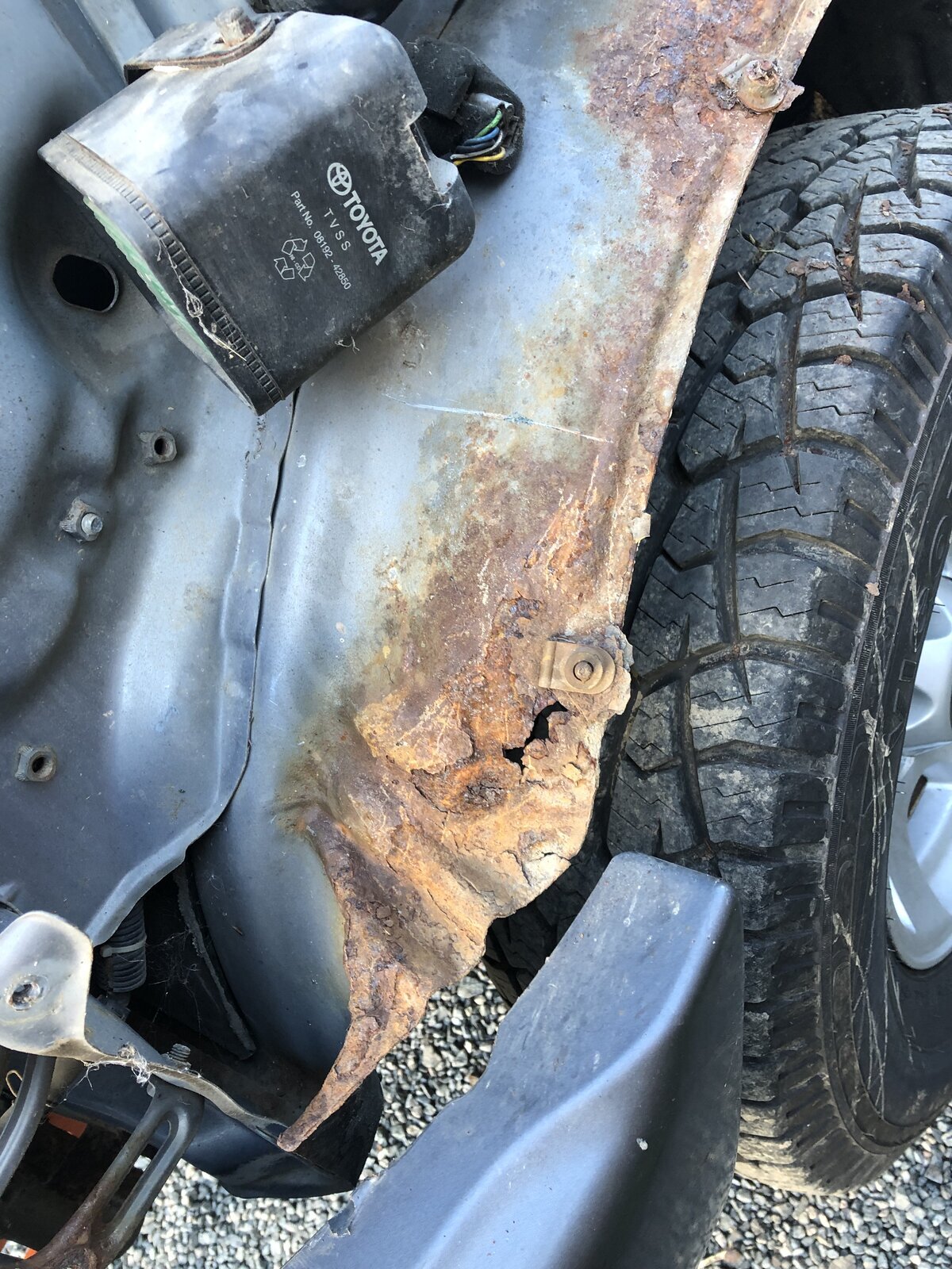

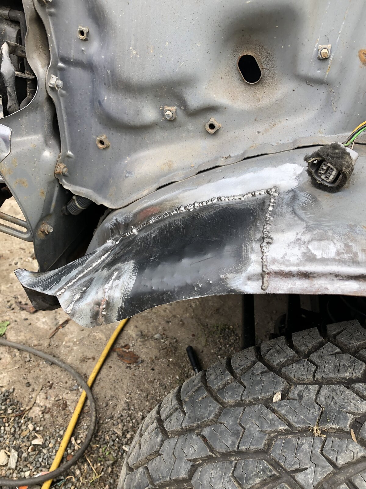

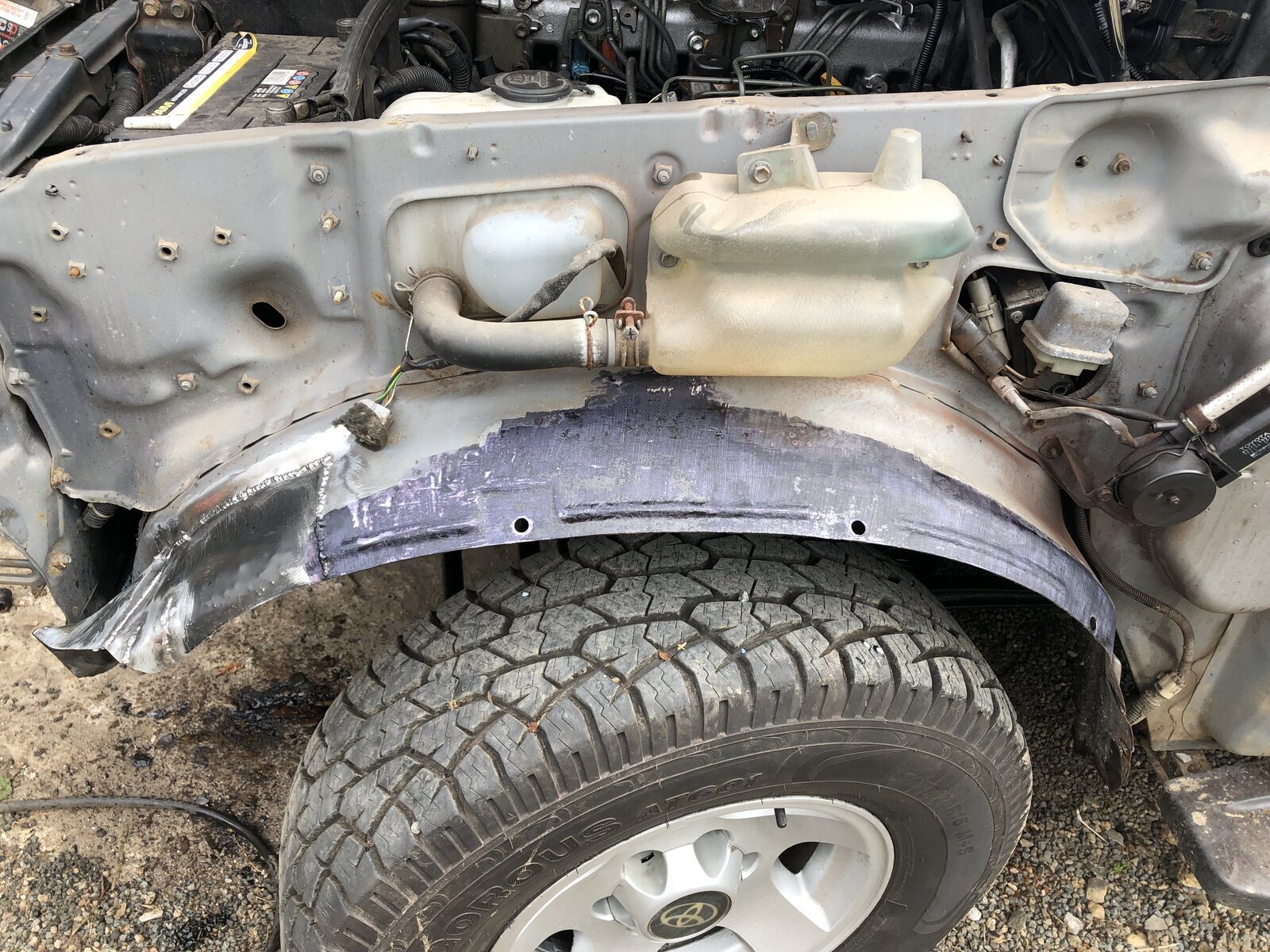

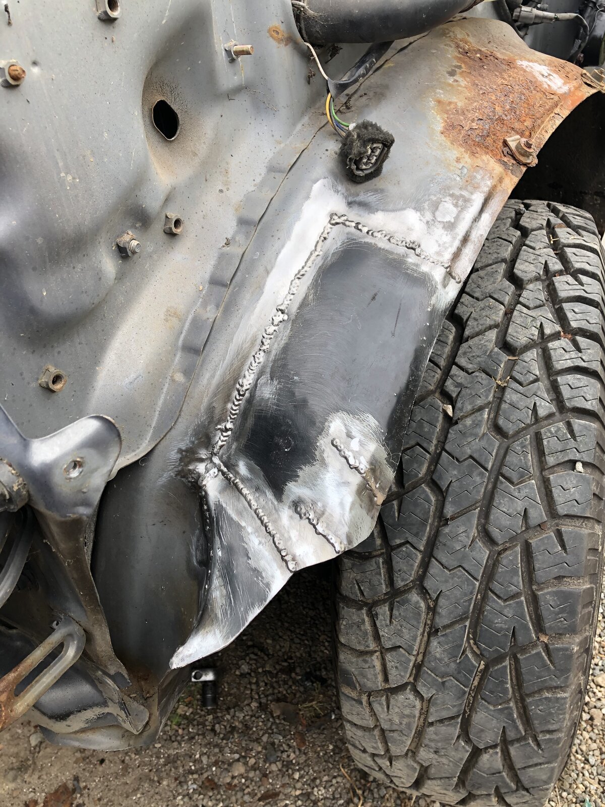

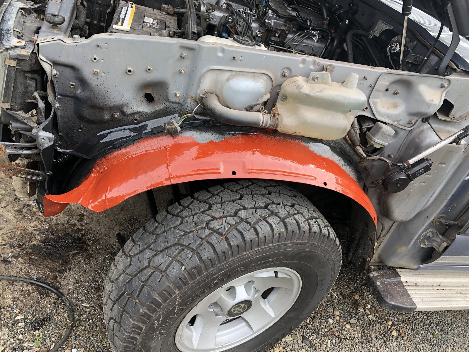

I had to put a small repair into the front of the inner wing. The rest got wire wheeled, rust converter, red oxide then black wax.
The bottom section needs replaced. I have a very clean one on the breaker I plan on unpicking the spot-welds then fabricating it, and mirroring it for the other side. Isn’t a complex shape and 9/10 they are rotten there where mud and shite collects.
