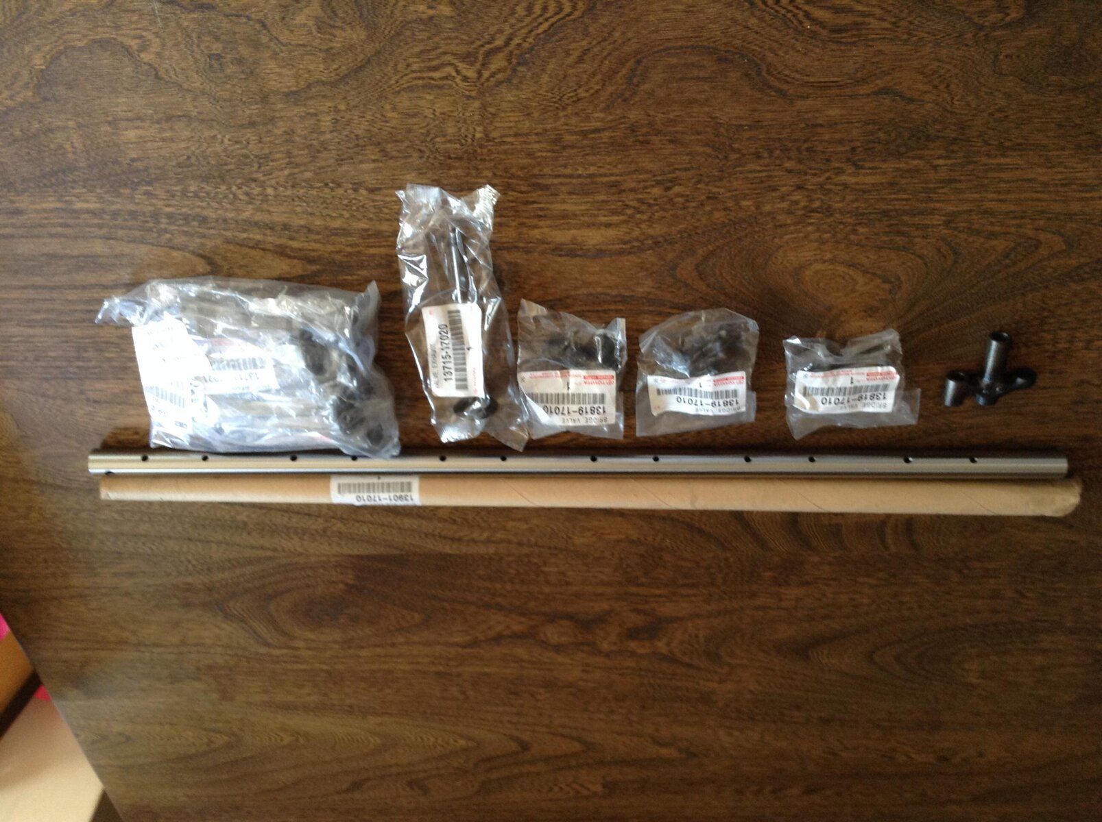

Rocker shaft, intake and exhaust valves, valve bridges and camshaft bearings just arrived from Japan. All genuine toyota parts. Thank you guys for the fair warning, hope I can prove you wrong. Long live our cruisers!

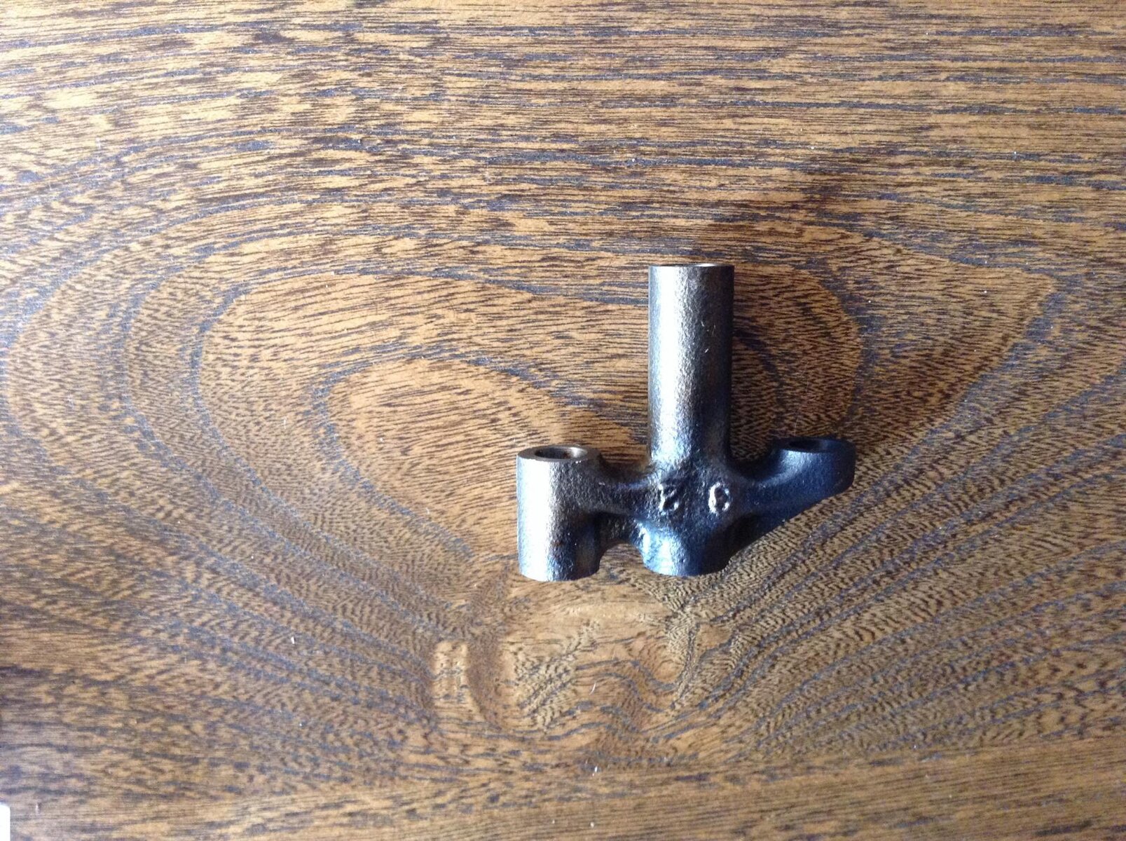

Here are the pics of the valve bridges,valve rocker shaft and valves. In a week or two you will know if they fit...
