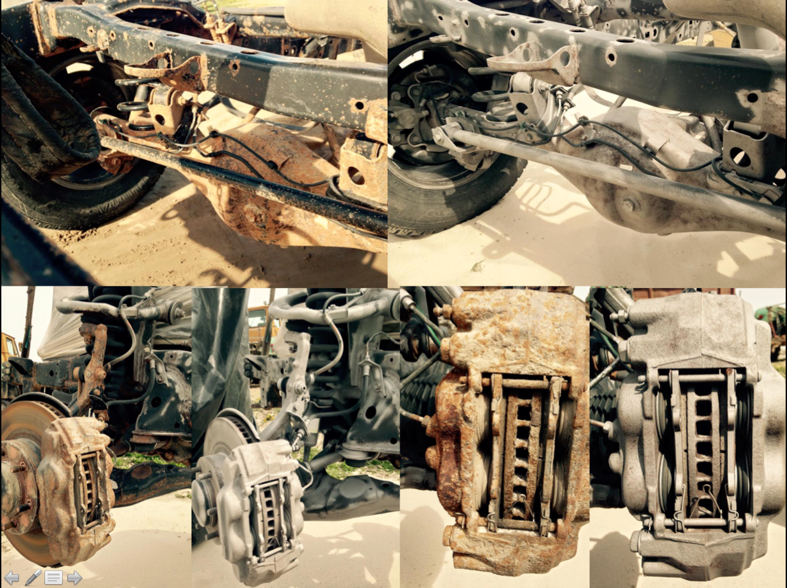

2007 Toyota Land cruiser, daily car all year round, one owner. In my country is winter and the roads are treated with salt, which enhances corrosion in wet weather.
Photos after car wash

Brake tubes also dead..

Everything need to be clean from rust and dusts.

Work with rust transformer

Painted with acidic reaction primer STANDOX

A real big job Rarf , looks like you caught it just in time and are having it repaired thoroughly and professionally , job well done ..cheers Mick
Thank you, Mick. that's not all, later would add new photos
I've got a 95 series if you find you enjoy it so much :whistle: done a dam good job so far buddy
A mighty brave job there Rarf, looking really good. I would love the courage and time to do my 80 like that! :clap:
Wow ......... when can you do my truck and how much !?!
Dang - that is some treatment.
There was a Dutch chap a while back, Tobi, who did the same to his 80 but had the chassis galvanised to laughs.
