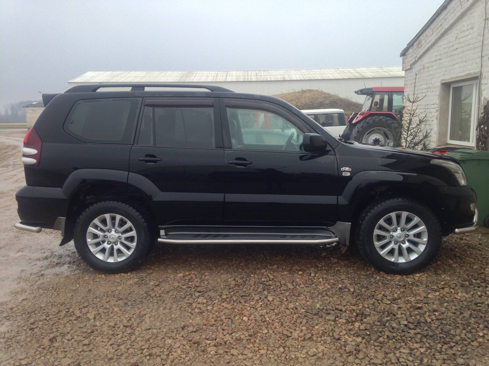

Hi!
Here you can view photos from the anti-rust first project
2007 Toyota Land cruiser, daily car all year round, one owner. In my country is winter and the roads are treated with salt, which enhances corrosion in wet weather.
Photos after car wash
