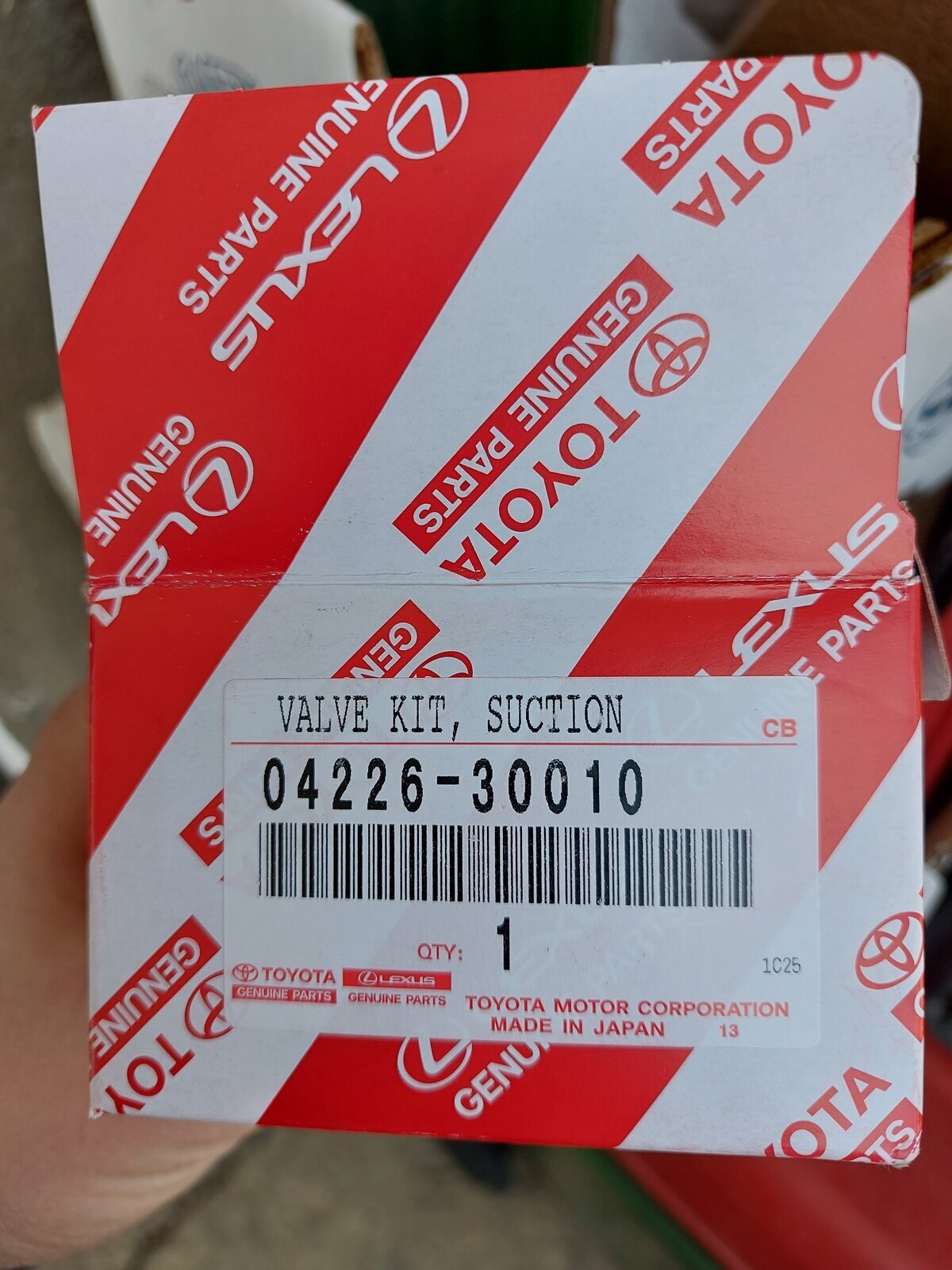

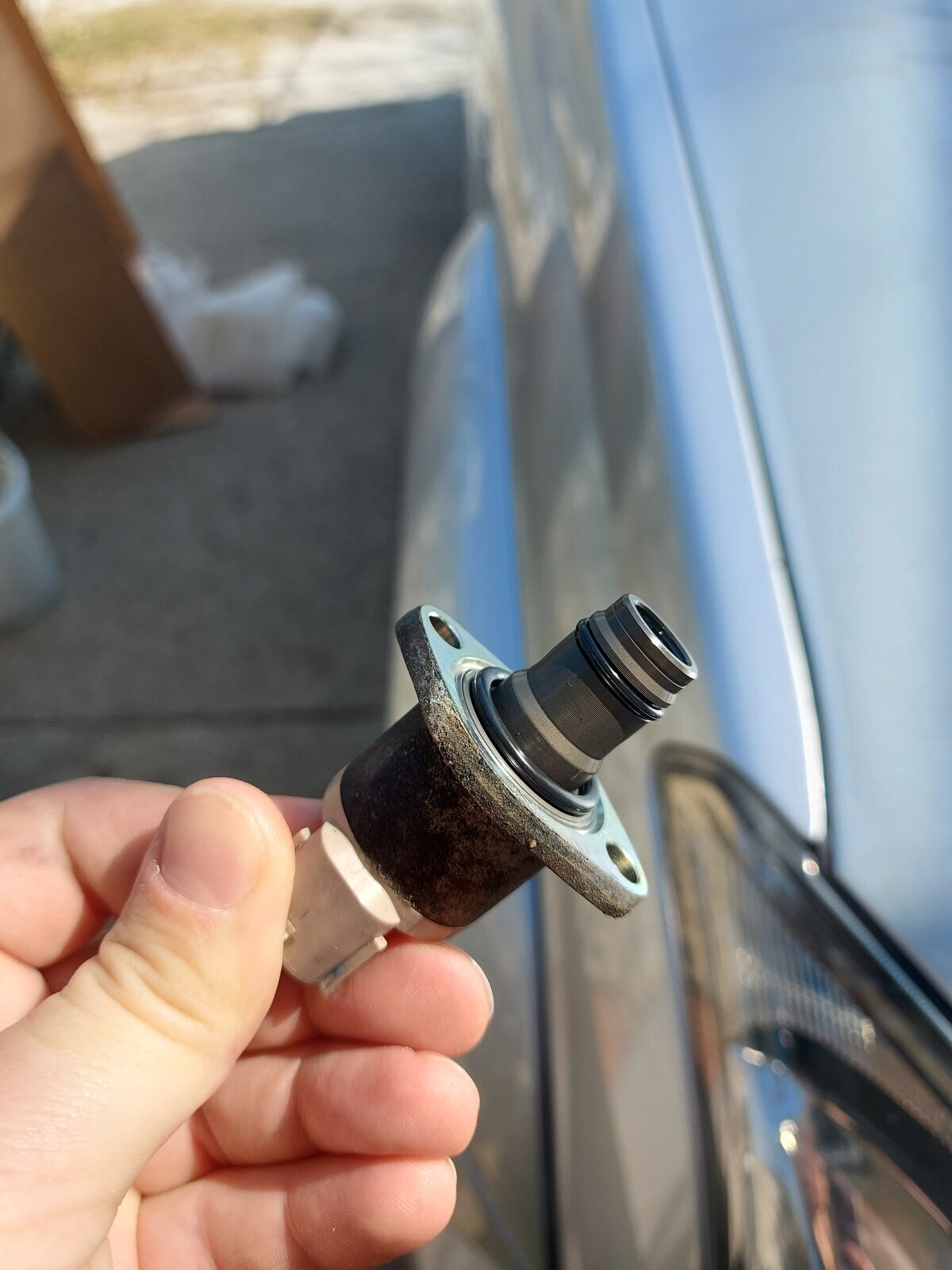

Short one out,long one in... had some problems with falling a hex bit down under.
But job is done!
