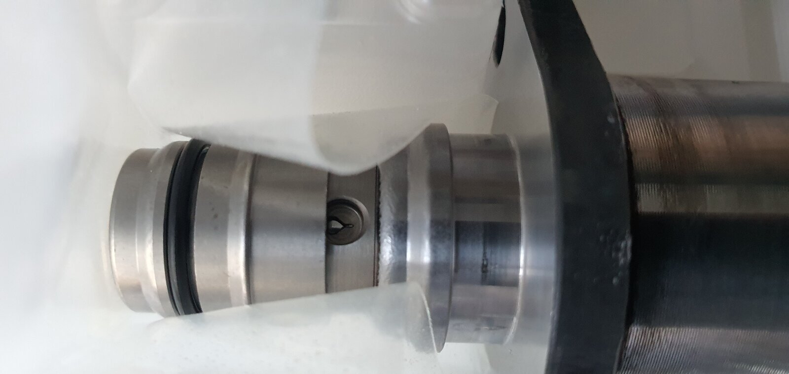

Well that was interesting. I replaced the SCV, and it's now worse. Just sitting there idling it now this a P1229 and occasionally a P0088 error code. I'll need to contact PF Jones and confirm they have sent me the correct one. I'm so irritated I just packed it all away. Will put the old one back in tomorrow.

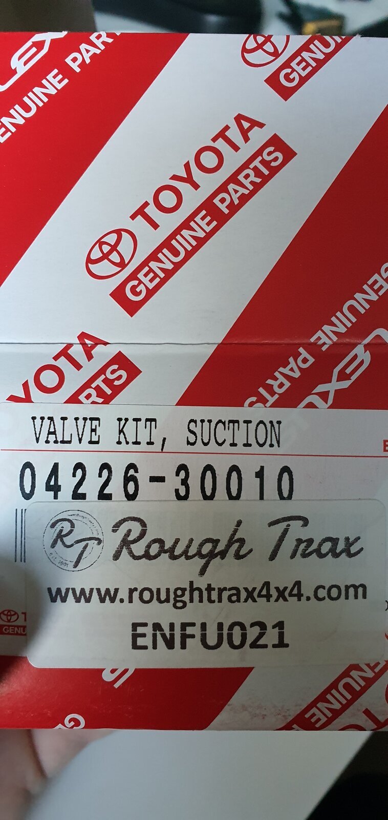

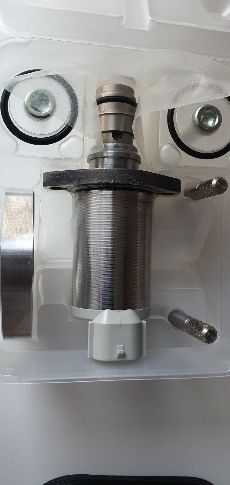

Just FYI, here's the one I got from RoughTrax and haven't fitted yet.

The part looks the same but it is not OEM, so came in a brown box. Was half the price, but it should still work, just perhaps longevity being questioned.

Tony I have looked at the part number on mine and it is 04226-0L010 and is for the euro 4 spec , it differs from your scv in your pic by mine having a top cover on the valve like the one Ants on his video in which he clipped on , but mine is already clipped on like Karl has shown in his pic , you need to find out if the part you need is right for your 120 for example is your 120 euro 3 or euro 4 spec as that will make a big difference and hence the P codes .
Good spot Tony, the part number supplied is 04226-0L020, so different to yours. How do I know if my 120 is euro 3 or 4. I did send them my reg and asked which is the correct part and they said the one I got. Hmm
Tony the pic of your scv has a different valve head to that of the pic on PFJones online pic with a spacer , the one you have in your pic is missing the cover that fits over the valve for the 120 models . looks like PFJones could have sent you the wrong scv due to you needing Euro 3 or needing Euro 4 or the scv is missing the valve head cover that fits the 120 , if you can find out what euro spec your 120 is it will help when talking to PFJones ,

Just checked and they sent me the euro 4 version. I told them I needed the part to match 04226-30010, which is the same as Karl's one, so they gave me the wrong one to order. I'll call them on Monday and get the correct one sent. Will be interesting to see if they will give me a refund for this one seeing as I have used it....

I think all Tony needs for the scv that he has to work properly is the metal cover that 120s need so that to convert to the longer replacement scv .
