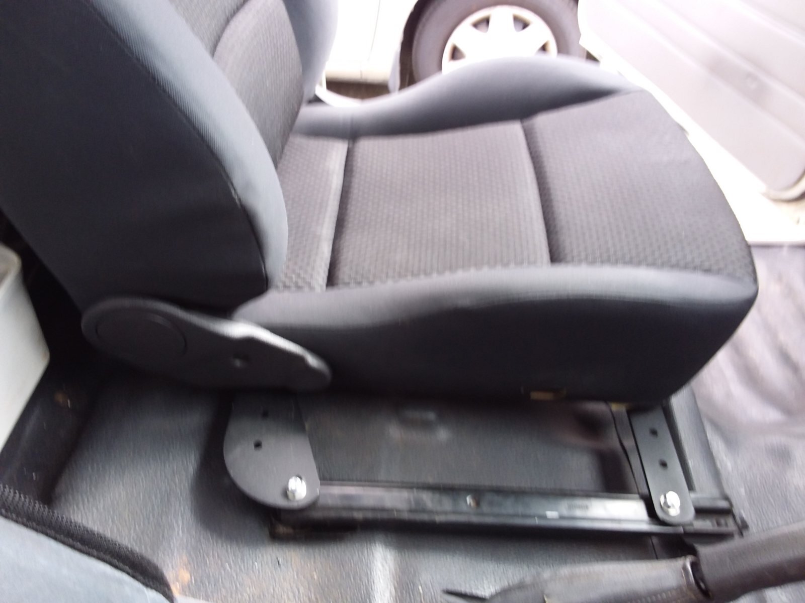

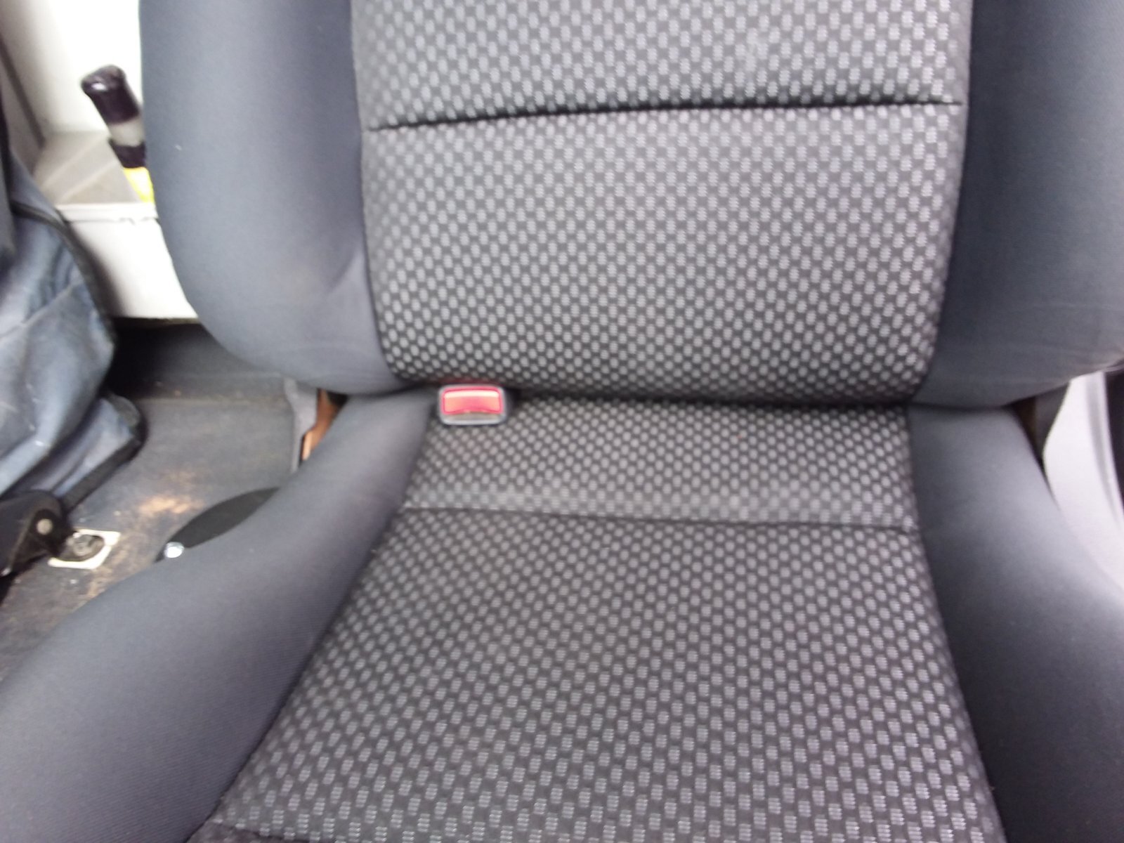

Had a look at the Huracan seat conversion for my 79 series.
Didn't like the passenger side because it left the rail behind and the seat belt arrangement was IMO dangerous.
Looking to add a bolting point for a seat belt in a better location
Reflection of the drivers side would be ideal
Has to be engineer certified for road worthy
Has anyone done this?
Who did it if you didn't do it yourself?
Thanks in advance
Pics of the Huracan bench seat adaptors...

Thanks mate I appreciate the info I think I’m just going to use the 3/4 adaptor from hurricane and put fridge on top to cover the bracket and try get the engineer certificate for it was wondering what the cert cost you mate?
Engineers report and roadworthy was about $500.

Seat belt has to pass around the seat, not through it.
Has a cheese wire action in a crash but check with your engineer.

Is the first post you made with the 3/4 seat adapter and the seat belt passing through the seat how yours ended up with the hurracane adapters or could it pass around the seat? Yeh it doesnt seem to safe to me id like to be able to match the driver side and I’m in vic mate cheers for that though
Yes first post is with the adaptors.
You still need an engineer report.

Yes I know mate my question is if the way you have the seat belt clicker running through the seat the only way it would go or will it reach wrapping around the seat? And I know still need engineer report mate cherrs
Ye
On mine the only way was through the seat.
Did you end up getting a hard stalk seat belt clicker for the passenger side? I thought the middle clicker would fit but it Doesn’t cheers
Yes but I also moved the seatbbelt bolt hole
I will try and find you a part number when I get home
