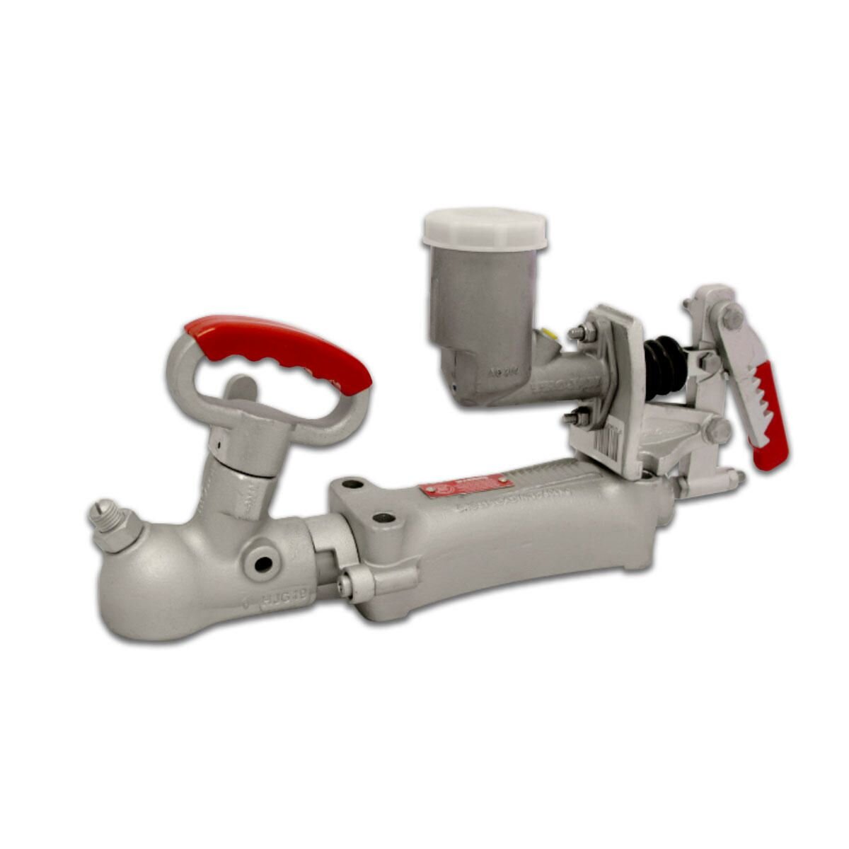

2500kg and under Trojan gear is great (everyone has parts) the hitch with the handle to switch ball size. It's hard to find the one with locking hole through it but It is a must! So easy to lock onto the car
