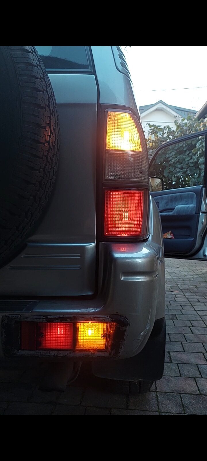

Yes, I have indicators up there too.. you'll need either an amber bulb, or correct colour LED (which I have) as the lenses are clear. Otherwise its very simple. The wiring is all there. Proper bulb holders and you're set
I've noticed I don't have the wire for indicators in upper lights. I've 5 wires: brake light (green/white), reverse, fog, tail, ground. There is no indicator wire, it's supposed to be green/yellow.
Now that I think, I had to run one wire across from the jack side.. the connector block in there has both indicator wires. It's meant for a trailer wiring kit. I ran the wire across.

Perfect. I was also thinking of running wires from jack compartment. I might do it, was it easy enough?
Yeah, I just ran it under the carpet
I did the lights today, very satisfied. I used an amber bulb for the indicators because I have a clear upper glass.

Excellent work. The 90 series just looks right with this done imo...
