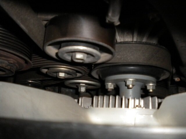

I finally got around to doing the aux belt today and loosened the tensioner bolt expecting the belt tension to drop - but it didn't. A quick question therefore is am I on the right bolt? It's the one at the bottom to the left of the fan in the photo (3 or 4 turns loosened) and it corresponds to the diagram under the bonnet. What am I missing?
John
It doesn't loosen. You have to keep it pulled to take the load off the spring and with your 3rd hand you swap out the belt. Seriously it's easier than it sounds. Get the new one all in place and just slip it over the tensioner last as you slacken it. If you're sure you have the right replacement just cut the old one off.
Sent from my Galaxy Note
Exactement. It will only move about what's indicated as access is a bit limited. In fact, even using an extension piece can have so much play as to use up all your room. Best using a 750mm bar if you can or longer.
I have a very long snap-on breaker bar which I used to undo the centre bolt. It'll do the job. Thanks for the help
