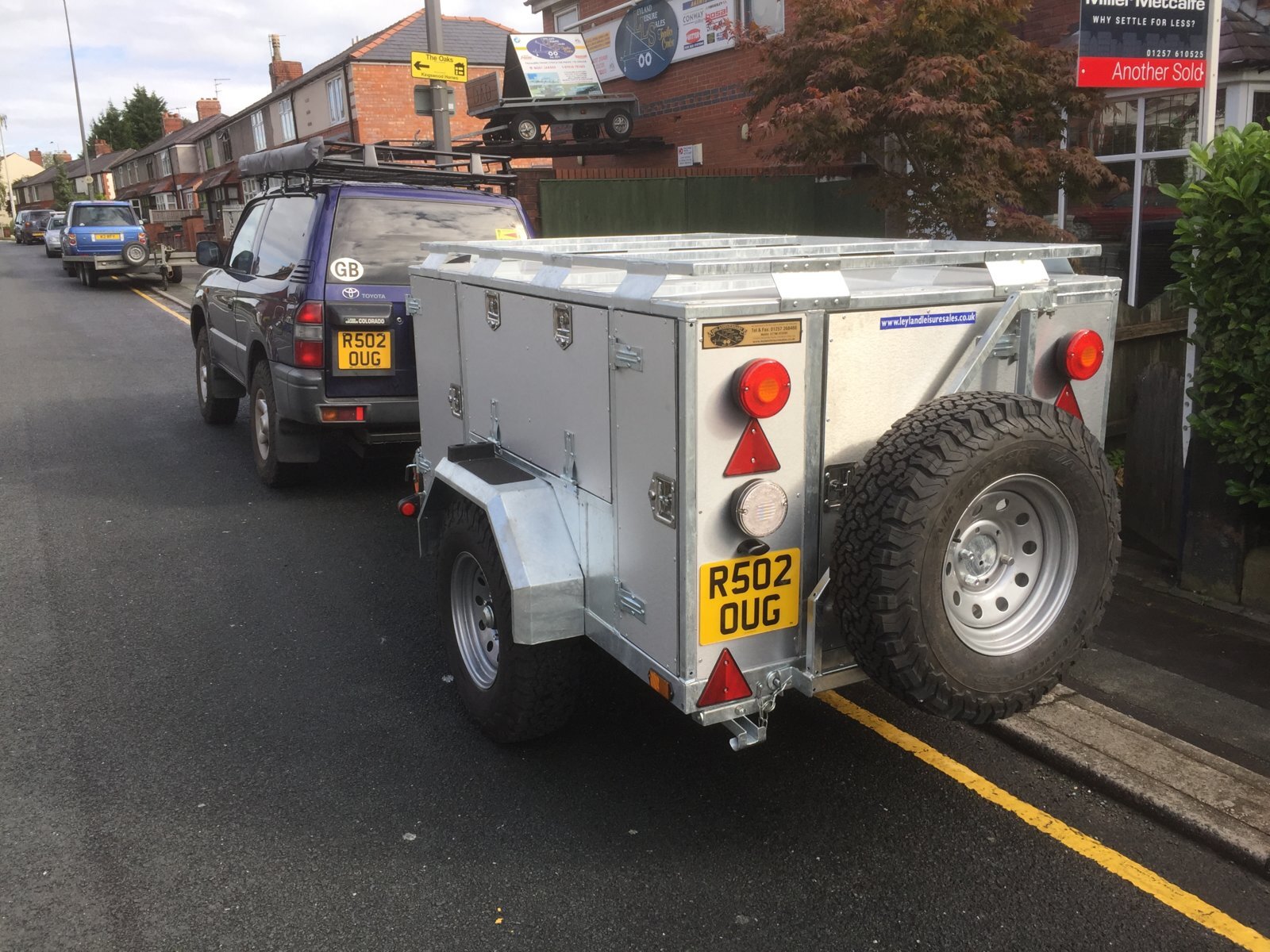

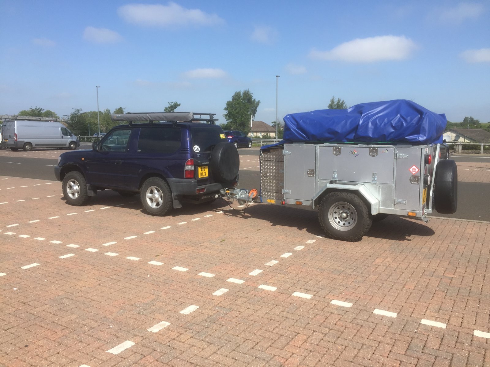

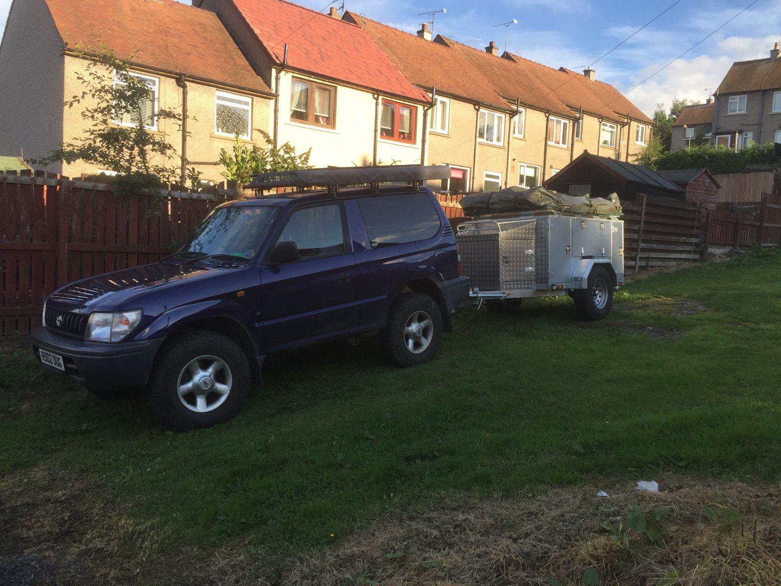

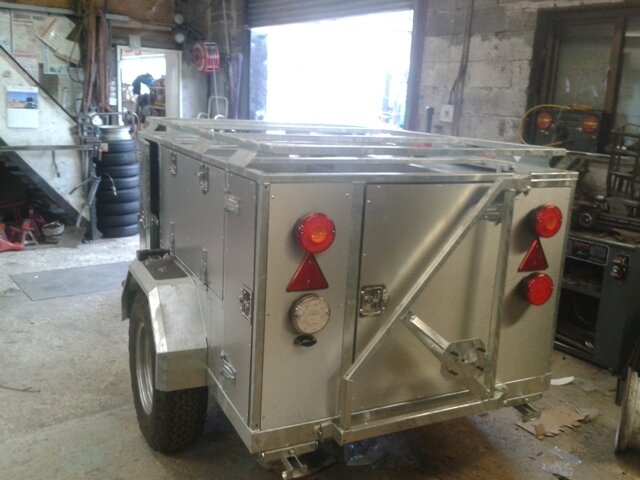

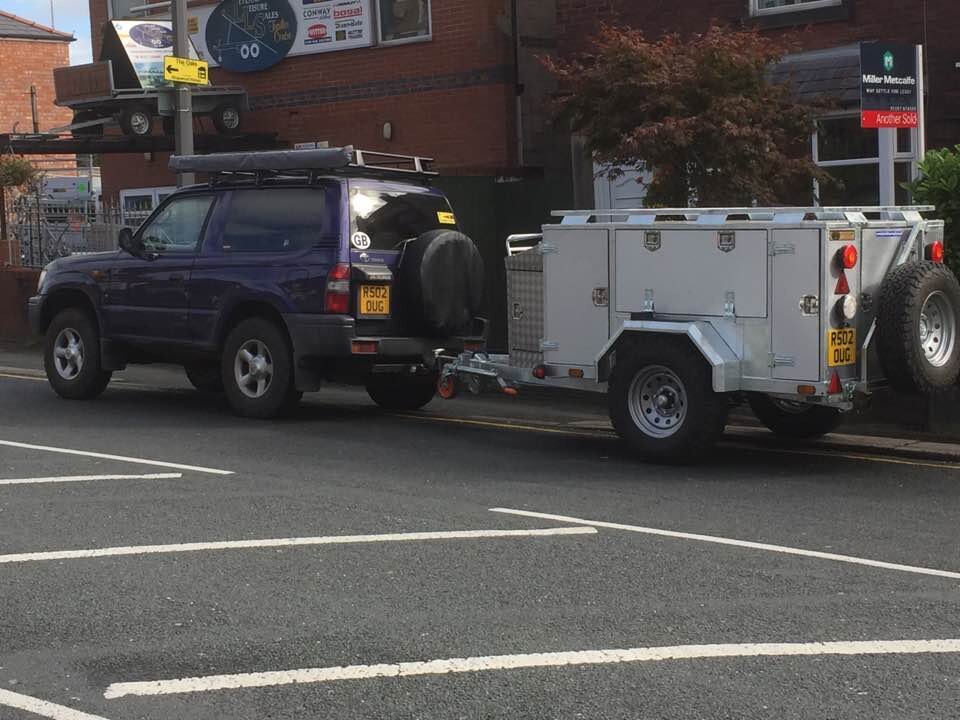

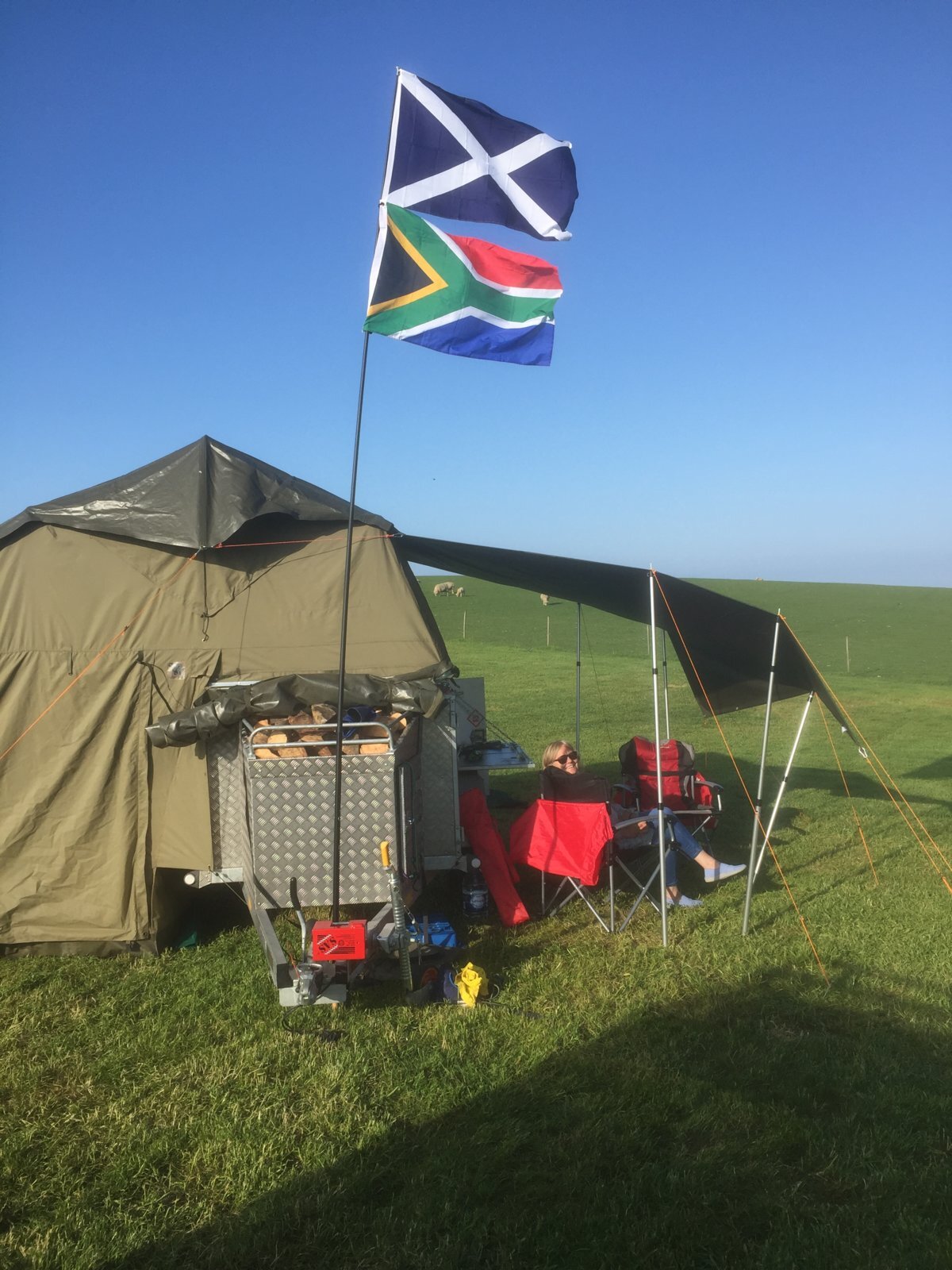

Guys, I came across this thread by accident but I have specced my own off road trailer and it's based on SA trailers as I see plenty when over there. I found only 3 companies that would build me a bespoke one and only 1 bothered to reply so they got the job.
Basically I provided Land Cruiser PCD wheels with tyres, asked for it to be galvanised, leaf springs, LED lights, swing up jockey wheel etc etc and off road capable (I hope) and drew the drawings myself on A4 paper and the photos are what I've ended up with. It's fully IVA approved, plated and road legal.
Our intention is to drive it to Cape Town starting mid 2019 when we retire.
1st time hitched up.jpg IMG_4369.JPG IMG_4390.JPG IMG_4391.JPG Trailer 44.jpg IMG_5452.JPG IMG_5454.JPG IMG_5461.JPG
That looks impressive KJM. First class job by the looks of it. :thumbup:

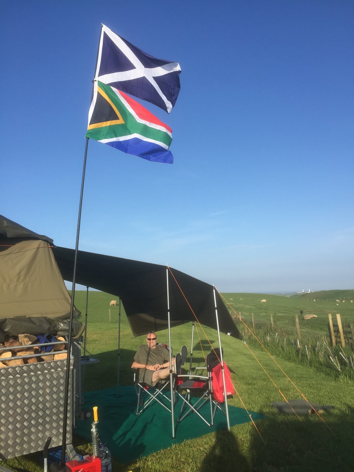

Excellent trailer KJM. No shortage of firewood on there. Where’s the tent from?
Very much so, it was done by Leyland Leisure at Chorley and I cannot recommend Ben and his team highly enough. He kept in touch throughout and sent me pictures on a regular basis of the build. I could post them all here but there must be 40+
Hi Jacob, yes plenty of wood, that's what I designed it for but I need to watch the tongue weight - it's a touch sensitive on that but given I designed it I only have myself to blame :-) I tend to think if something looks right, it generally is right hence my axle position could maybe have been better. Basically I centred it on the main body.
The tent is a Conqueror from South Africa but I bought 2nd hand. The trailer was built around a height of 1.55m to get the tent to open at the right height.
I’m not an expert on this but I think if you go to Media Gallery you’ll be able to upload all the build photos. I for one would love to see them.
Have a look at West Counrty Trailers in Swindon they were at the OL show towing a nice looking one behind a Honda Civic my trailer is ex US M416 with up rated 1.8 t axle new longer drawbar with an Indespension towing eye Toyota 5 stud hubs 265 75 16 cooper tyres big alley mud guards and a alley fold down top which has got an air tight seal think you might have seen it at last years show the conversion work was done by Bridgewater Trailers if you look locally you should be able to take you thoughts and design to them good luck Russ with your hunt
