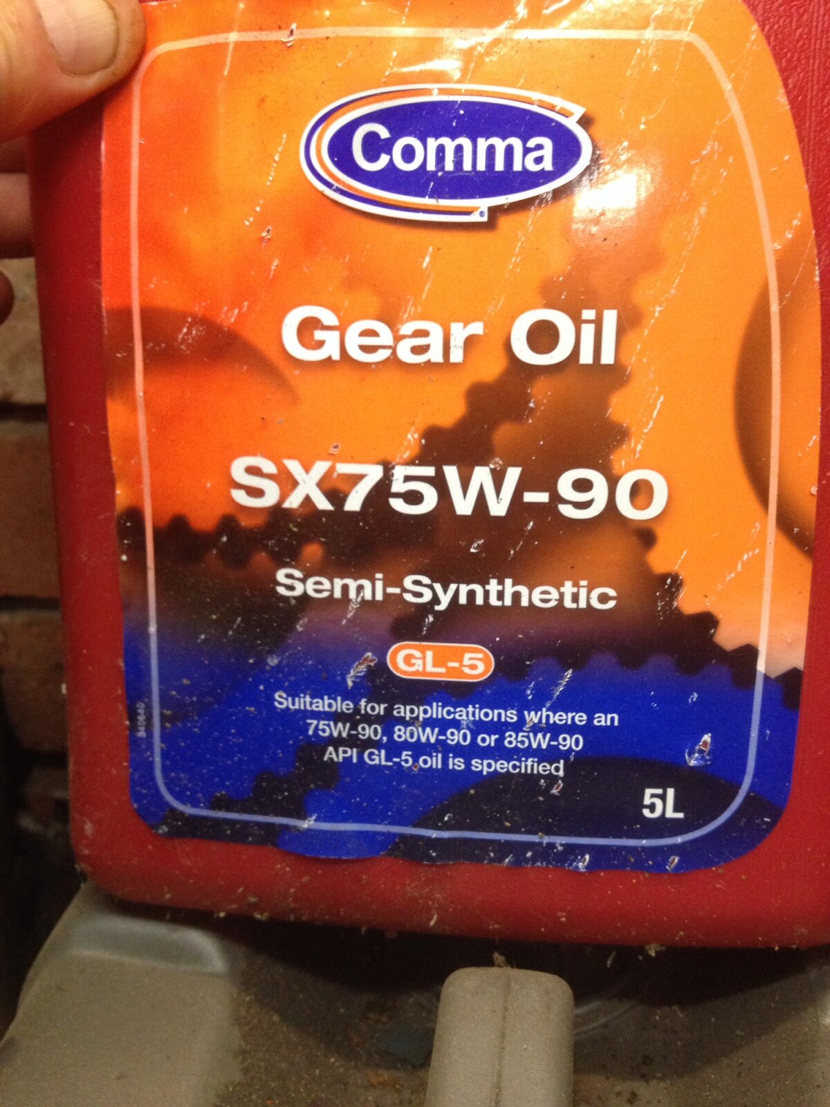

This is what I got for mine
Andy
Variations of oil by members for use in the transfer case so I went ahead and put mine in, feels just fine, good thing about older cars you can more or less get away with slight variations of oil compared to the high spec cars of today where the wrong grade in the engine could screw up the turbo etc.
