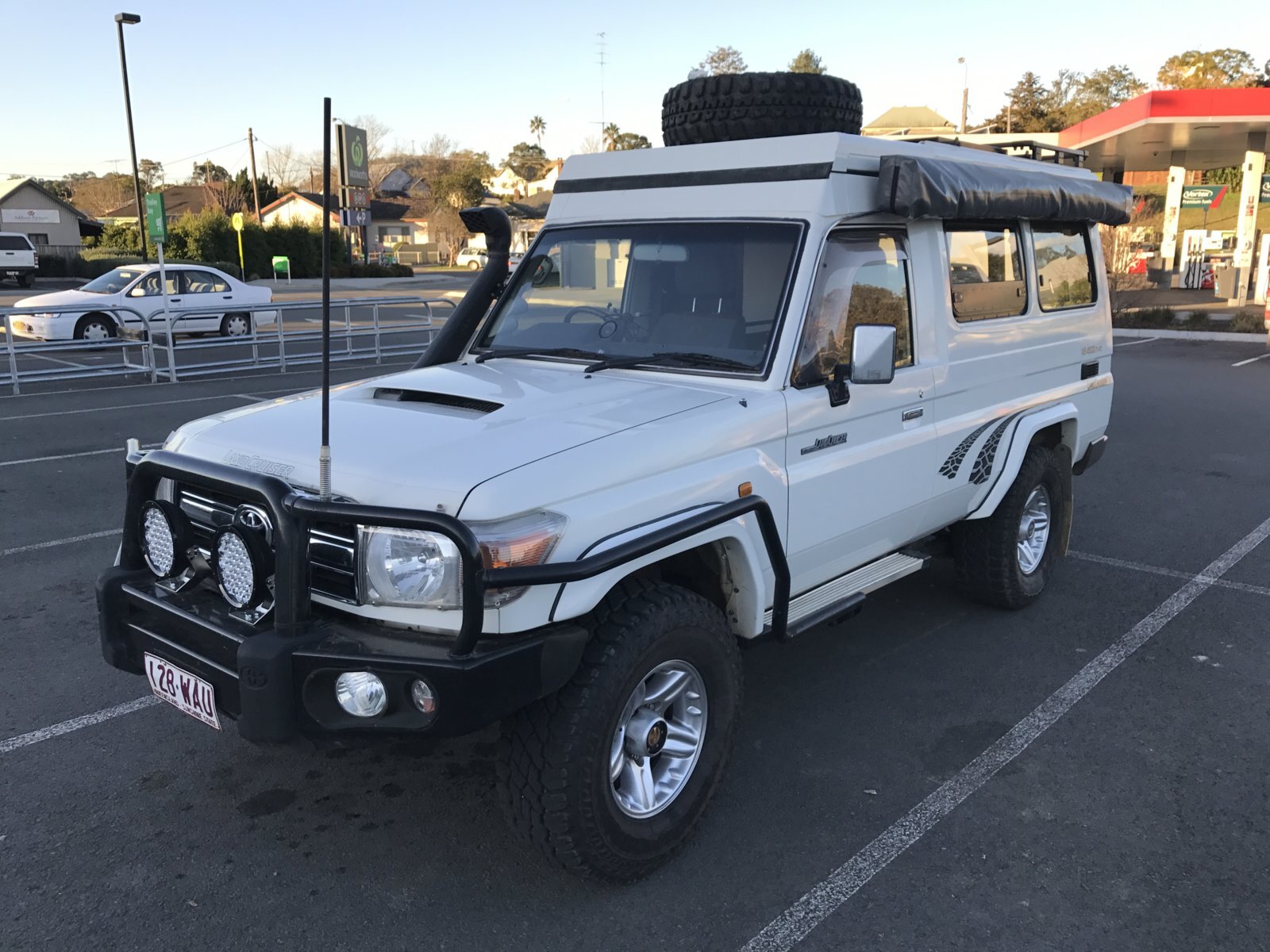

Charlie is that a high lift jack you have mounted on the right hand side and if so has it been mounted to the base of the pop top ?
It’s a shower curtain (mounted on the base of the pop-top), it folds out in seconds.

Yeah its nice to be able to have a shower while out in the bush, this system works well.

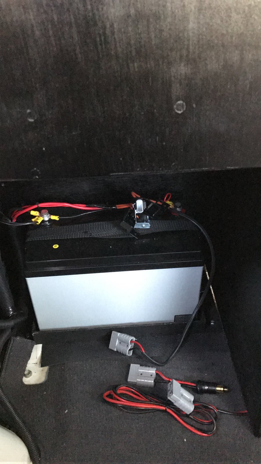

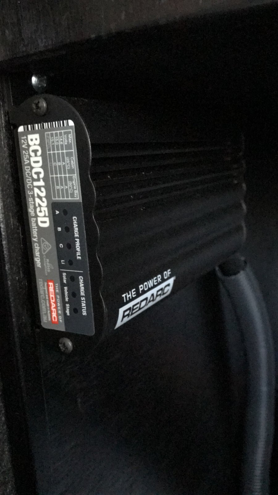

Forgive me donning my electrician's hat for a minute but I couldn't see any fuses close to the battery there. If it's the case that there's none directly connected at the battery then It is essential to get some fitted sized correctly to protect both the larger and smaller cables. Toyota fit fusible links for this purpose to the main batteries. It's also a good idea to cover both battery terminals with insulating covers. If it's in a protected compartment it's not so necessary but they are so cheap it's worth doing anyway.
Hope you didn't mind me saying.
