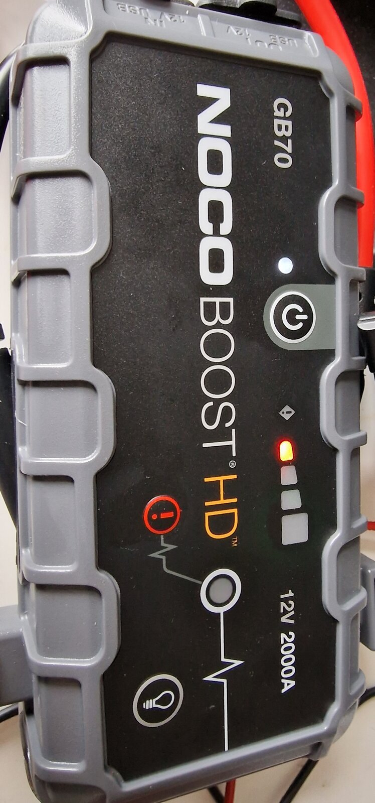

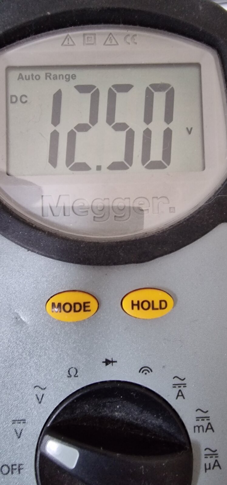

Where are you getting the 11.2v from? Just tested a gb70 I've got handy, and got 12.5v out of it...
