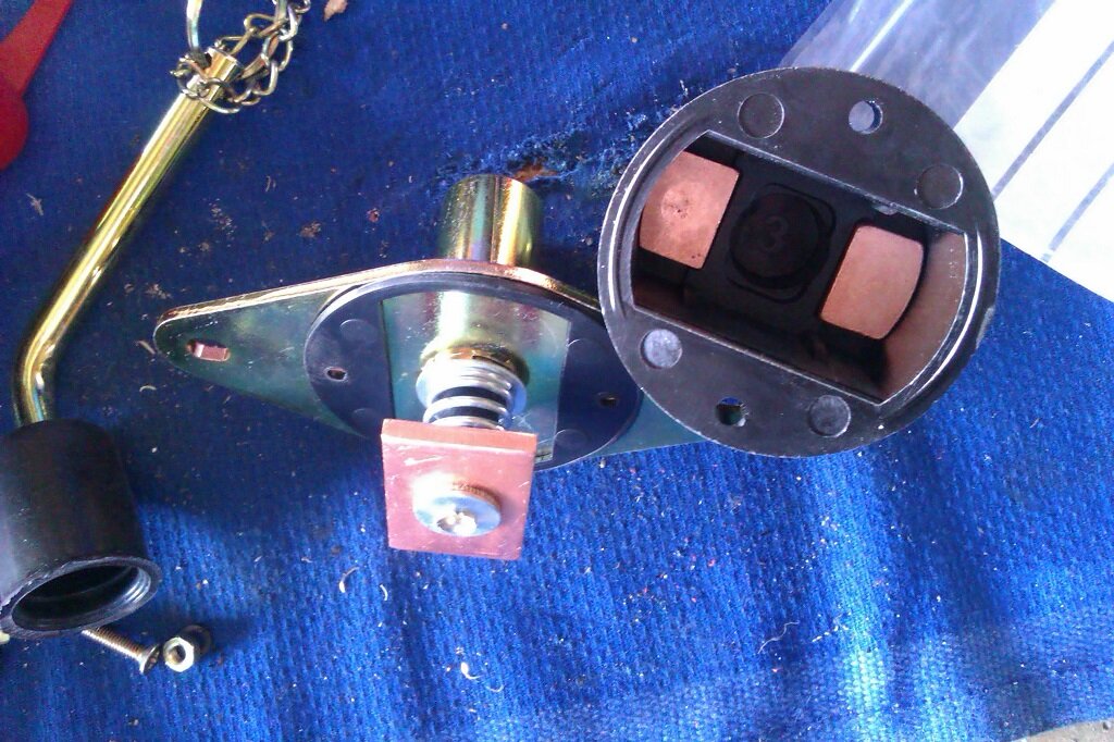

Seems pretty decent materials / construction. Looks like a Durite 0-605-50, same spec, but isn't.

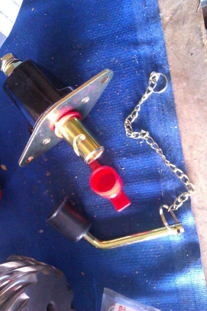

That one's for the winch I may get another for manually linking batteries when winching. They are big btw, the main body is 63mm diameter and then there's the overhang of the top plate. There is spare material on the top plate so there's room for new holes and shortening the plate a bit.

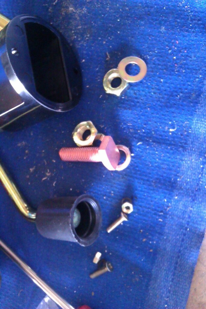

There's a rubber seal between the main body and the top plate but the bolts in the bottom are not sealed so I put a bit of silicone round them before putting them back in. The plunger in the middle of the top plate relies on the boot on the key or the supplied red cap to cover that up and seal it. Easy enough to take apart and check all is well from time to time though which is good.
VWP Heavy duty battery isolato
Jon I have one of those and was going to post on it after taking it to bits but of course I should have known you'd have delved in there already. I was impressed at the bridge and contacts
Properly thick copper and made well so that you can dog the connections up nice and tight.
Proper thing.
