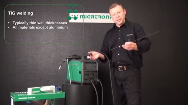

From the reading I have done it would seem transformer welders have less to go wrong, are bigger in form and heavier but in principle last longer than inverter welders which are smaller, lighter. You can get a mig welder that does Tig and Arc if you want but not sure if its a case of jack of all and master of none or if they do Mig better than they Tig or Arc like this http://www.migatronic.com/product finder/machines/process/mig-mag/rallymig for about £700 ~(not sure of brand/spares/service/support and am sure there are others out there)

thats does look like a nice welder warren.
my main reason for wanting a tig welder is for nice welds on aluminium BUT you need a tig that is ac/dc which this one doesnt state that it will do you you might be limited in only doing steel and stainless with it which you can do both with a mig which is alot easier and faster maybe not so neat but with practice you will get it.

sorry warren i cant watch youtube stuff on my work computer. you could do the ali with the mig side of the welder like any other mig but its very hard. not that its easy with tig but you get alot better finish with tig and more control.

Looks like a nice welder and yes I think aluminium is MIG only on that. For what you've said I would pick a welder based on how good it is for MIG and treat anything else as a bonus you'll probably never use anyway ... Unless it's an ambition to weld aluminium like a pro I'd leave the odd aluminium job to them and be happy gluing bits of steel together with MIG which makes all sorts of projects possible :icon-cool:

Deff won't do ally TIG. It clearly says so.

I'm not convinced about that one in the vid. Fine for fixing bits and bobs. But doesn't come with a Euro torch and I wonder what spares it uses. I'd want to know a heck of a lot more. Personally, I'd buy one from a welding supplier too, locally. If not then I'd go for a branded one that is well supported.
