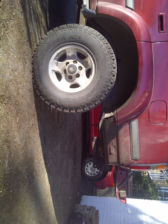

OK, so I've been running with the 868s on the rear for over a month now with hardly any load, and delighted to report that they are a delight. Some folks find them a little harsh with no load, but I hven't found any problems at all, and they provide a great lift. I'm really glad that I didn't compromise by fitting the 864s. HDJ80 with OME 868 springs.jpg
sounds like they should be spot on when you pack it for a trip :icon-cool:
