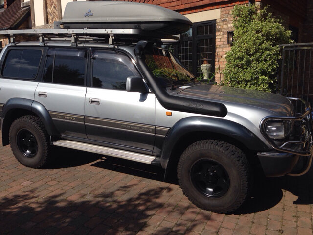

Sorry to see that the 80 has given you a bit of grief Chris. You are right in what you have stated above I did the axle rebuild with Overland Cruisers back in late 2009 IIRC, at the same time the BEBs where swapped out. All genuine parts were used except for the CVs, these I think were Blue Point.This was Scott's old truck Clive and well maintained. The axle rebuild was done properly by Overland and IIRC Scott together. Genuine seals were used. I am sure of that. They aren't genuine CVs but neither are they HDK. I am just not sure that doing the marr-tacking mod is necessarily good for long term wear, especially if there are grooves to start with. The shaft can't move as much and it could be the case that the lip of the seal gets dragged into an old groove accelerating wear. We'll never know. I mixed up some liquid metal, put the shaft in the lathe on 70 rpm and pushed the compound into the grooves. Before it set, I scraped off the excess. Then with fine cloth polished off the smears. It's like a new one. Ready for the Speediseal to slide over without leaving bumps in it.
