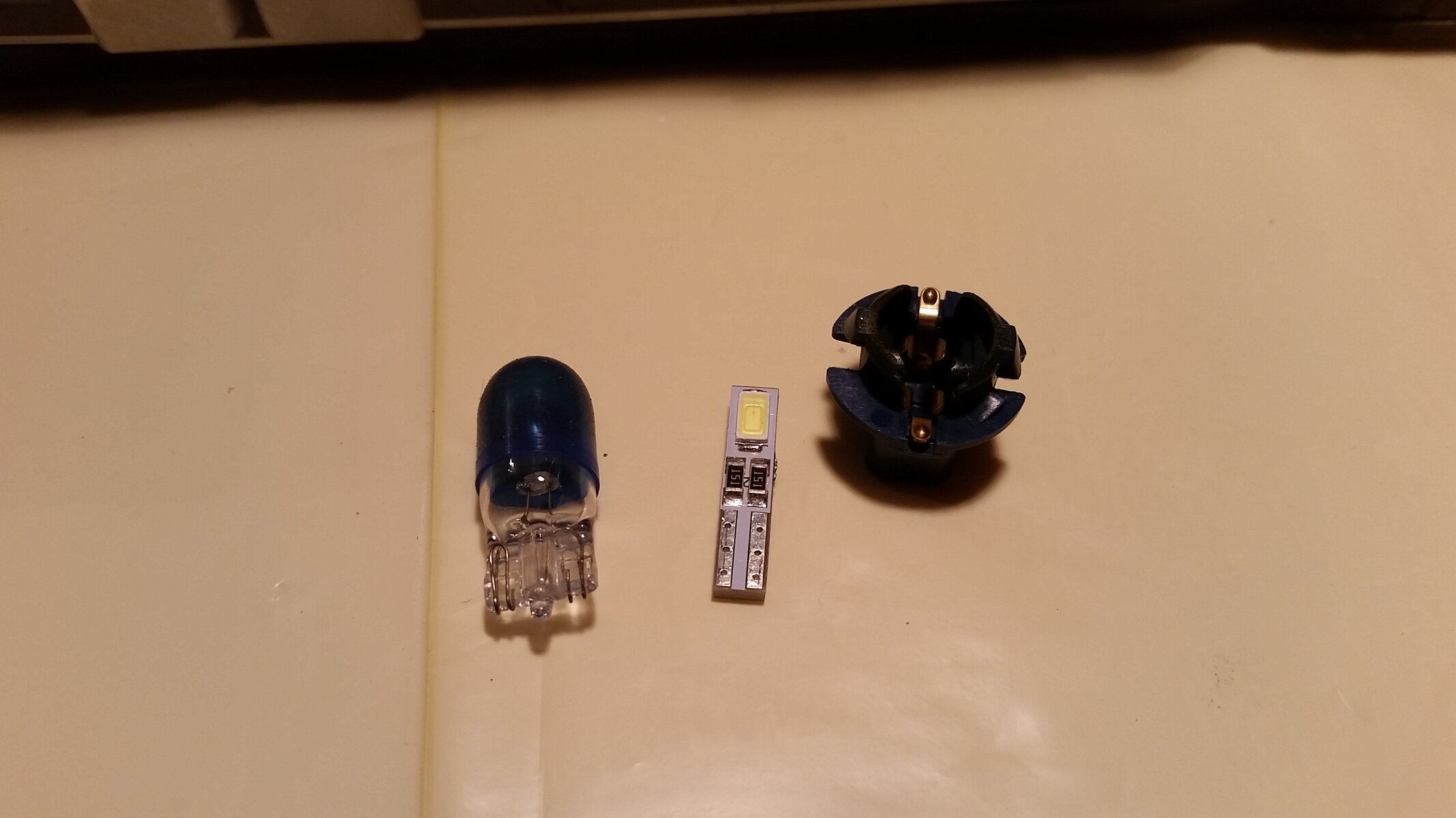

After seeing LED instrument bulbs on Chris' 80 build thread, I ordered and received some LED instrument bulbs (specific kit for a "Prado J90 1996-2002") from Oz a few days ago.
So today I got around to taking the instrument binnacle apart to fit the new bulbs..............now this in itself is a bit of a departure for me; I usually sit on new parts for at least 12-18 months or until the originals break, before I get off my butt to do anything. However today I thought, "let's end the year on a high!". Anyway enough about my lack of inertia.........
Out of the 5(? or so) "illumination" bulbs on the binnacle, 4 of them are of the T10/501 variety (i.e. those used in most sidelights etc.) and only 1 of them is the smaller (whatever) version. The LED kit I have been provided just has 6 of these smaller bulbs. :think: :cry:
I've emailed the supplier and am waiting for a response. That'll teach me for getting too eager! :icon-rolleyes:
Oh well, better put my feet up and have another beer :thumbup:
Add : Just ordered some LED T10/501/W5W bulbs off the bay, which looked OK. Hopefully get them in the next few days and complete this "little" job.
