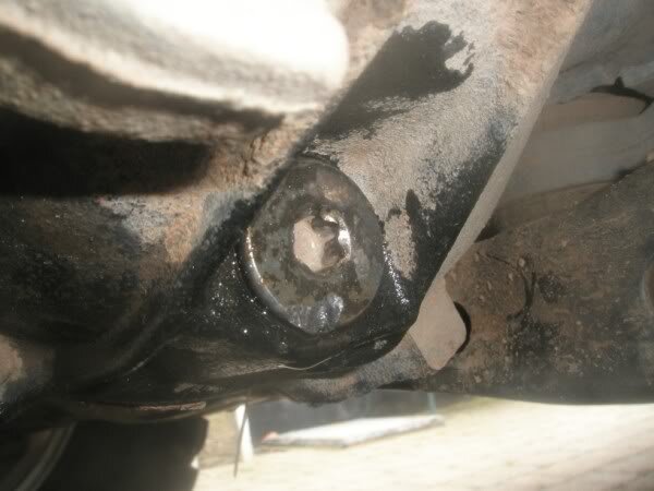

Was going to replace front diff oil. So I checked I can open the fill plug, before ending up with an empty transaxle that can't be filled - no problems there.
BUT - can I open the drain plug ?? Not a hope in hell - and the 10mm hex key has rounded the plug hole!! Oops.
So, wise people out there - do I recover this situation? Anyway of getting that plug out, or is it off to Mr T??
I've tightened the fill plug again. Now I'm going to have a braai and a Windhoek and think about it ;-)

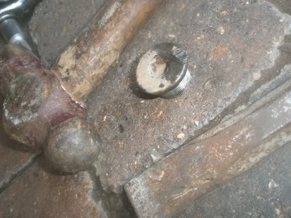

It comes undone a peice of pizz with a large cold chisel & hammer :thumbup: :)

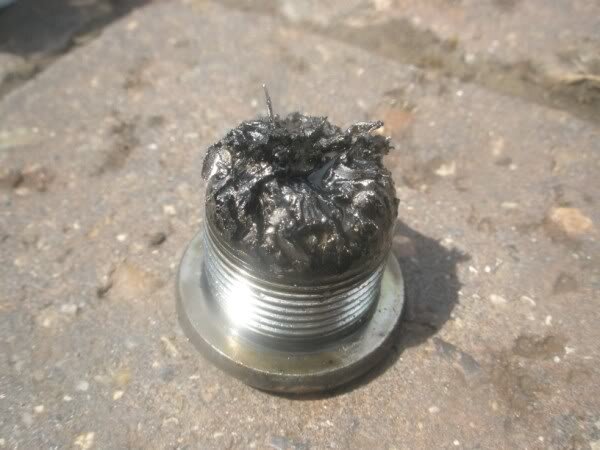

Hope you don't find this though

Ok cheers. I'll need to go get a new one on Monday I guess ...
As steven said hammer and chissel.
If you've got a rounded hole from the allen key, then try hammering a slightly oversize torx key in there. Nearly always works.
Freeze spray? No good warming it, it's used to being warm.
I would say weld something to it like a nut. But then I can. If you get one Gary, send it to me, I'll weld a nut on for you and post it back - for when you get the old one out that is.
Chris
Yep - considering that. FSM says to tighten to 37Nm - this is way more than that!!
:o That's what the drain plug on my transfer box looked like when Greg was giving my 80 a service before my Croatia trip, a little voice came from under the truck saying Chas, your trucks broke, I had been having trouble getting it into low range (like impossible) but one s/hand box later that he just happened to have lying around and I was one my way to foreign parts. Thanks Greg, it's still working fine. :thumbup:

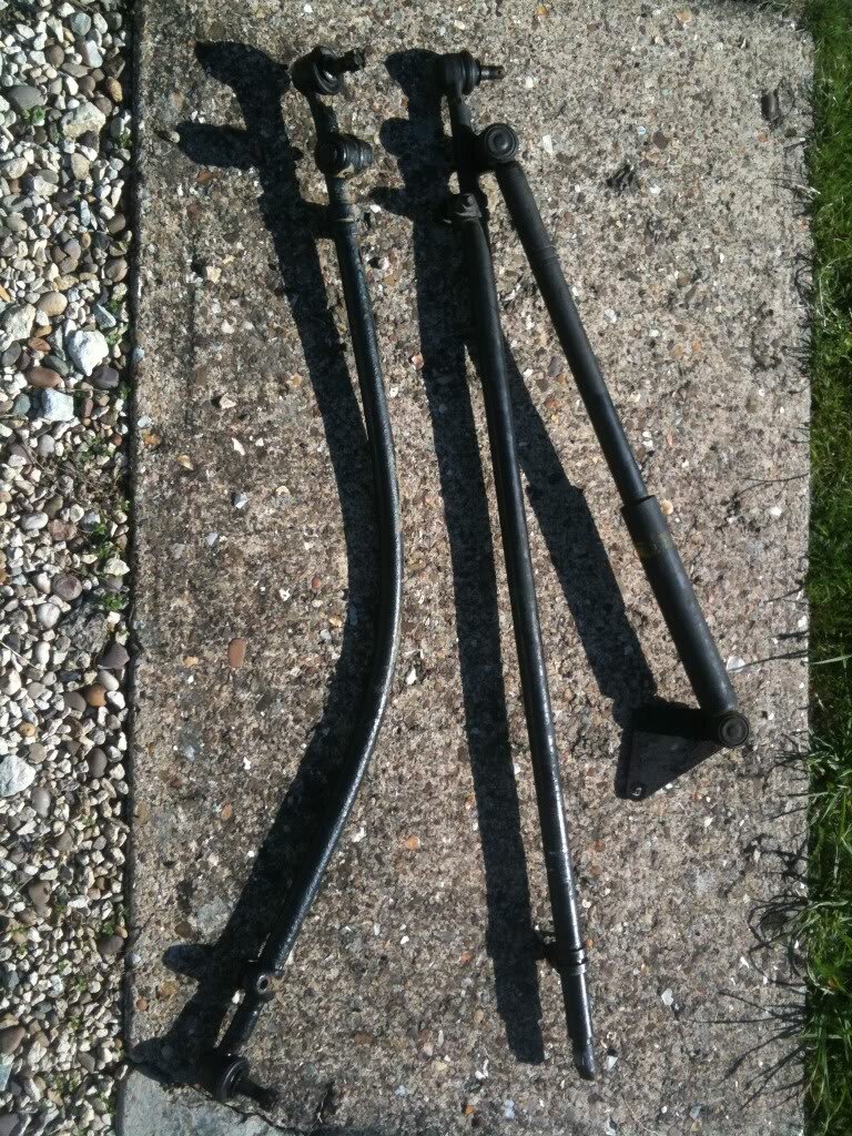

Spent today getting the old bars off my 70 that I knackered at my local pay and play, can't remove the track rod ends so my mechanic mate is having a go this week for me. Lots of heat needed apparently.
Old and new
And this is how stupidly easily I managed to knacker them, inexperience is becoming pricey :oops:
