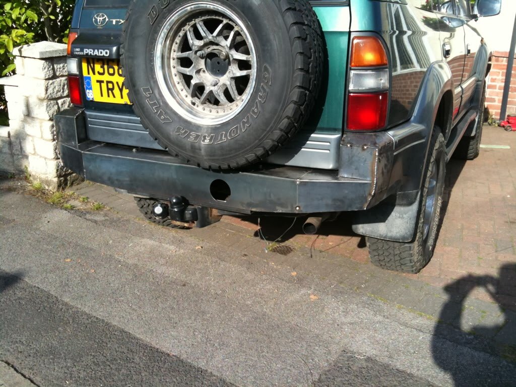

Rear winch bumper? Come on let's be 'avin it then! Accurately drilled holes for runners - I'm going dizzy!

Plan on doing some maintenance to the body later on........

PICS NOW!!

heres a couple will do a thread in the week some time

Made a pair of front recovery attachments,
4.75t tested shackle in place
Got it right this time..
