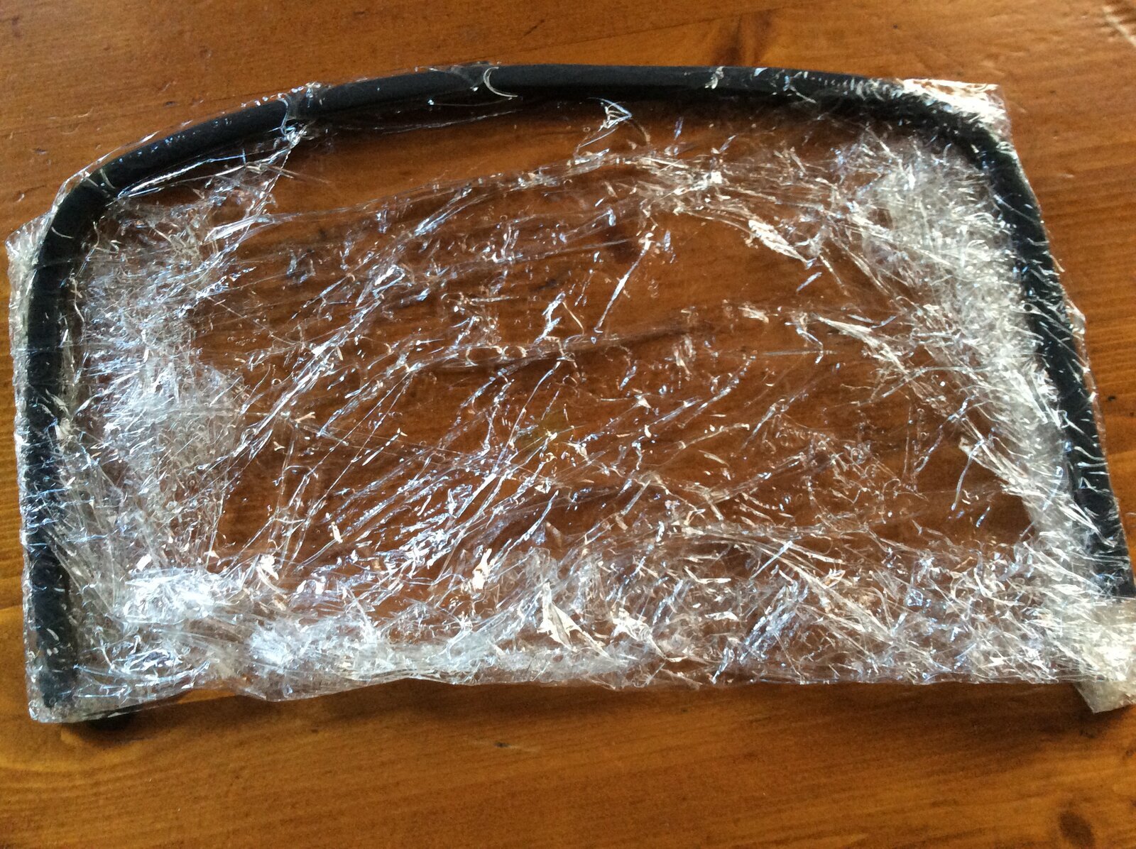

Another little something of nothing but apparently wrapped up like that and left overnight to soak in wd40 should rejuvenate that rubber strip for a tidier fit between consoles .
