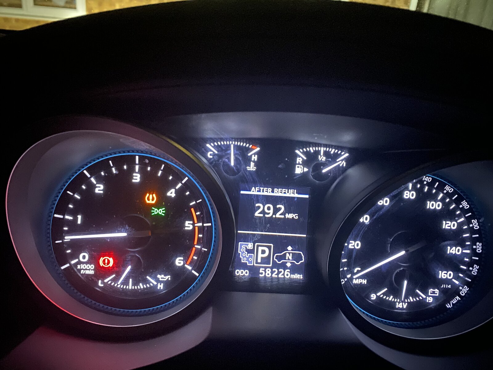

I wasted more than 1 year relying on garages. Thanks everyone, from info and inspiration from here I made my hands oily
. Now I am on cloud 9 after doing these maintenance jobs and every time it feels easier. Today I fitted some bolts on bash plates without seeing them. Only power steering, brake fluid and AHC bleeding are left out to complete.
I now have the schedule to follow.
