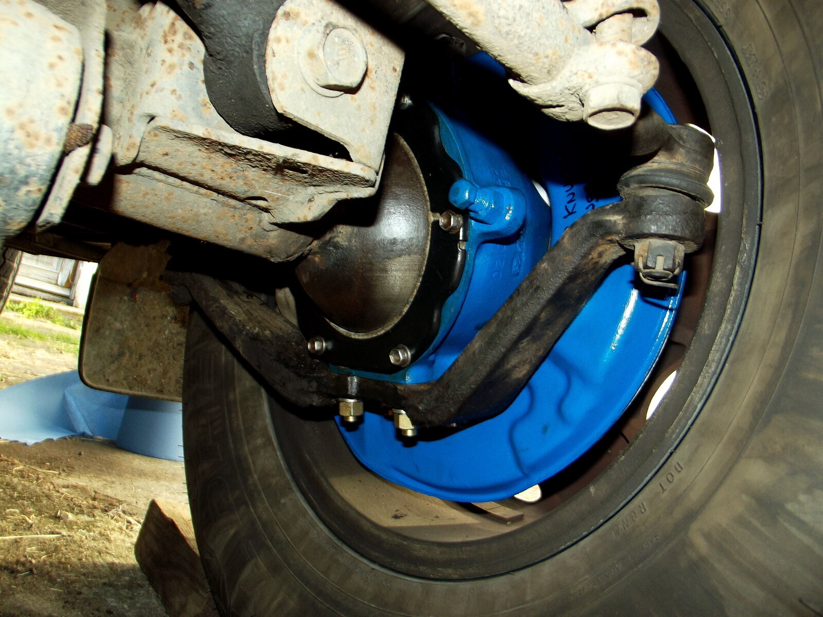

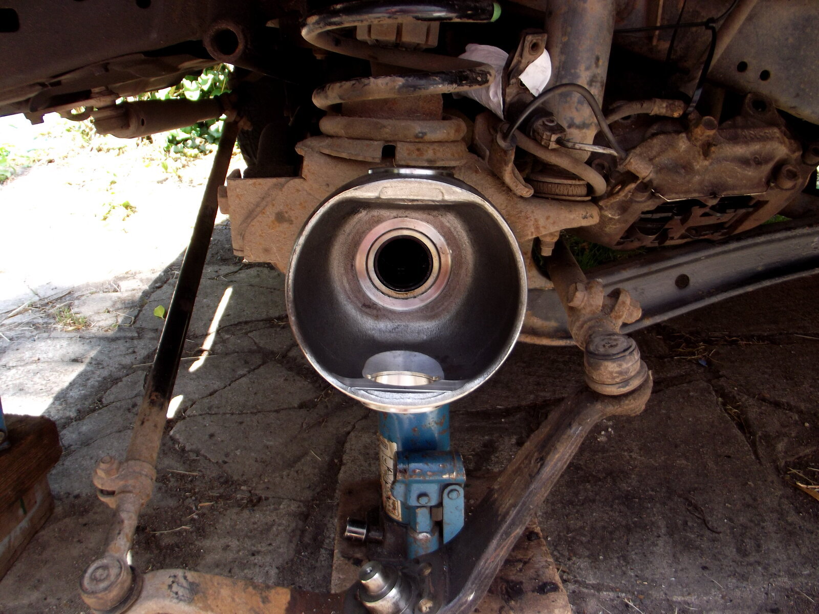

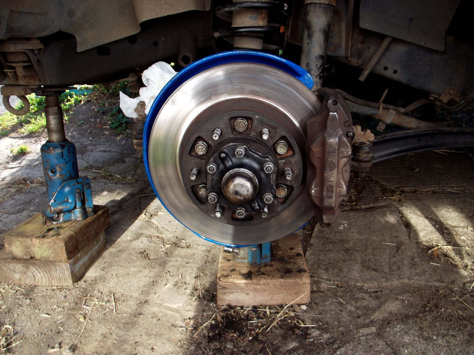

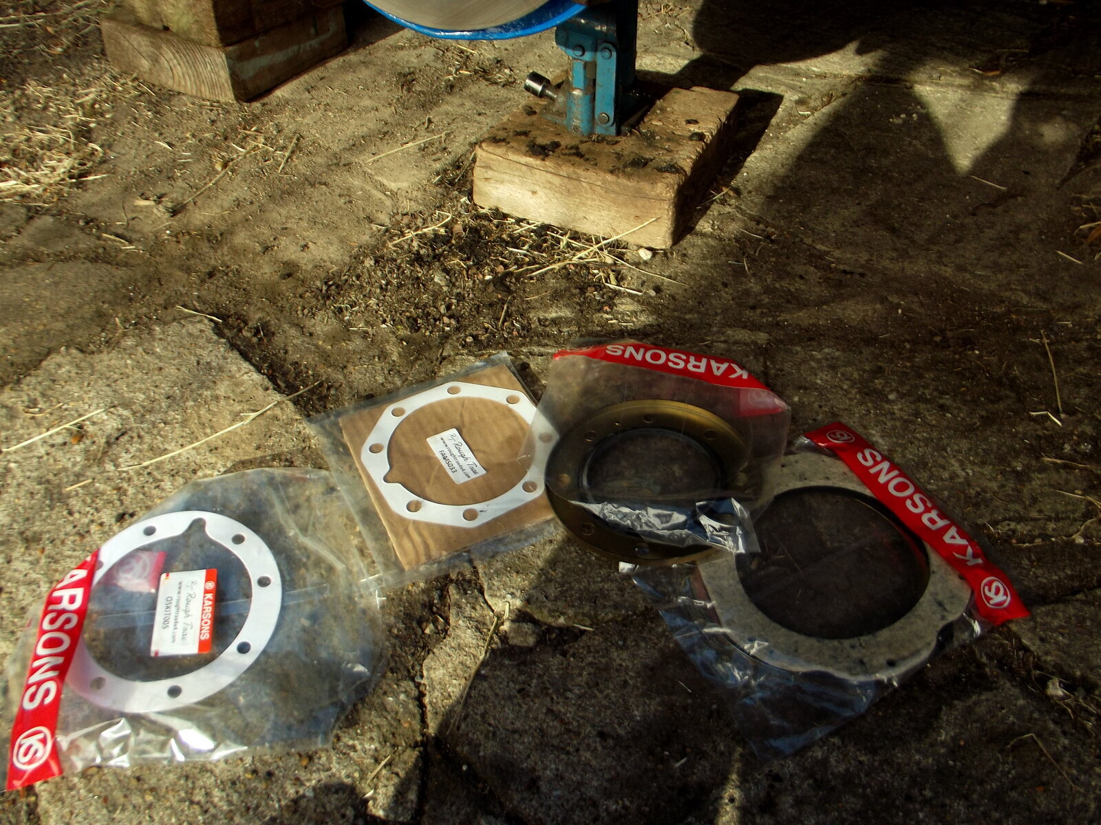

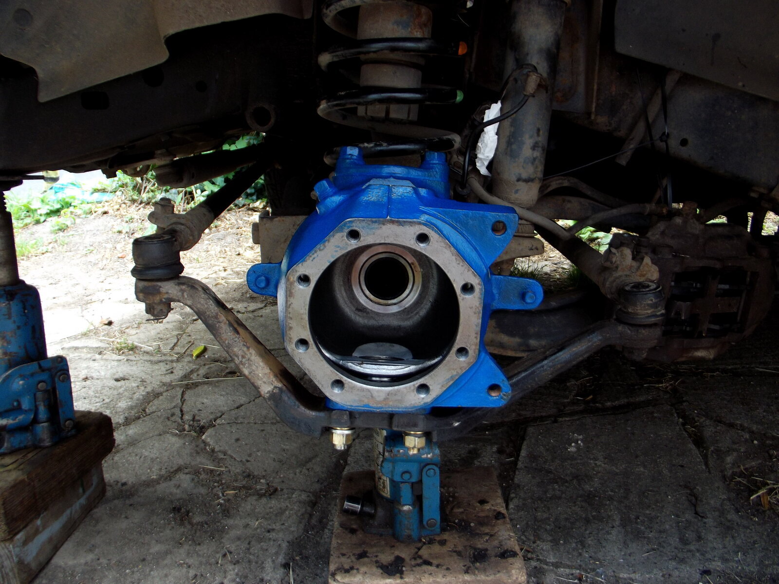

Well what started out as just a broken lower steering Knuckle stud. Turned into a Full front axle strip out, New steering Knuckle bearings, seals, axle seals, Gaskets, Knuckle wiper seals.... Jesus the list goes on,.... About £200 worth in the end ( price of a stud £3)... anyway a nice enjoyable job in the end :thumbup: While i was at it Treated the old Gal to some new Rear pads and a fuel filter....

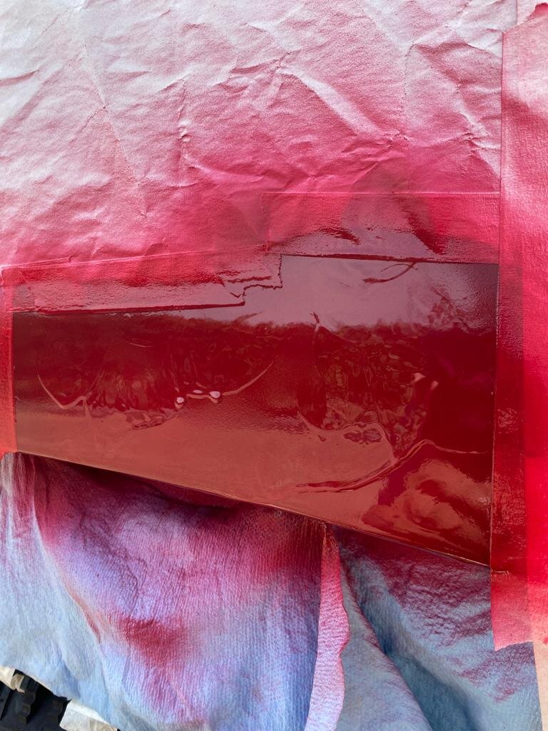

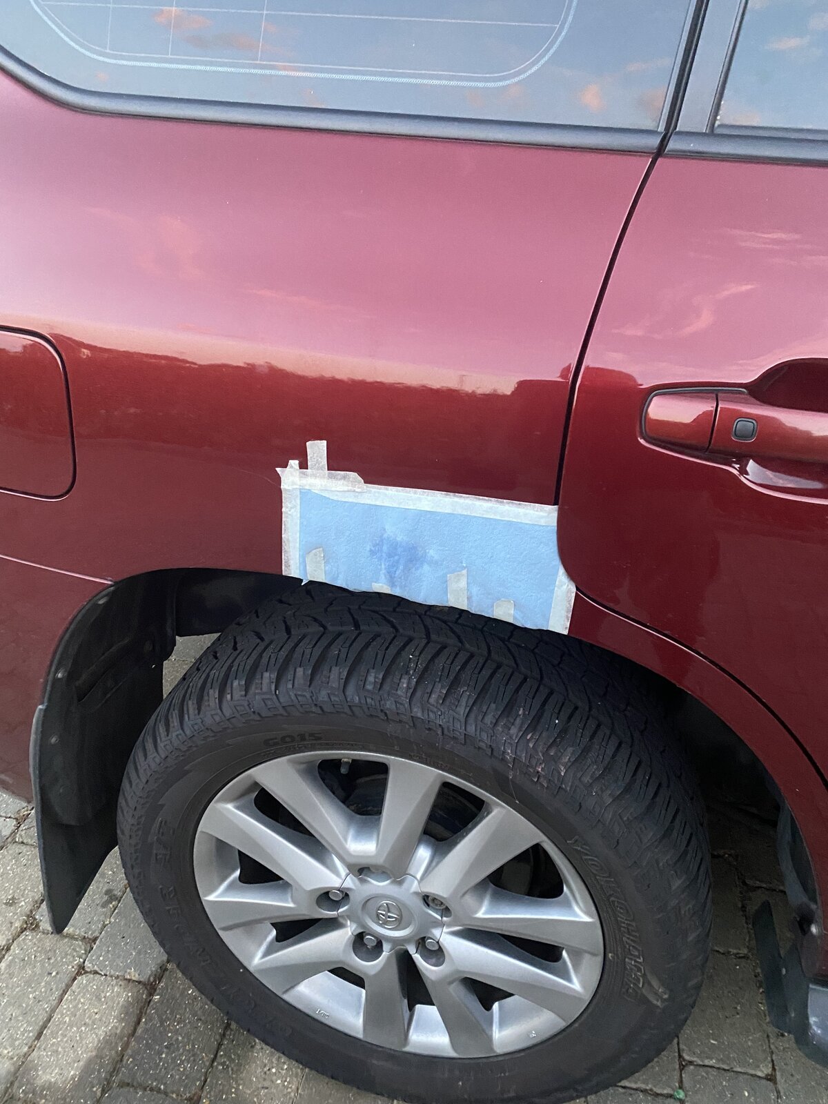

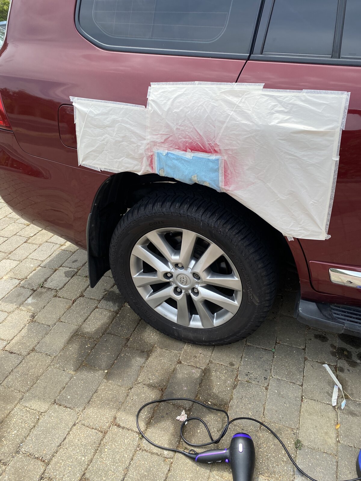

Tempted by Shayne's painting job, I too started a small cosmetic job 2 weeks ago. Tried to repair the clear coat peeling but I ended up sanding the paint itself and exposed white primer. Another mistake and learning. I applied plaster and left the car without driving since then.IMG-3003.jpgIMG-3026.jpgWhatsApp Image 2022-07-17 at 12.50.53 PM (1).jpeg Today I sanded the area a bit more and used spray paint but this time spray paint was too thick and uneven. I again applied bigger plaster and left the car and left it. I will now sand it again to smooth finish and get it ready before next week or else I will end up sleeping in Lexus like last time for the wales camping meet. :)

If your satisfied the paint is a good colour match then remove the masking tape and paper and sand it back to primer , or flat anyway which might reveal some primer .
Put a rag over your wheel maybe but everything else that might catch overspray is the same colour so no need for tape .
First pass with the rattlecan is nothing to do with colour it just puts a sticky layer down so the next pass 10 or 15 minutes later doesn't run .
10 or 15 minutes after that the third pass will colour most of it so after another 10 or 15 minutes the fourth pass is just for luck really .
You might have quality paint in a crap spray can or crap paint in a quality spray can or anything in between , so what happens next is your call .
That its a patch of new paint will be obvious (even a pro can't match old and new paint) but if your otherwise happy with the finish add clearcoat 10 or 15 minutes later over a larger area . Let it dry for a month and when you polish your simply flattening the clearcoat so nobody can tell where the old paint and new meet .
If your not reasonable happy after the fourth pass with paint but its not too bad then wait a couple of days for it to dry before smoothing it with very fine wet and dry and hopefully the paint with be thick enough that you can just clearcoat it without adding more paint .
The harder you try to do it right the more likely it is to go wrong , it might look good after two passes with paint so stop there , if it needs six passes does it matter its only time .
I already sprayed 6-7 coats of paint. Each time I spray, waited for 15 mins, and looked, I felt I little bit more would be good. After I was satisfied, I did one last coat for peace of mind. I am doing all sorts of experiments and learning on LandCruiser. Even if things go wrong I am not worried as I have the forum for correcting tips :) and working on it is like mental therapy. It will go out, it'll get parking dents, scratches and maybe stone damages eventually once I start using it for what its made for (Overlanding/off-roading/utility).
I did the same Raj if the forum search function was better you might find 100 of my paint experiments lol .
The tape is your worst mistake because when you remove the tape there will be a line between old and new paint that you couldn't remove with heavy duty cutting compound and a machine polisher if you tried every day for 6 months .
You will have to sand it all back and repair a larger area now but its only paint and every mistake teaches us something about how to do it easier next time .
