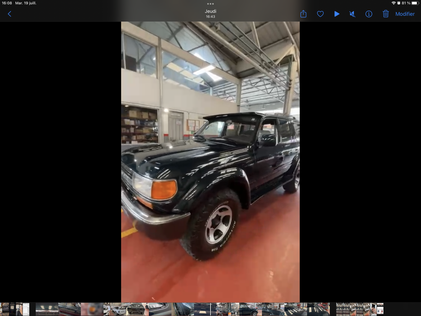

And before I forget, I had the truck repainted last month. Here is the result.
Cheers

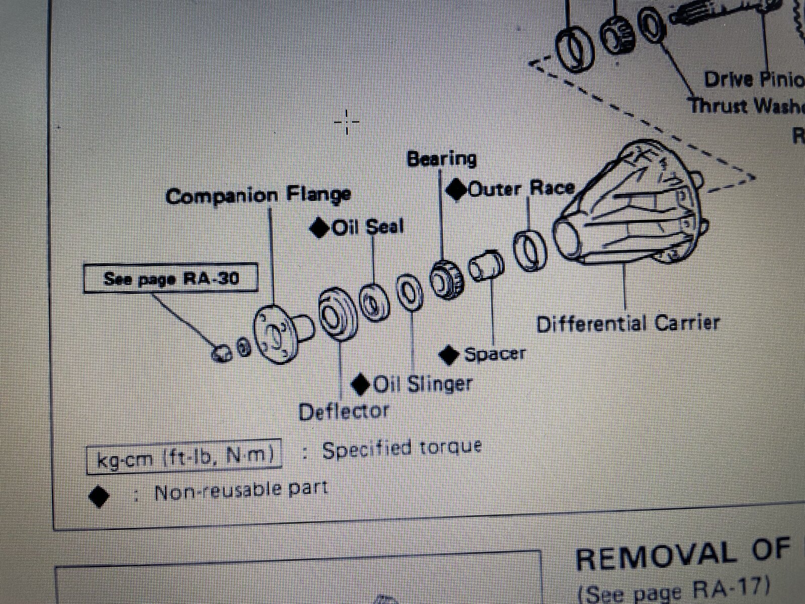

A job for the weekend is to sort out a loose and rattling Deflector on the rear diff housing which reared itself yesterday coming back from Warrington.
I think its job is to minimise any crap from getting onto the oil seal. Somehow it must have just pushed onto the end of the diff housing. But now both have worn against each other and there is no way of pushing it on. So its going to either be cut off or glued back on with silicone or something that can be removed if needed.
Could anyone see any flaws in this cunning plan please?
I dont want to be removing the companion flange until absolutely necessary - I can see that becomming a full diff rebuild !!
Thats a good Idea Shayne thanks.
But the only feasible way i can see would be to use that sort of stuff to build it up then use a new deflector as a mould with perhaps a layer of vaseline or something to prevent it gluing itself on there while it hardens.
The current plate is so worn if i use that then it will never allow a new deflector to fit so im back to square one.
Using a new deflector will need the companion shaft to be removed to get it on.
Perhaps the putty could be applied around the outside of the old deflector to glue it on so at least it could be ground off in the future? What do you think?
I can't quite picture what your trying to do but assuming its not worn all the way around then cover the good bit with tinfoil and take a mould with your steel putty ?
Yes it could be worn all the way round Shayne there is certainly a millimetre of space all around. I like the Tiger seal idea too, thanks Tractionman.
So Im going to clean everything off and get it all nice and dry. Then see if i need to key it.
The deflector will then get 3 dabs of hotmelt glue to hold it centrally before a test drive.
If it holds then I will seal all around the outside to further stick it onto the diff housing.
If it doesnt hold with that then I can try the metal putty.
If it ever comes apart then it will need a machine shop to sleeve it for a new deflector to fit. Or perhaps I could find some sort of rubber boot.
Off I go full of optimism!!
