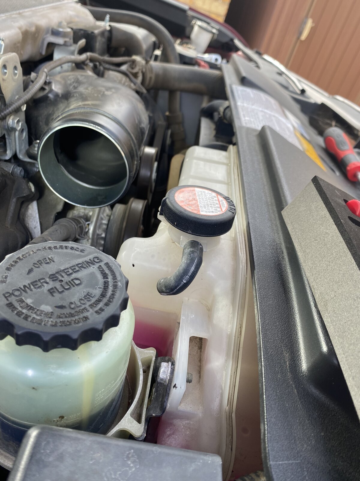

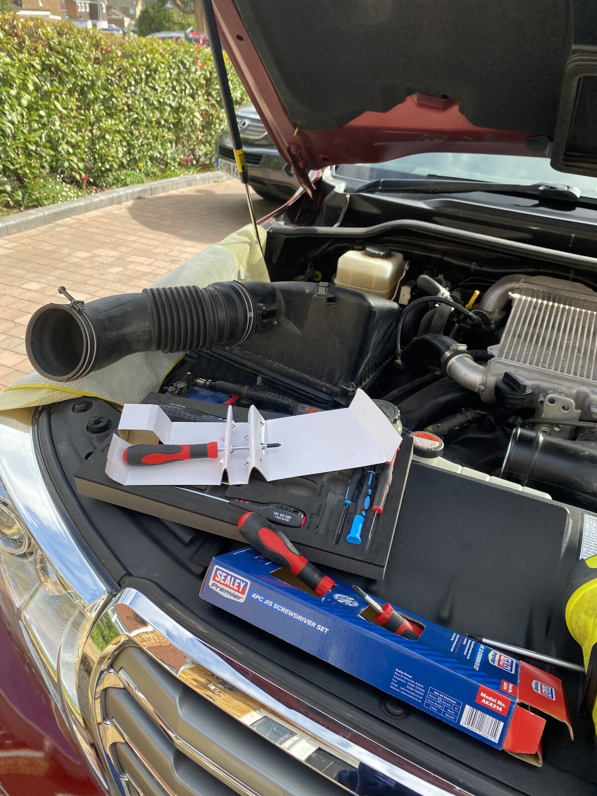

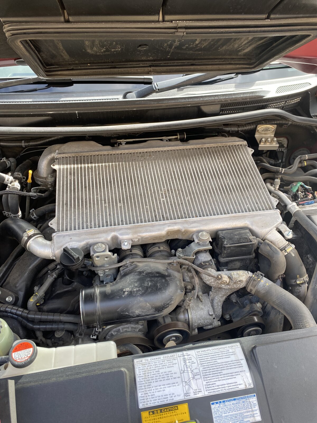

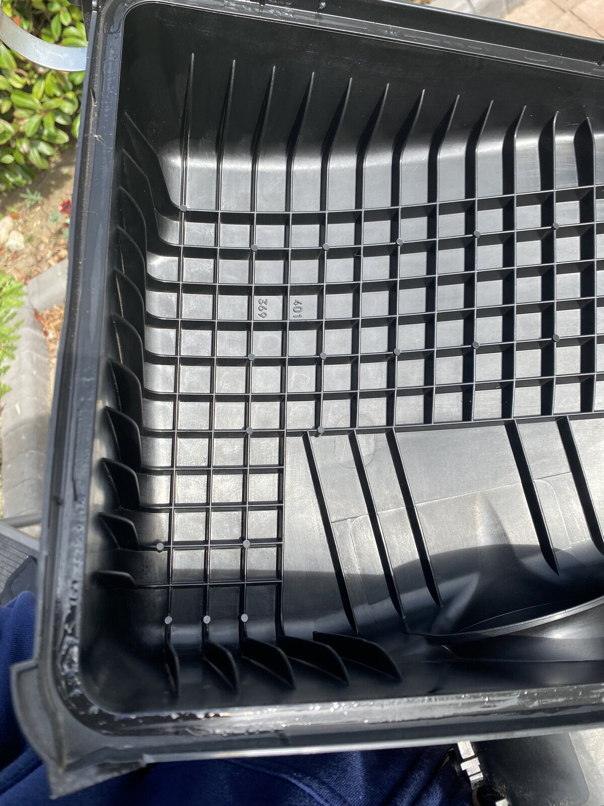

Did 4K oil change. The plan was to change at 5K but still have the confusion between kms and miles so decided to do at every 4K miles which is approx 5K kms. Changed, oil, engine oil filter, air filter, and cleaned MAF sensor beside the oil filter box. Took off everything and tried to reach throttle sensor to clean it but could not locate it so left that for next time. Did everything last weekend, got a steering lock and packed the car.
