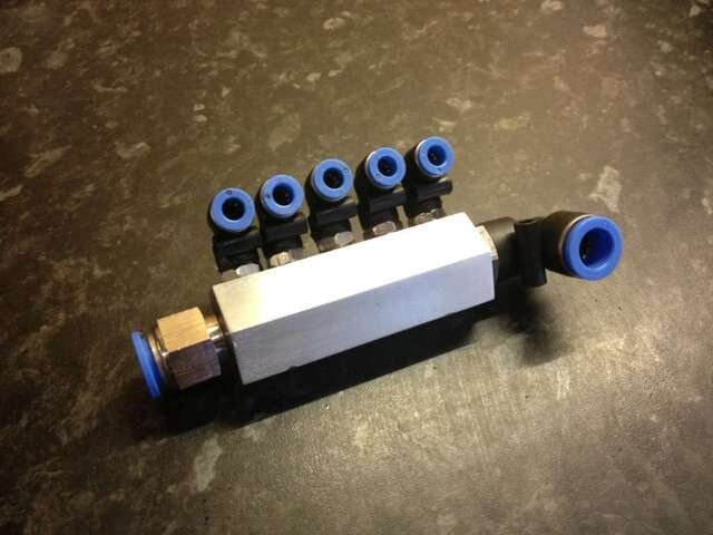

Modified my breather manifold to take 2 1/4" 12mm pushfit fittings (6mm is much too small for an engine breather).
[attachment=3:x5iumttc]ImageUploadedByTapatalk1343586911.590350.jpg[/attachment:x5iumttc]

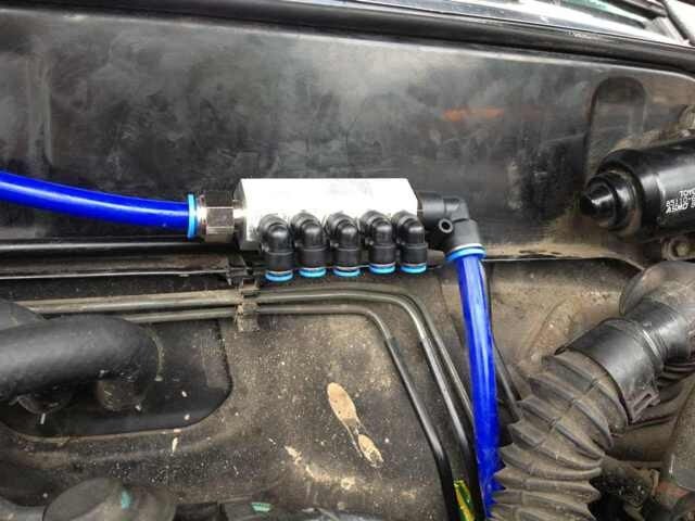

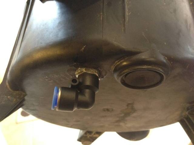

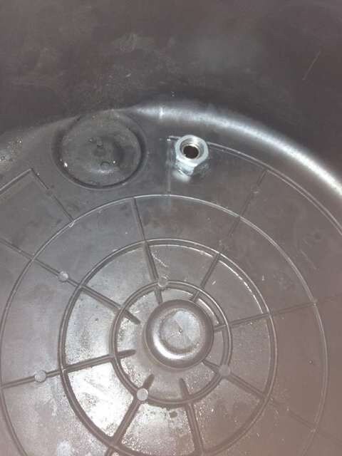

Also plumbed the manifold into the airbox.
[attachment=2:x5iumttc]ImageUploadedByTapatalk1343587042.994754.jpg[/attachment:x5iumttc]

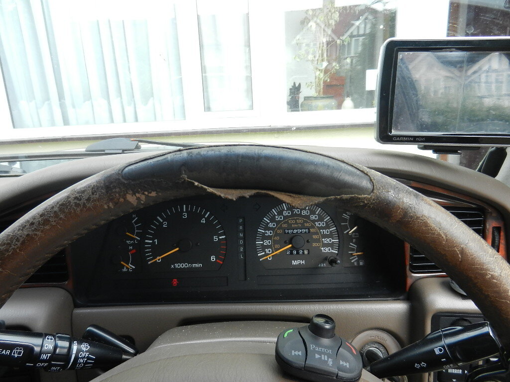

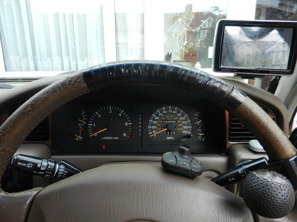

Today I tidied up my steering wheel which was very worn at the top, I had wrapped insulating tape round it to hide the damage but in the recent hot weather it got soft and very sticky so I bought some self amalgamating silicon tape which did the job nicely. I went further round the wheel than was necessary to make it look a bit neater. :thumbup:

Ever thought of something like this chas ? i've got a second one of these that just might be available.
That's a lovely thing. I'd like a wheel that's just slightly smaller diameter so that I can get my knees under when clambering in. Yes, I know it adjusts.
Chris
I would love one of those joinerman, unfortunately my steering wheel incorporates the cruiser control, you can just see the lever on the third picture. I already have a wooden wheel that I can't use because of that :thumbdown:
I'll have a measure up!
Chris
