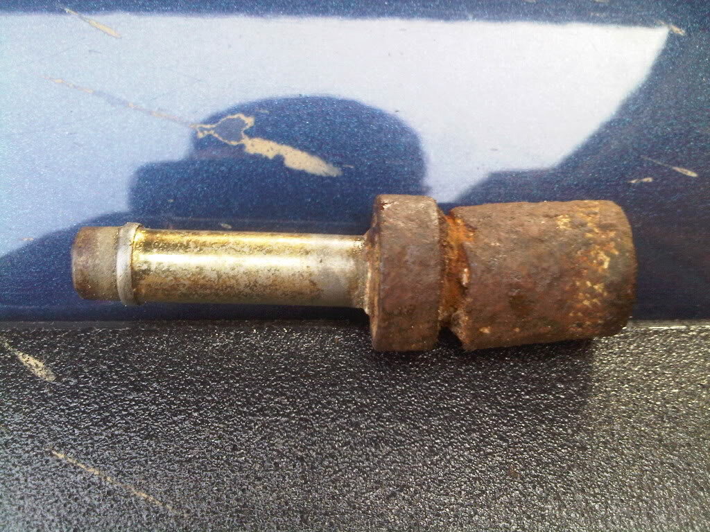

Changed axle and engine oils before the big trip :thumbup:
Lucky i did, rear breather was blocked and axle was quite pressurised but meant the oil was quite clean ;)
Front one was ok but the oil had seen better days so will maybe change again next week, next on the list will be the extended breathers.
