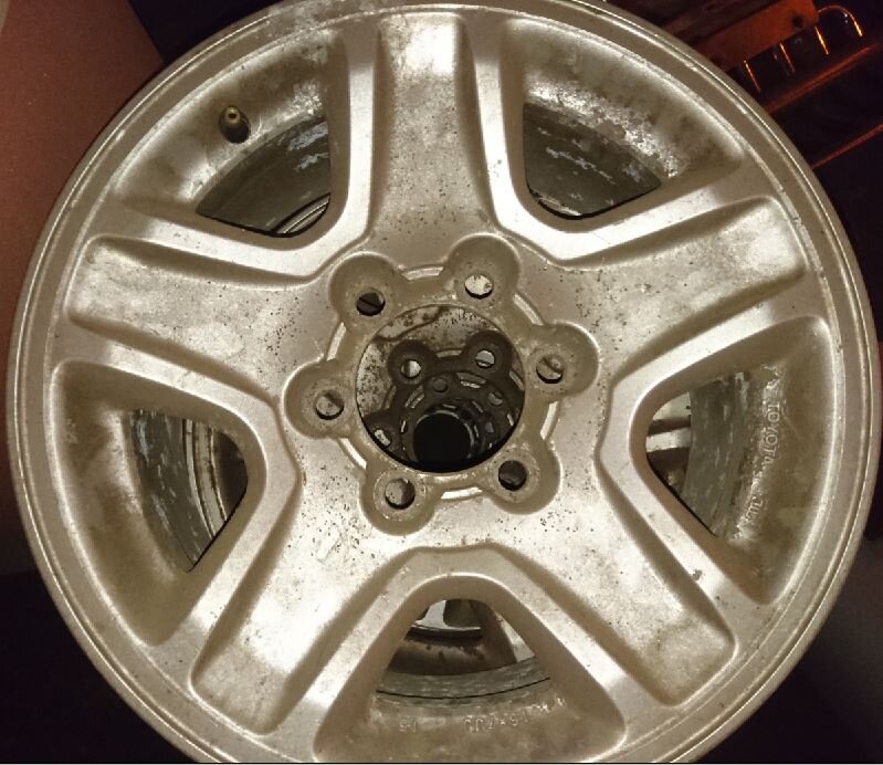

Those seem to be OEM Collie alloys, Then 265/70R16 is one of the factory fit tyre sizes - so any brand in that size should be fine.
Yeah thats the size the mrs has on her standard alloys though they are a cheap brand Jinuh , and so they will stay until i get around to fitting 16x8 wheels that fill the arches much better .
If you are getting new tyres all round, why not get 265/75 they are very slightly bigger, but look better IMHO.
Also more choice in tyre size at 265/75, as its common on Landies - also means you can often get cheap deals on 4x if you order from somewhere like Paddocks.
It does effect the speedo because you travel further with less turns of the wheel . But how accurate is your speedo because 285 75 R16 made my speedo dead on accurate according to satnav and them please slow down digital speed signs at the side of the road .
