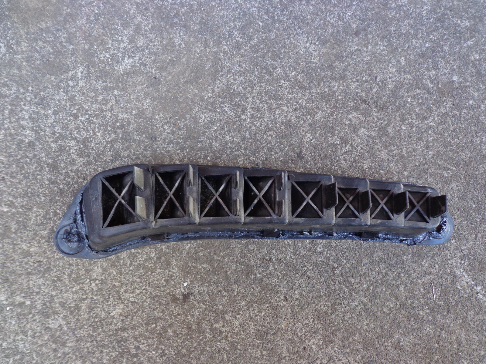

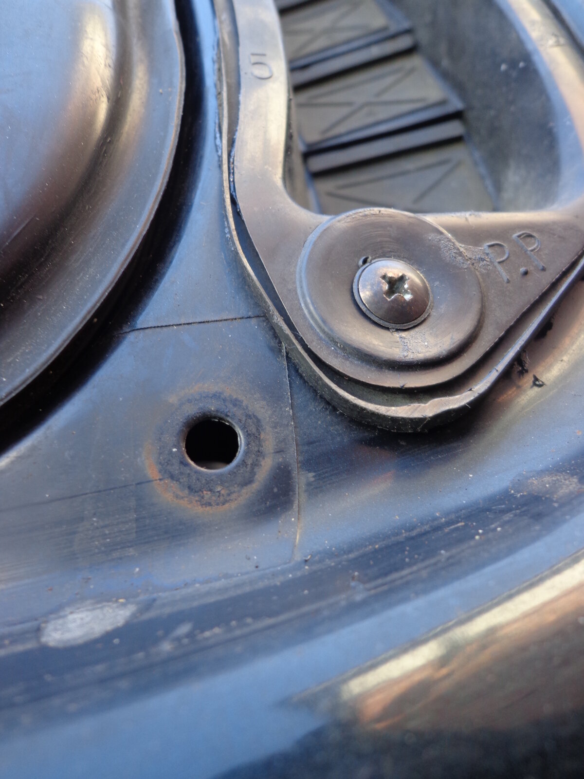

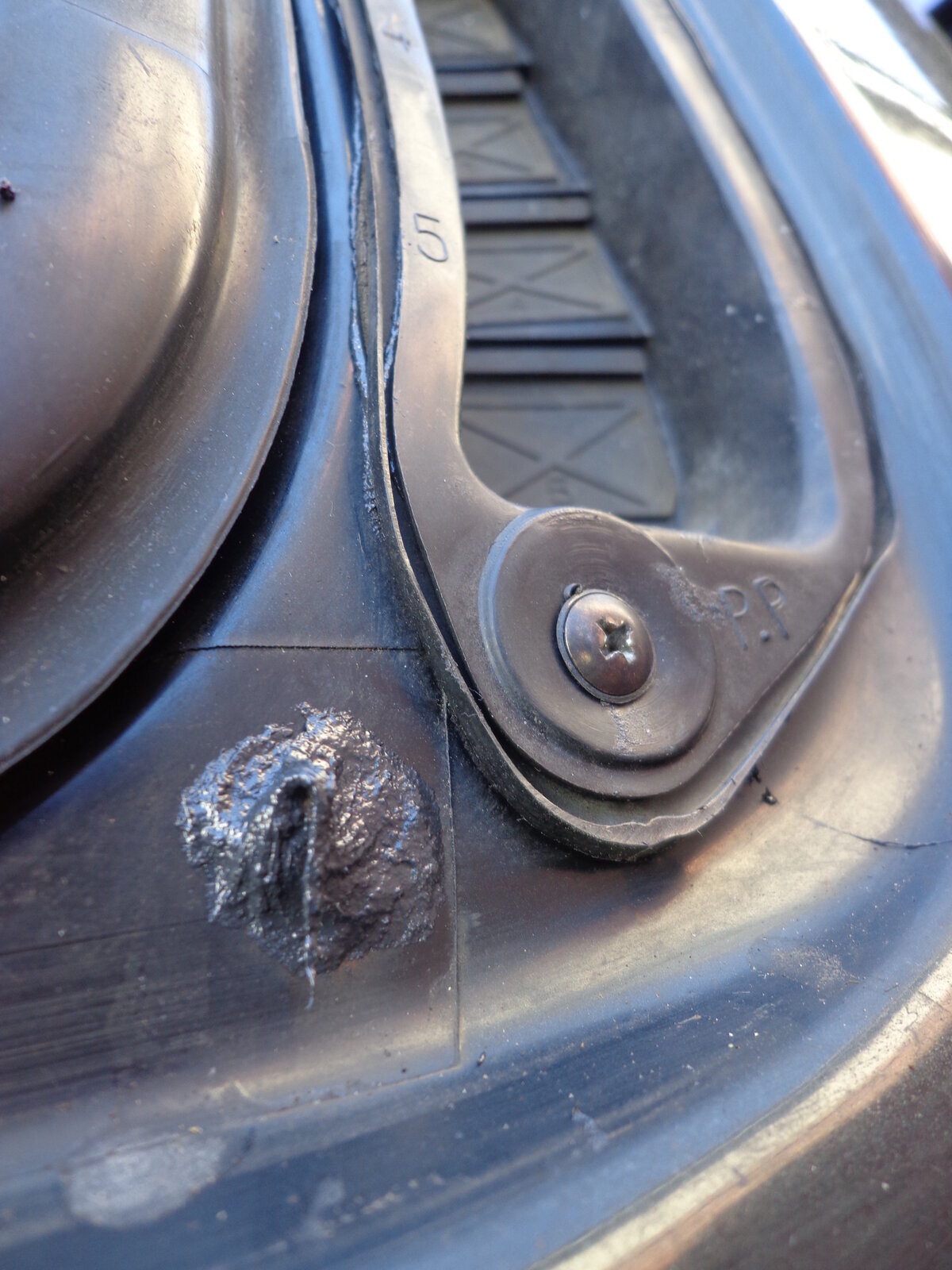

below is a test fit verify where the trim fits on the bodywork,it required a fair amount of gutter seal to produce a satisfactory seal.
before sealantDSC08763.JPGall holes must be filled like this before refitDSC08764.JPG

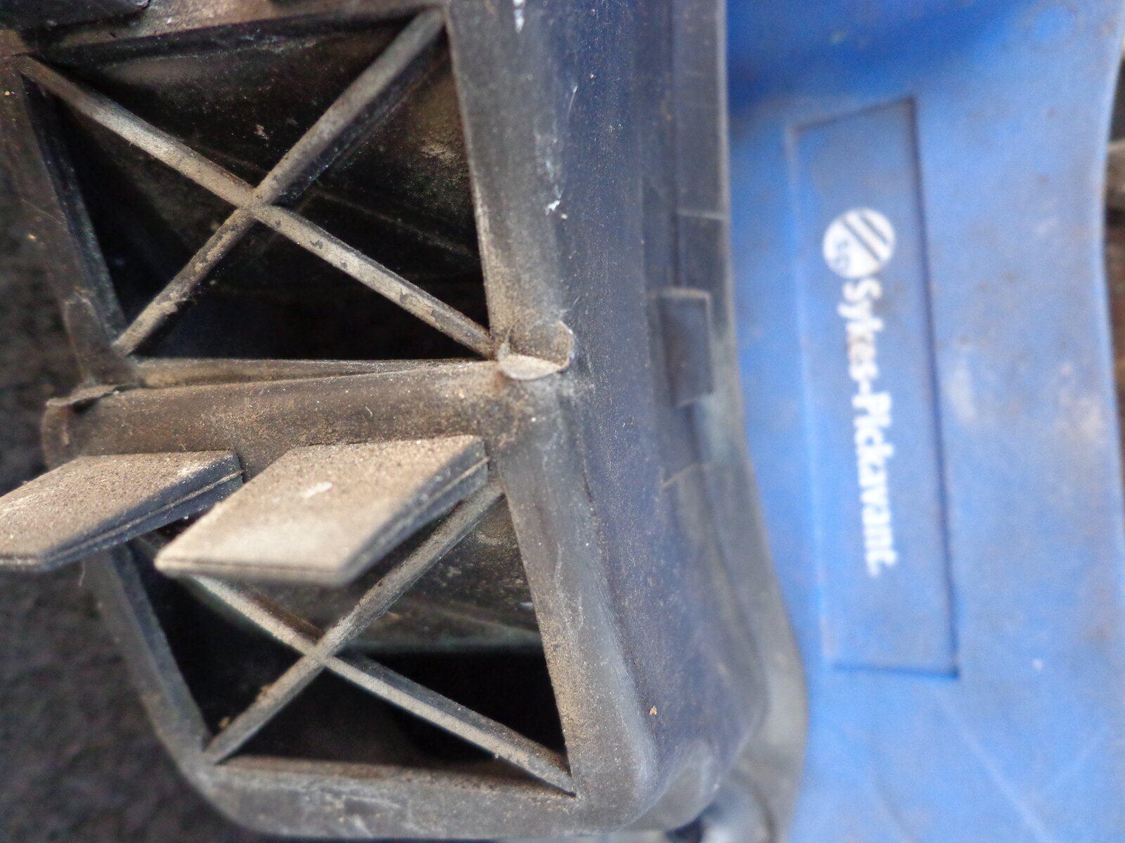

Please note, you do not have to seal the flappy rubber air vents DSC08756.JPGthis flap opens and closes with air pressure DSC08725.JPGon the outer seal,any water entering there will be caught by the inner panel.
any screw that is not fitted with a a quality seal or blobs of gutter seal will allow water to seap in ,over time it can be a rusty pond.
First roof leak check is ... open your sunroof and visually check the drain holes,pour water in the sunroof gutter and the water should exit via the rear quater panel behind the rear wheels next to the plastic side bumper trim.Use very hot water to efficiently flush out the drain pipes.
