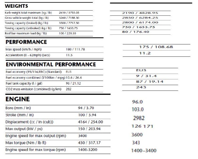

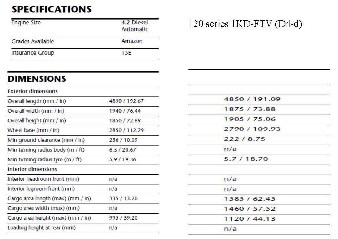

A few differences.
But I think Toyota are perhaps being economical with the fuel consumption figures for the 100 series?
Stating a combined of 26,6 mpg for the 100 series, and 31,4 mpg for the 120 series.
[attachment=1:3qstqyy9]LC100 v LC3 top.jpg[/attachment:3qstqyy9]
[attachment=0:3qstqyy9]bottom.jpg[/attachment:3qstqyy9]
The 120 engine being more efficient
The 100 series needs 28cc to develop 1kW
The 120 series needs 23cc to develop 1kw
All this imaged stuff is from the Toyota bumf.
