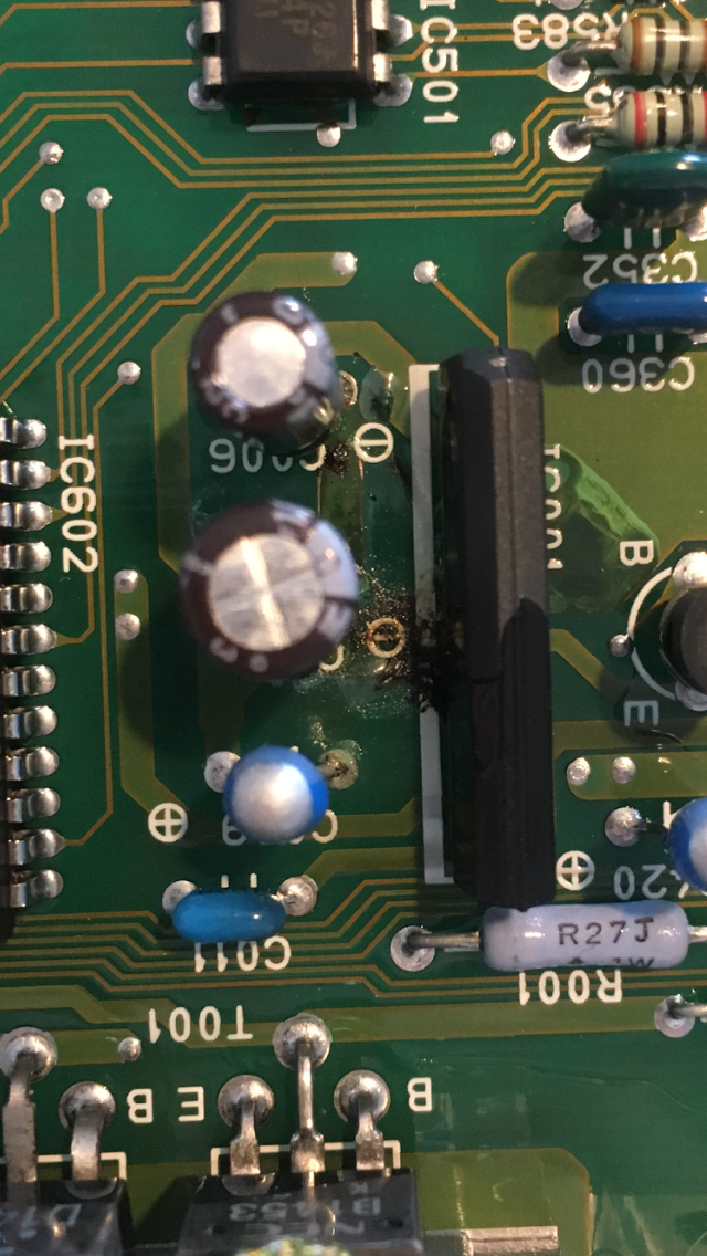

Discovered a wee bit of leak from a capacitor on the ECU circuit board so I'll see if switching to the other ECU makes a difference. I would love to know if this capacitor is related at all to the Timing Control Valve but can't find that info online.
In the meantime I'll have this one repaired. I have read about an ECU doctor.
Right lads, popped the other ECU in and let it idle for 5 minutes before killing it. Looks like its sorted but I'll find out more in the next few days/weeks.

Farmerboy had an starting problem even after eliminating all the usual suspects , it turned out to be a dry connection in the fuse/relay box .
goodoldby mate but yeah well remembered.A kiwi also had the same problem &theplace that repaired his said it was a fairly regular occurrence.
But great thread everyone , really useful.
@goodoldboy I know the kiwi place well - anything electronic in Nelson, South Island. the capacitors give up every 10 years on average.
Would recommend everyone to take a look at their ECU periodically and see if anything is leaking. A simple, 1 hour job for KZJ7x and KZJ9x prados where the ECU is located above the glovebox. Can't speak for other models.
