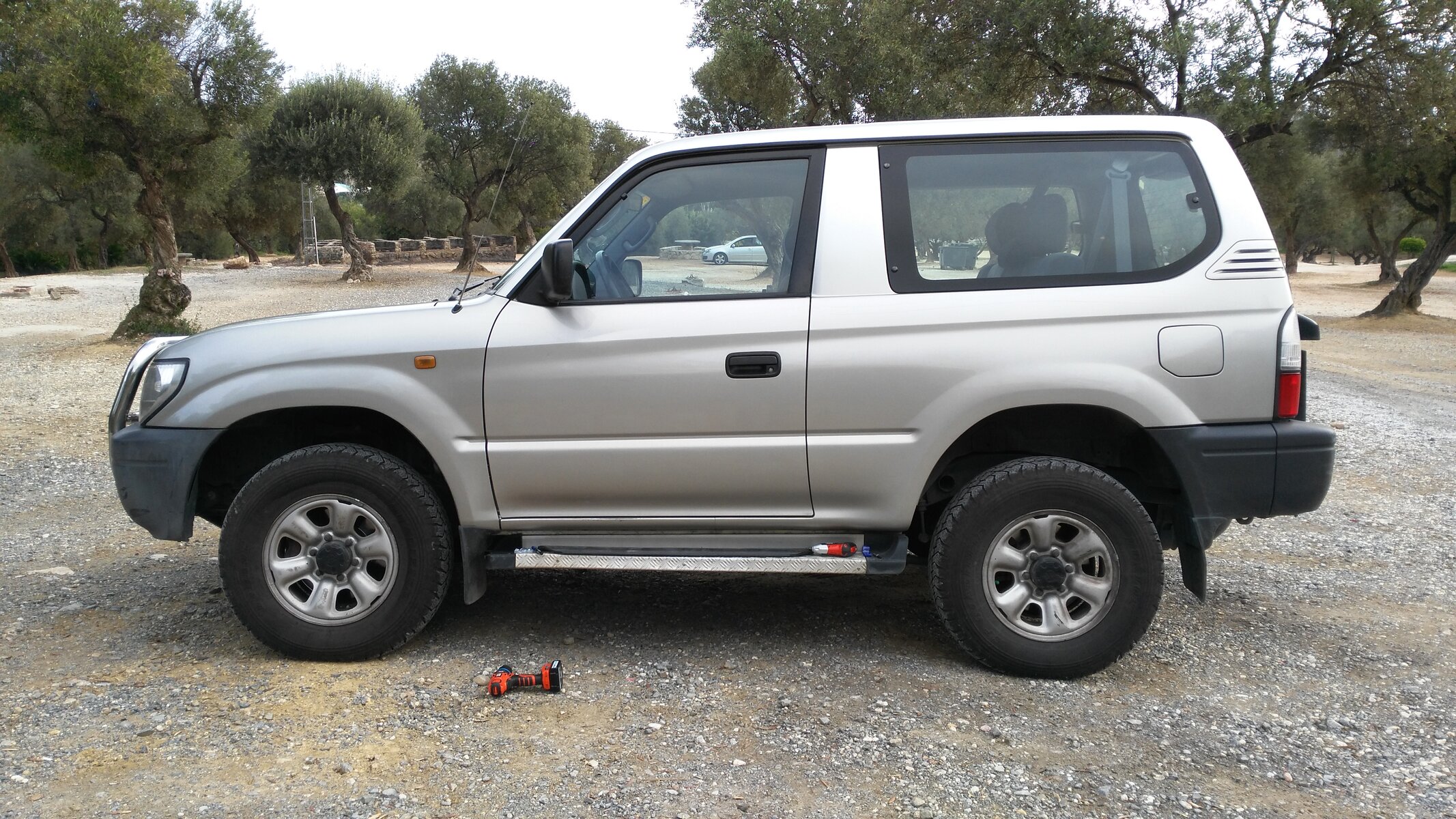

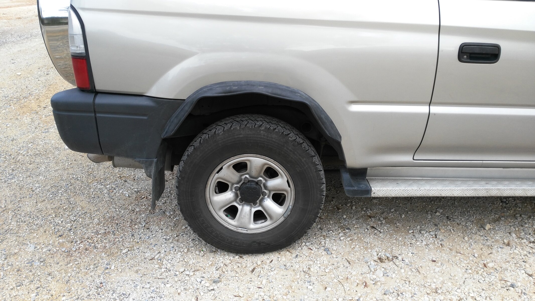

I did this with the BJ 46 :
before :
After :

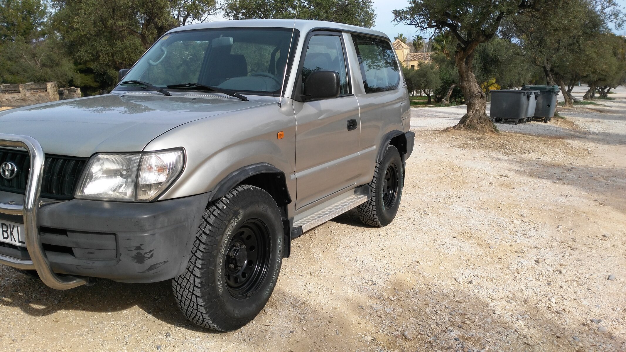

Had some issues fitting the new wheels and tyres (I have settled on General Grabber AT, 235/85.), the offset of the wheel is too wide, so need to install wheel arch extensions.

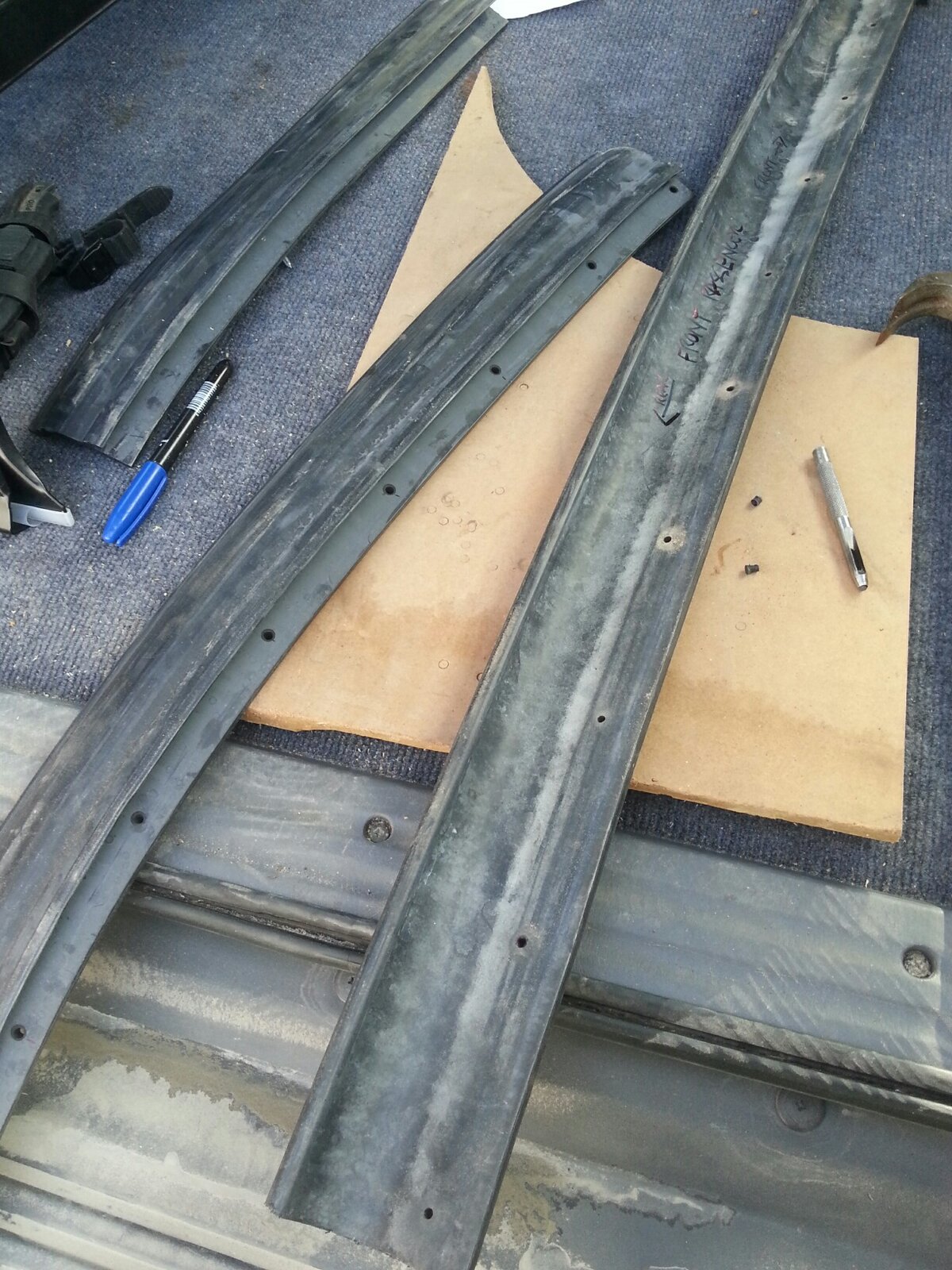

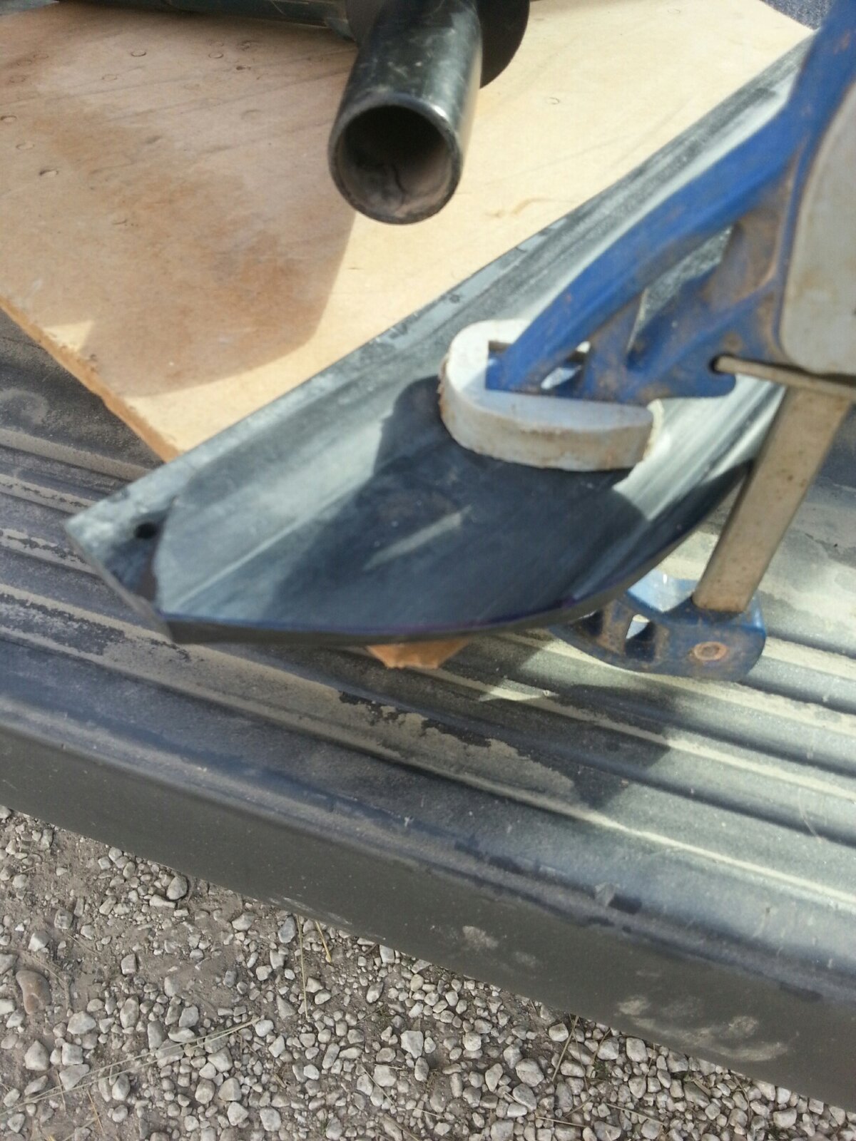

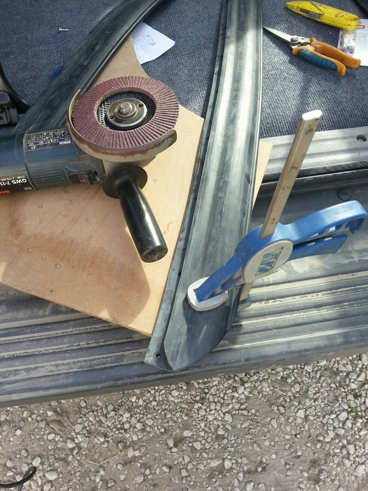

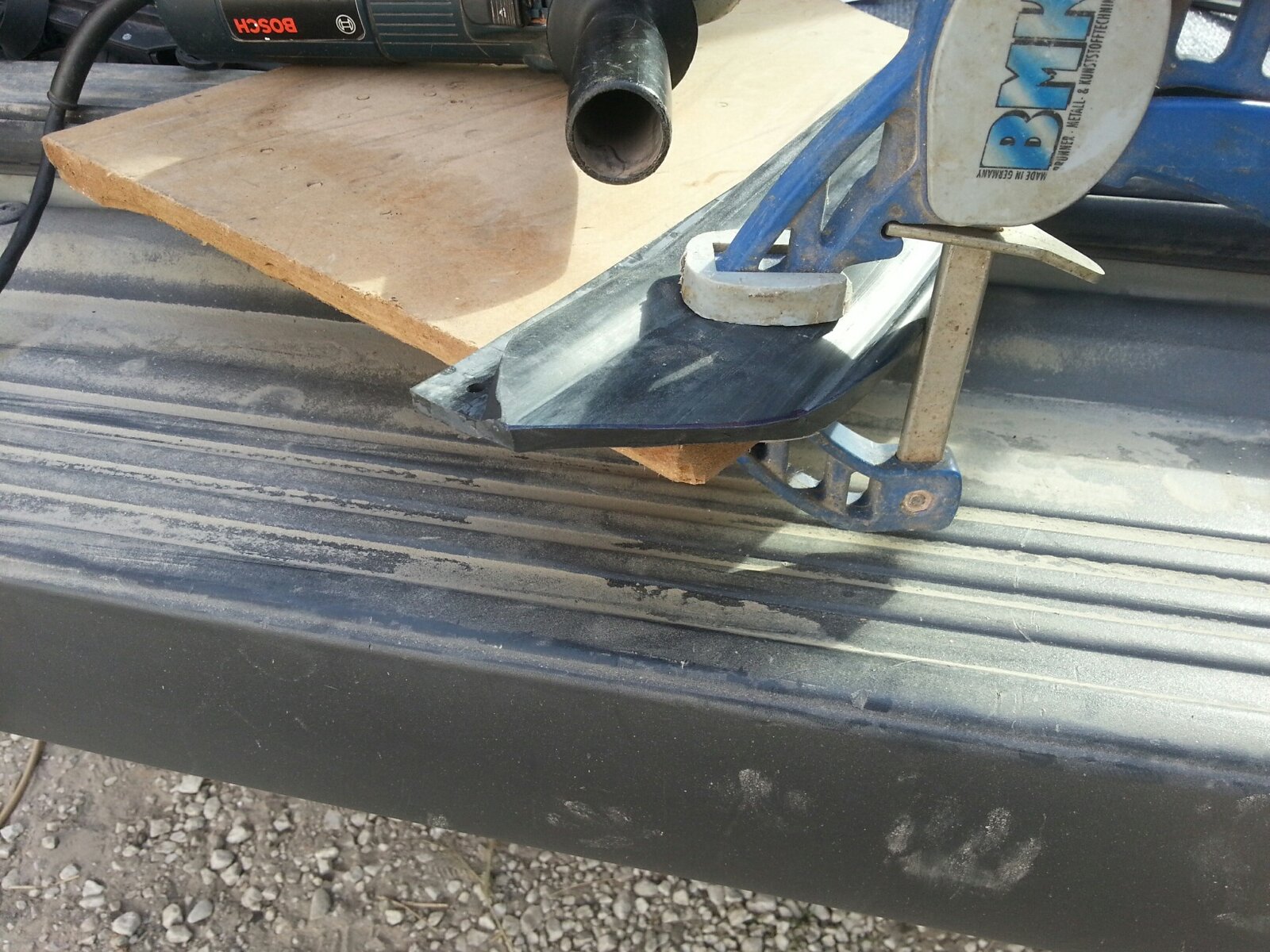

They arrived just before Christmas, so I have been preparing them ready to install. I will take the car for it's annual inspection before fitting, then I have a year to worry about the paper work. I have them measured, trimmed and punched holes in them ready. The fronts are a bit tricky as the wing is very narrow underneath where the screws will go.
20151228_115923_resized.jpg20151228_132333_resized.jpg20151228_132338_resized.jpg20151228_132342_resized.jpg
Got them off eBay but the seller I got them off is no longer on there now.
FINALLY!!!!!

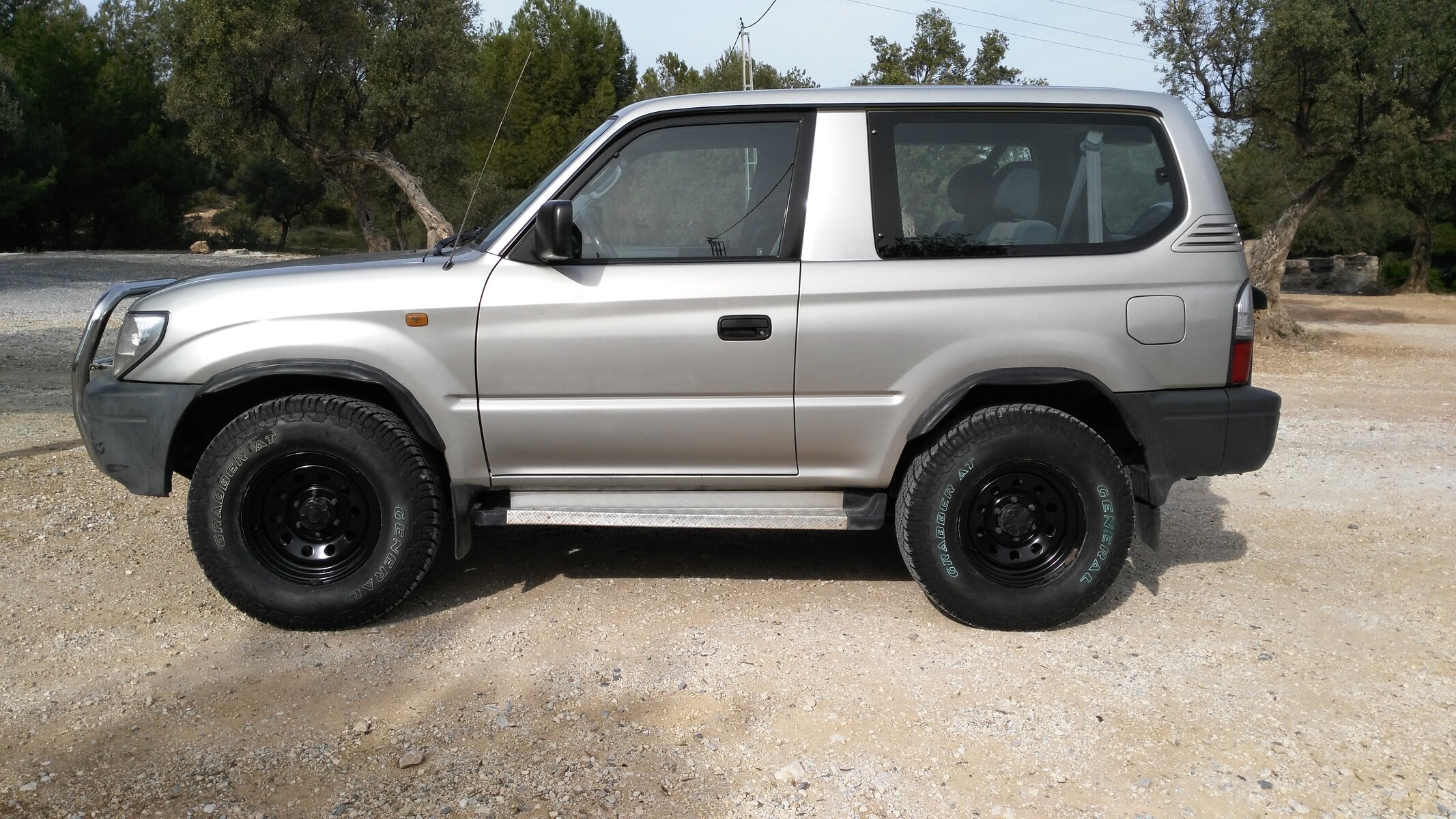

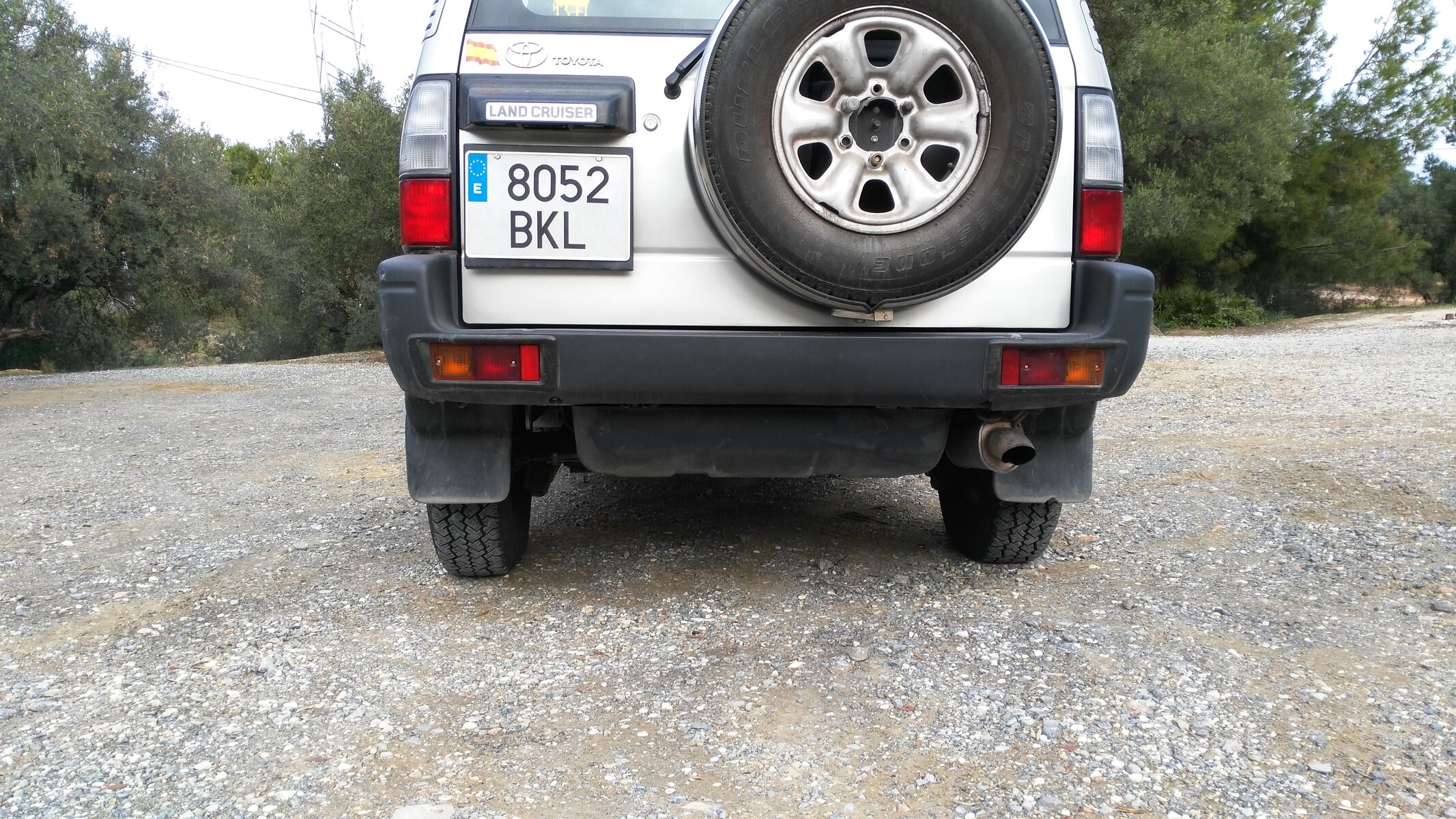

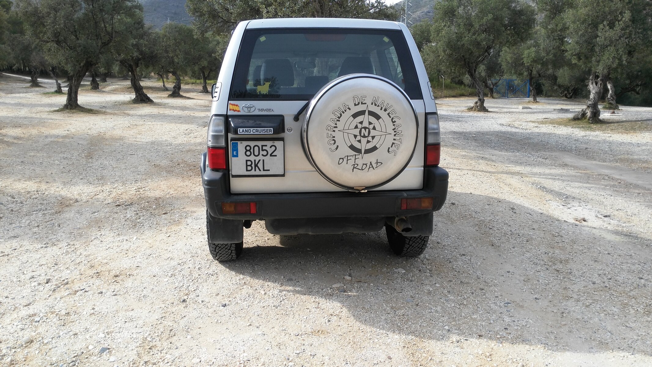

Got around to getting the wheels and tyres fitted. Wheel arch extensions need teasing with a hot air gun to get them sitting nicely.
Tyres are General Grabber 235/85 AT. Wheels are 7" wide, with +7 offset. One of the wheel studs broke, is it possible to buy them separately?
Here are some photos for your viewing pleasure -
IMG_20160121_121533.jpgIMG_20160121_121548.jpgIMG_20160121_150901.jpgIMG_20160122_143726.jpgIMG_20160122_143739.jpgIMG_20160122_143756.jpg
