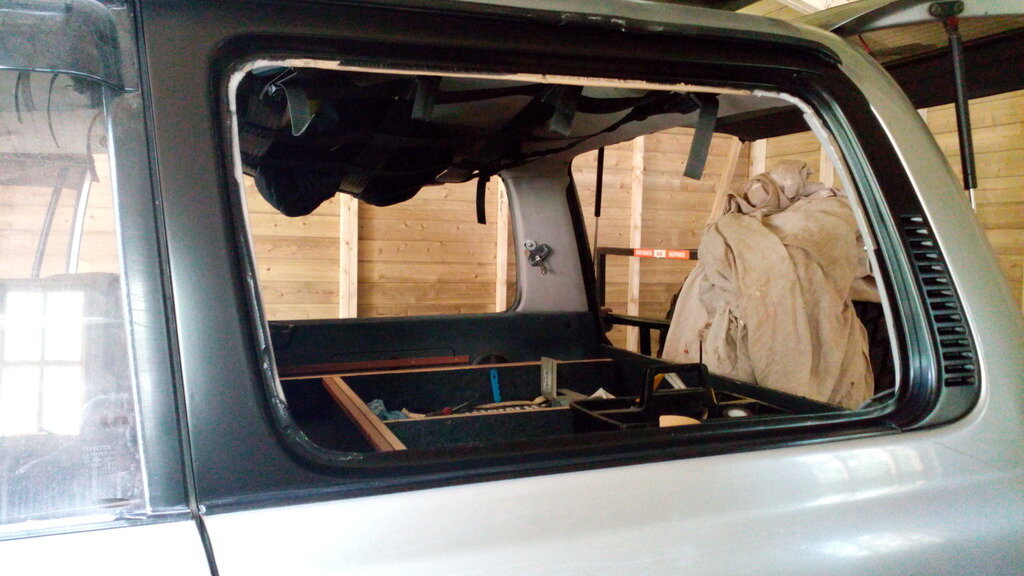

just spent the last hour n half trying to get the paint of the rubbers, I've done one side of one rubber, tedium squared, put them in a bath of hot water worked it as much as poss, tried pan scrubber, moved onto wire wool, it comes up good but it takes some friggin scrubbin! I've got dish pan hands :lol: wishing the amayama order haddn't gone south now :violin: I'll have another go at it tomorrow
a mate in the game is telling me to use gorilla glue for the grills, says it expands and will never come off, if I can get the plastic clips out I may get some to glue em back on, and if that goes well mite try it on the rubber edge, if I can't get the clips out plan B is silicon, plastic friendly super glue sounds good for the rubber edge I'll see what B&Q has on the shelf tomorrow, the screws are rusted up solid but left a plastic cup affair on the grill so a blob of silicon in there should do it in case I ever need to take em off again :lol:
I couldn't find those tools they used on the video to remove the windows, faffed about with two sets of cycle tyre levers for a bit, then raided the kindling bags for apropriate size bits of wood I tickled some up on the bench grinder, worked a treat:dance:
Sounds like you're getting there. I haven't had to remove paint from the rubbers but Brillo pads take the toot off pretty well. Some Nitromors might help lift it if it's that well on there. Not sure what it does to rubber but if it's not on there long I wouldn't have thought it would do it any harm.
I like your tools idea. I'm often raiding the kindling to fettle something or other. I think I used a but of kindling as a punch to create the clearance for the bottom 'step' in the gullwings that is just a tad too close otherwise.
Gives a good chance to treat the rust in that area. Chris was reporting getting water in the seal from who knows where so I still reckon the Butyl screen sealer is a good bet, especially on lazy old rubbers.
Keep up the good work, I'm looking forward to photos of the finished article. :clap::icon-biggrin:

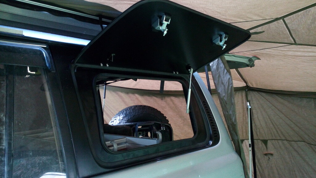

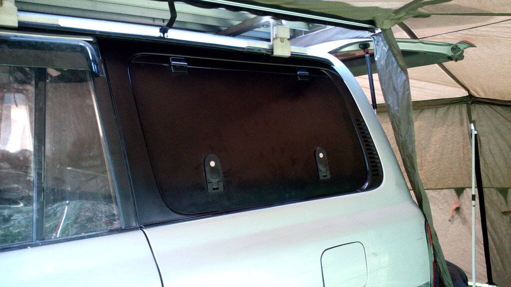

All done, went much easier than I thought it would in the end, really pleased with them, quality work Rich, well done :thumbup:
Thought it might catch the awning, nope, it's just right:clap:
Great stuff Pete. That's just the way I designed them to miss awnings :whistle:
