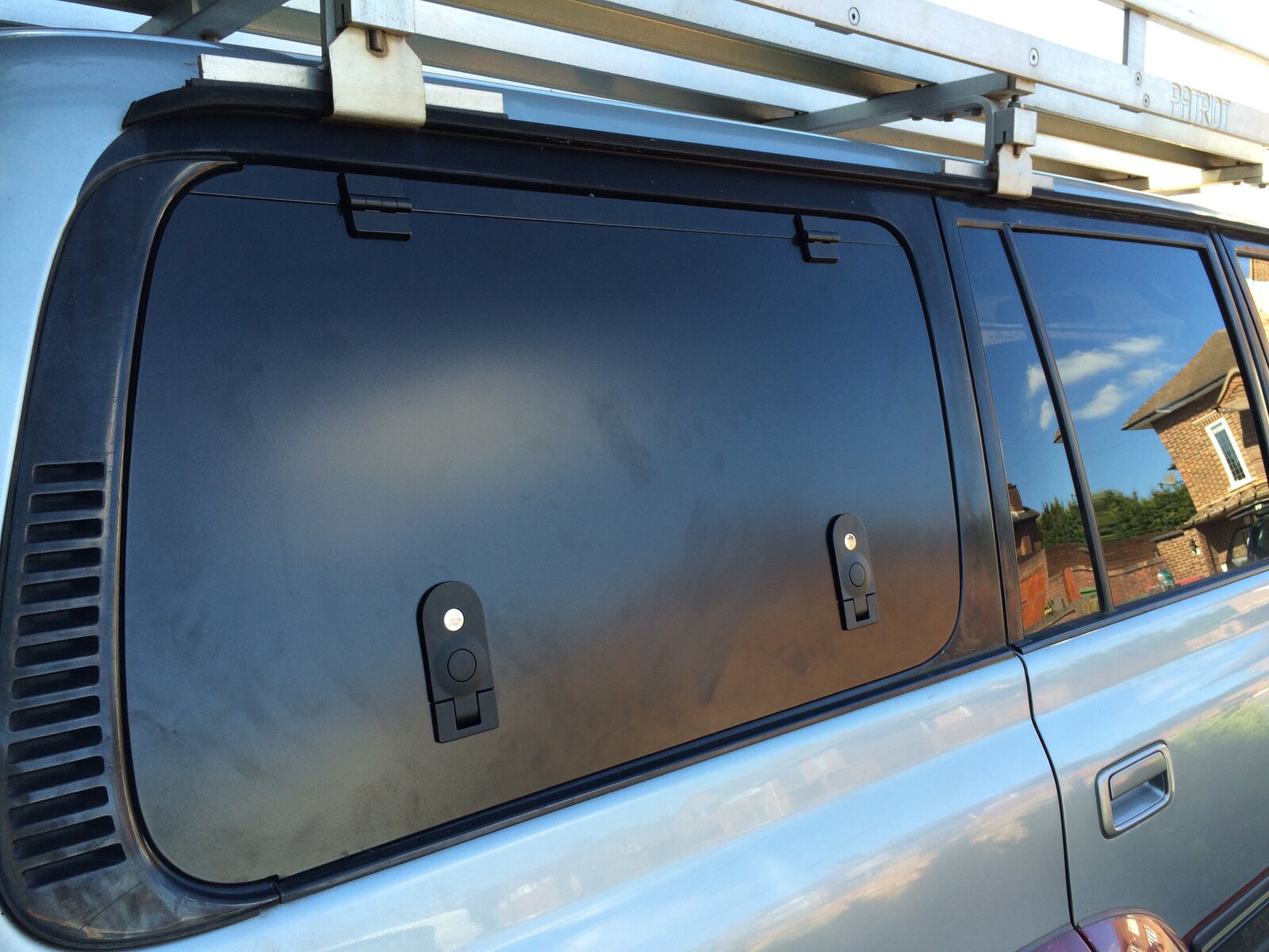

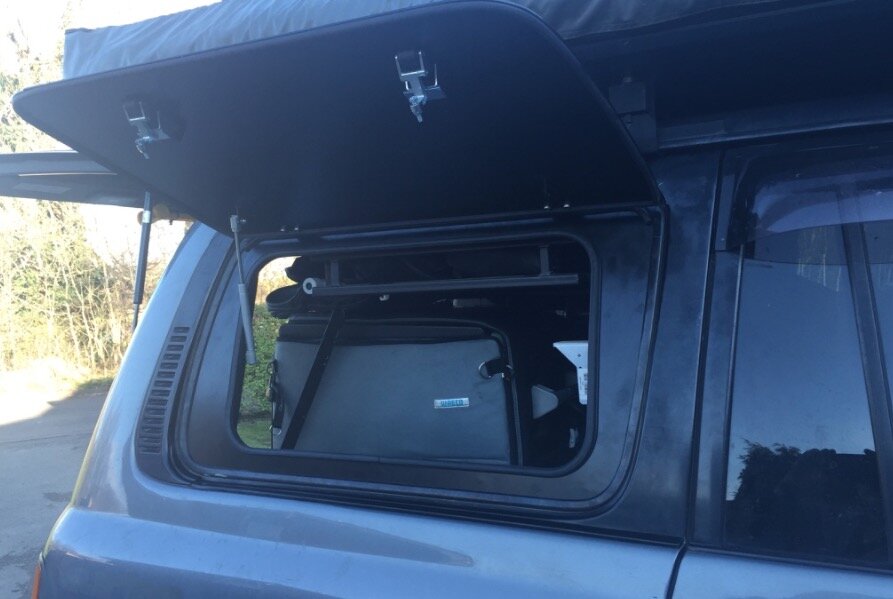

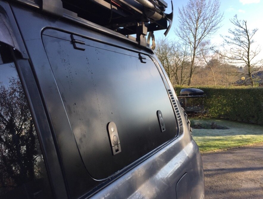

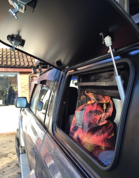

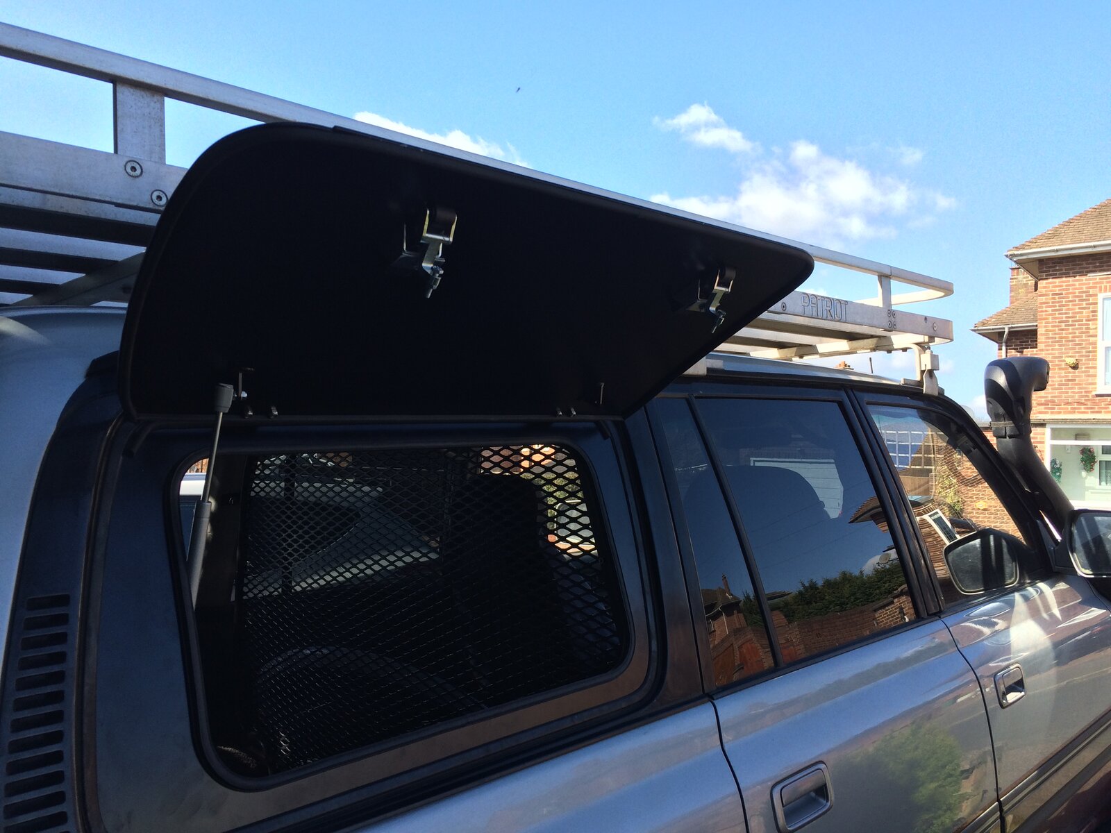

I was like a little child Friday morning when I went to pick mine up from Chas (thanks) As promised here is pictures of my install.
They are great thanks Richard.
Lookin' good Paul. Glad they went in ok. [emoji4]
Good things come to those who wait; they look even better than I thought they would turn out.

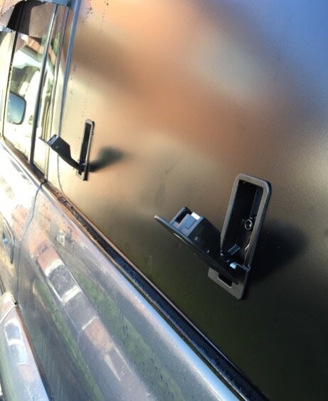

Words not really necessary other than those to congratulate Rich on some outstanding fabrication.

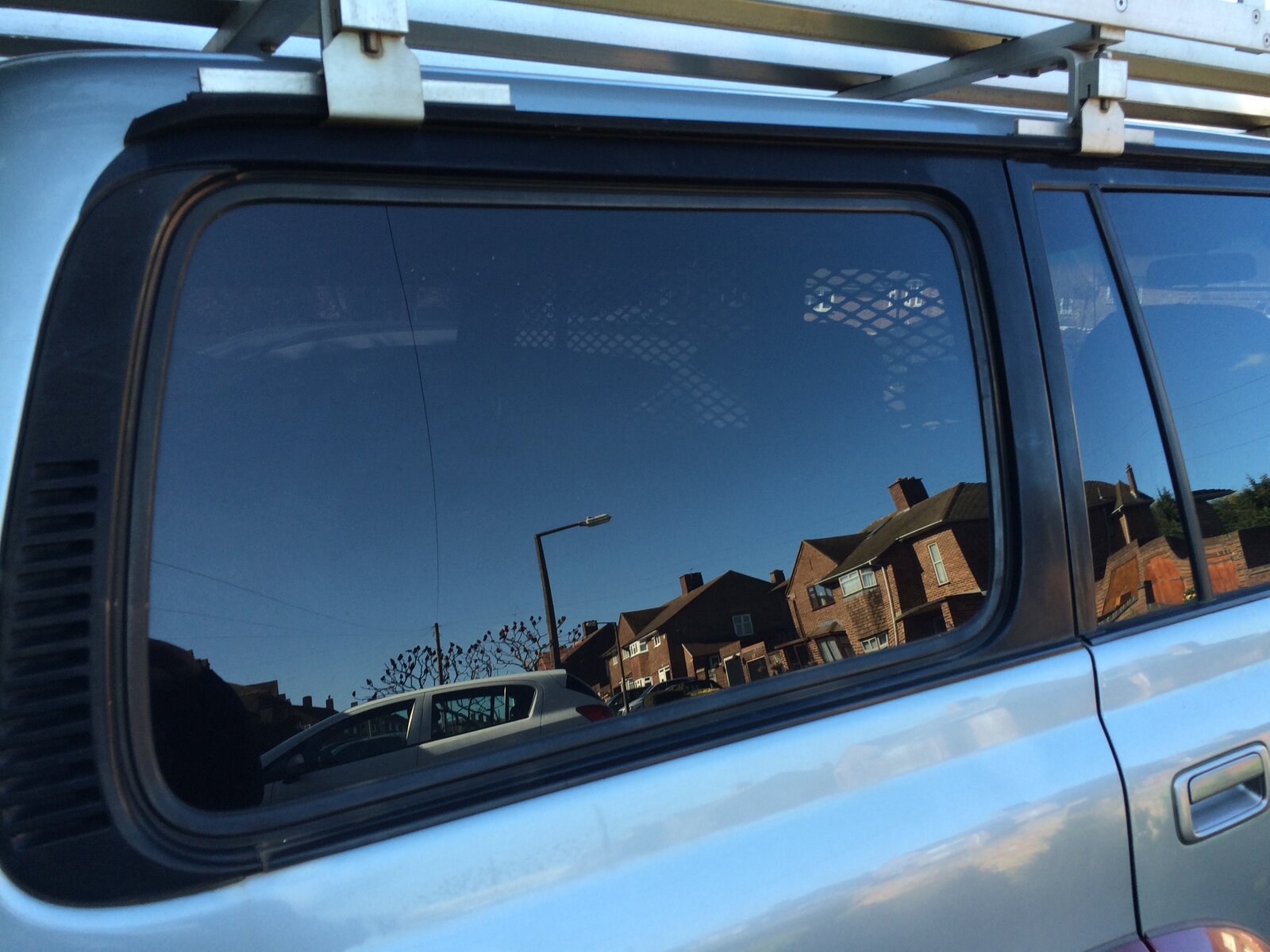

Screen Shot 2016-03-31 at 15.13.44.jpgScreen Shot 2016-03-31 at 15.13.55.jpgScreen Shot 2016-03-31 at 15.14.04.jpgScreen Shot 2016-03-31 at 15.14.50.jpg
Looking good Chris, and thanks for your words. Looks like yours and Paul's were both fixed window.
They look great, well done getting them made.

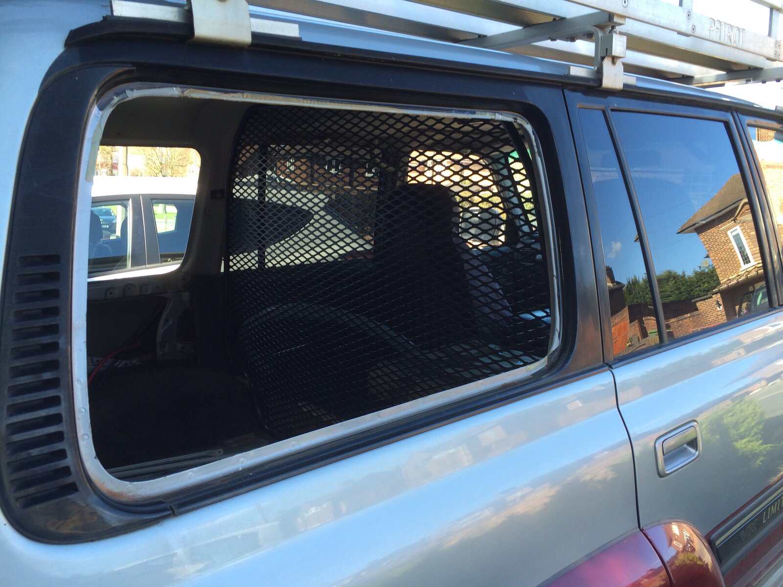

Not long at all
Getting the window in took less than 5 minutes
Bottom in push window and pull cord round
Getting old window out was longer because my cargo system was in the way
think I may have a similar cargo system issue, is there a knack to it?
I've used plastic window packers but something without their ridges would be better. About half a dozen is all you really need. I used a paint scraper with a bit of gaffer tape around the blade to soften it to get things started. The main thing I guess is perhaps only having access with one arm at a time when using two hands is most useful.
Fitting can be done from the outside through the aperture without too much trouble.
