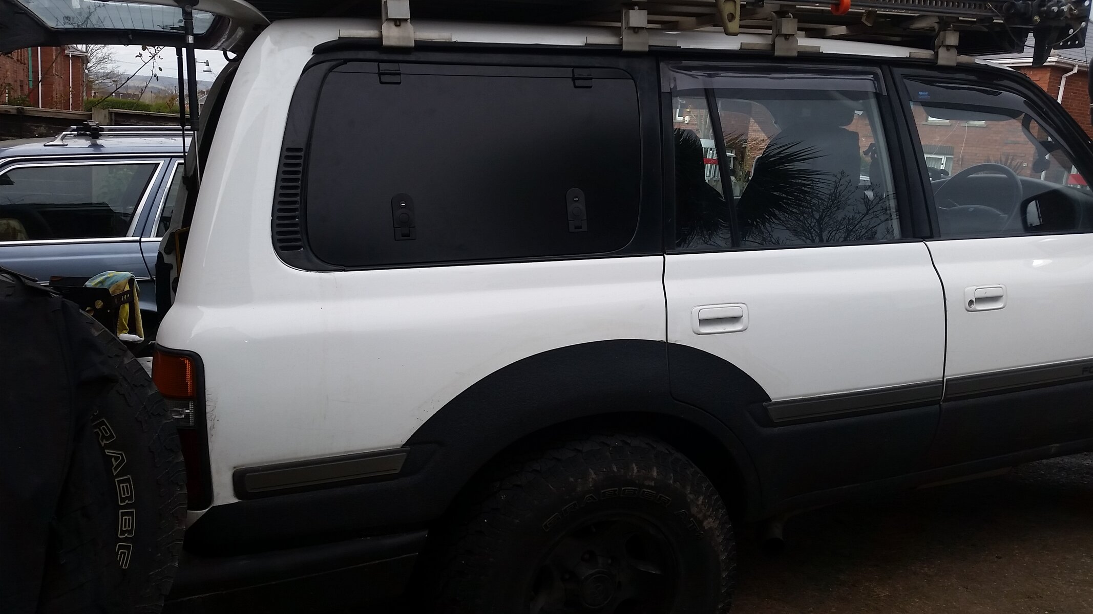

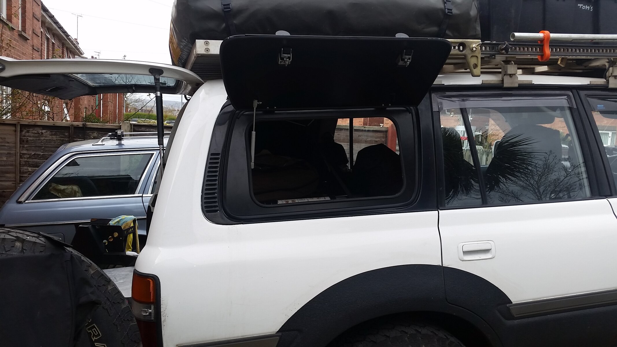

Fitted and looking great. Better than expected. Cheers Rich
Thanks Tom, they do look great against the white of your truck. Yours were sliding windows, did you use black tape on the plastic grille trim?
They look spot on Rich. Perfect job. Well done.

Thanks Karl.
The rubbers get reused, the glass is surplus or retained on the fixed setup. On a sliding set, the complete unit with rubbers is replaced by the gullwings.
No i didnt really understand what you meant by the tape Rich. It all went in great and fitted exactly how the windows were.
It was just to cover the join between the plastic vent moulding and the paintwork. As it happens, Mr T has made quite a nice job of it anyway. The main thing is that you're happy with them as they are so if you don't need the tape it doesn't matter.
