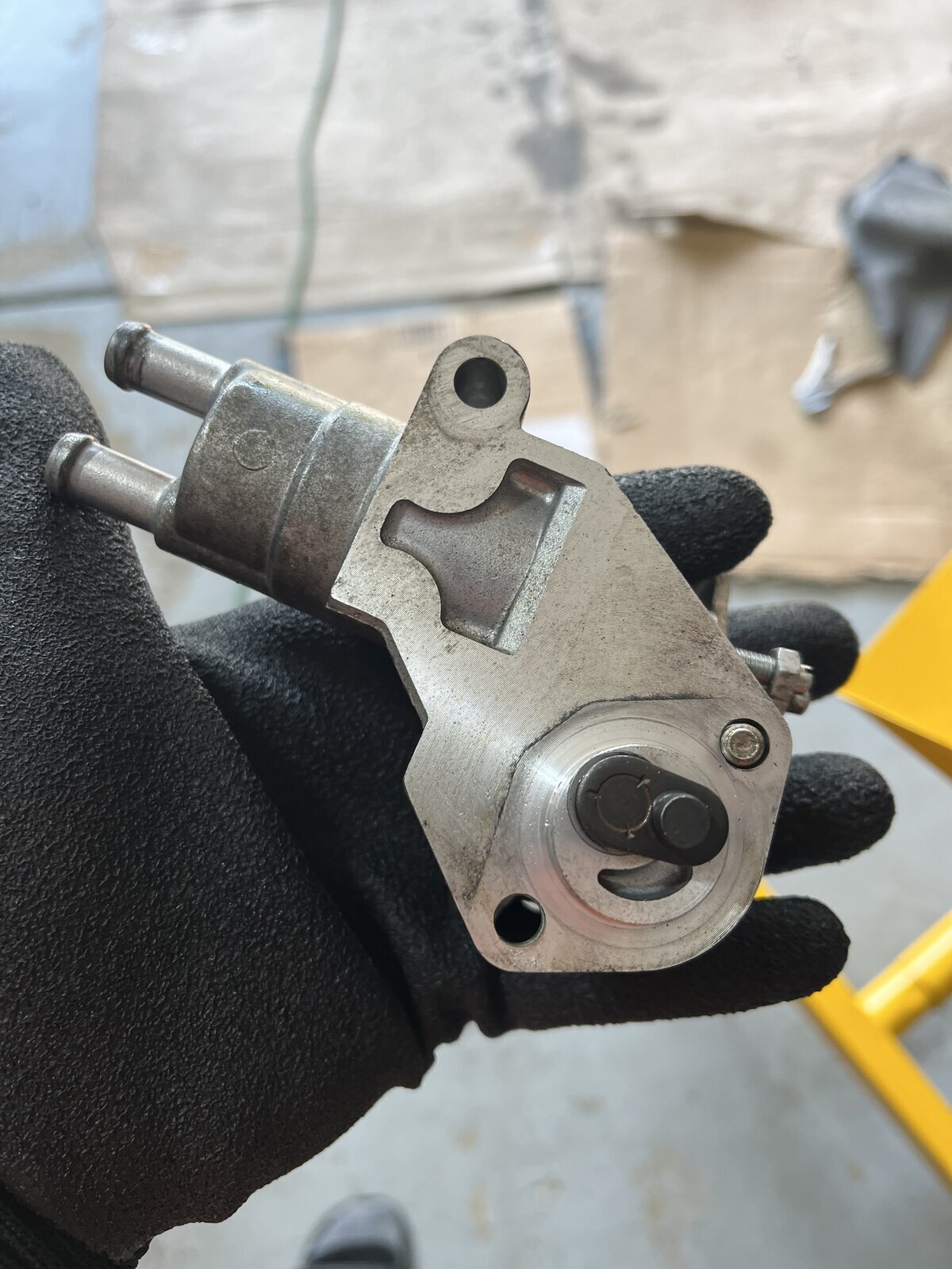

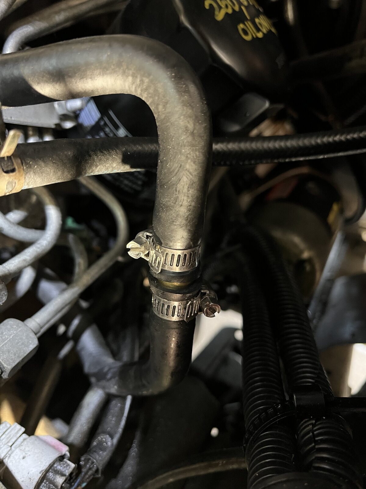

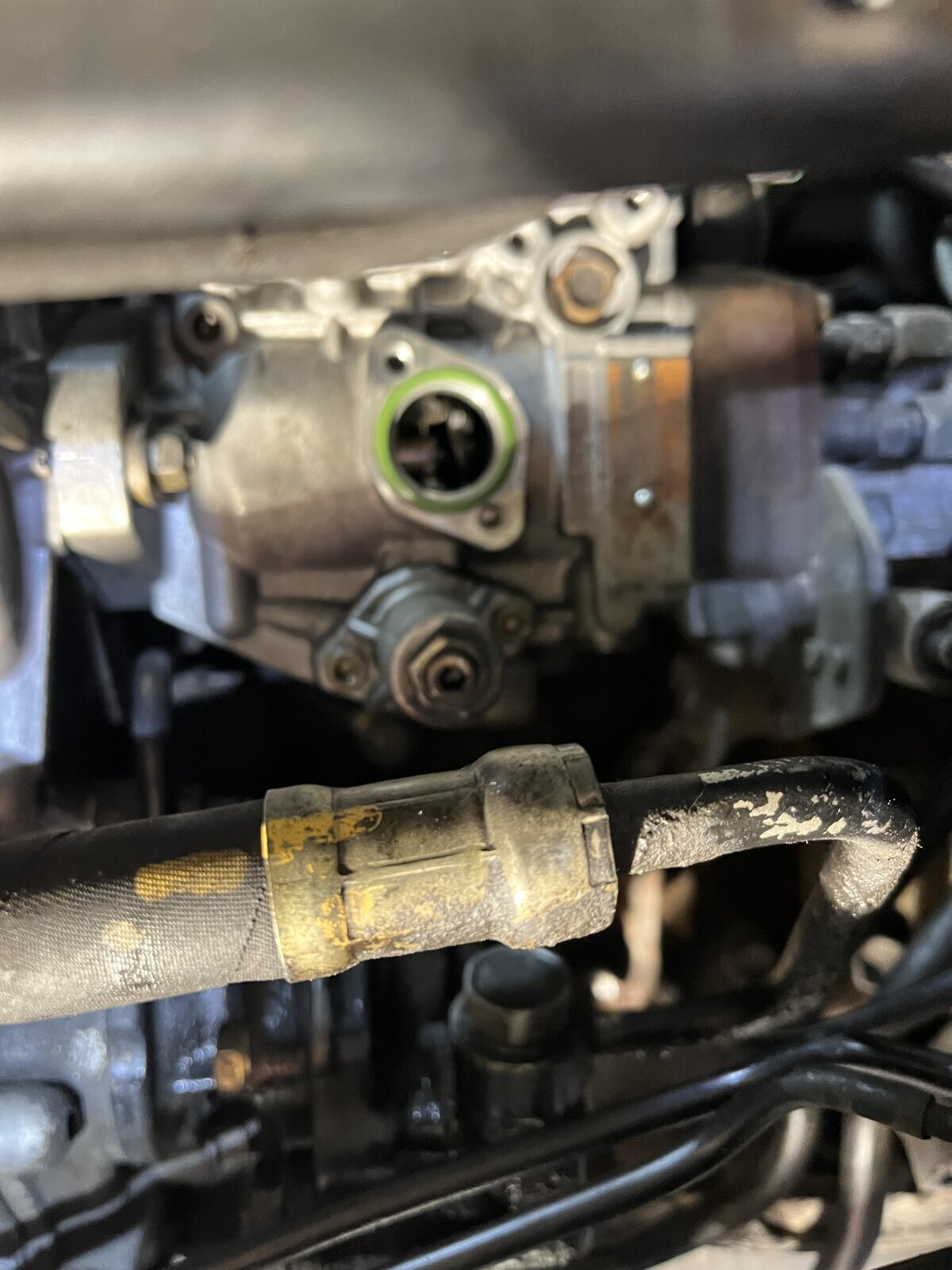

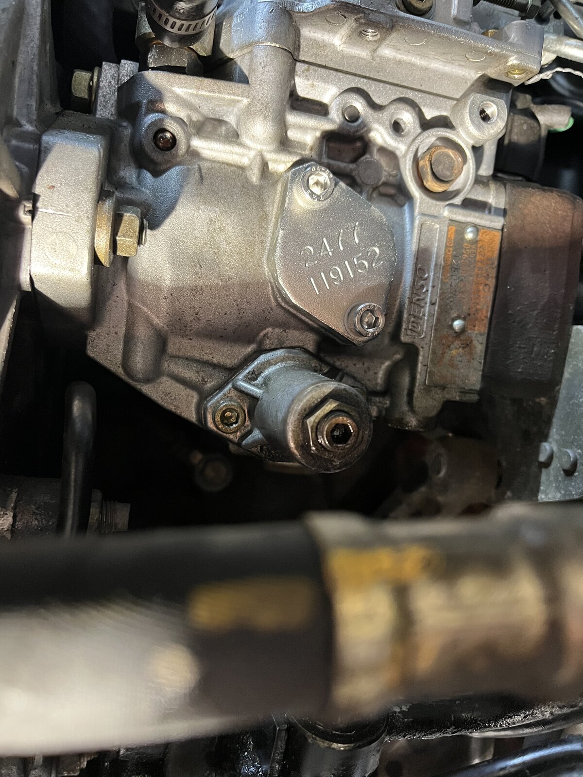

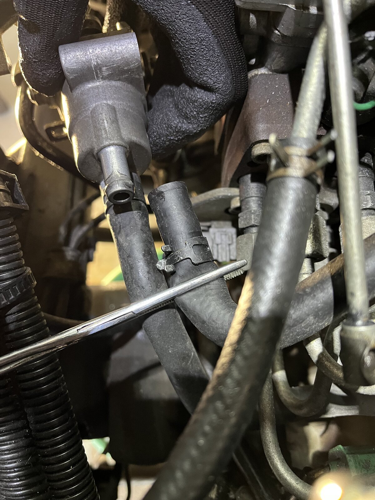

I removed the ACSD from my 1 HDT equiped 80 series.
After research, apparently the ACSD could cause some serious issues to include destruction of the IP. It was a fiddly job with tight spaces and small parts. I used the delete kit from Back40 imports. I also purchased some new SS hex bolts (M6x12) from a local hardware store for the delete plate and they fit perfectly.

When the issue of scored internals on the IP occurs is when the pin on the lever of the AC/DC becomes worn or loose and this loose item will result in a knackered unit..
It is indeed very easy to fabricate a cover to replace the ACSD but also you need the right length of allen key bolts to fix it on.
If the bolts are too long then they will jam against the rotating drum on the inside and if too short it will strip the threads of attachment.

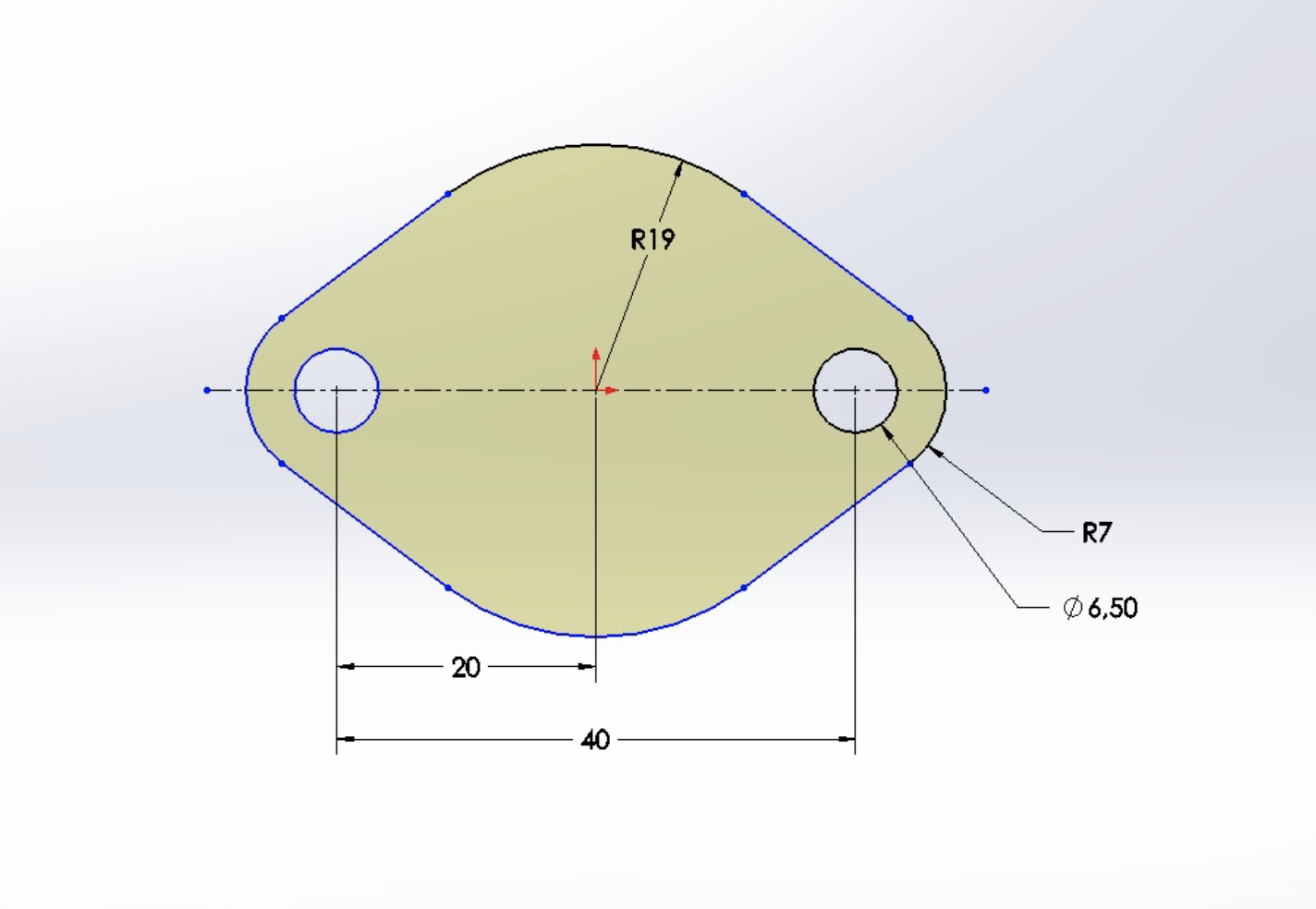

Found this on Ih8mud, may get some laser cut when I'm back in the UK. Anyone else interested?
I think the blanking plate is used on numerous types/makes of pump. I got one FOC from a local diesel specialist. I took in a photo of the blanking plate and he had a box full of them.
