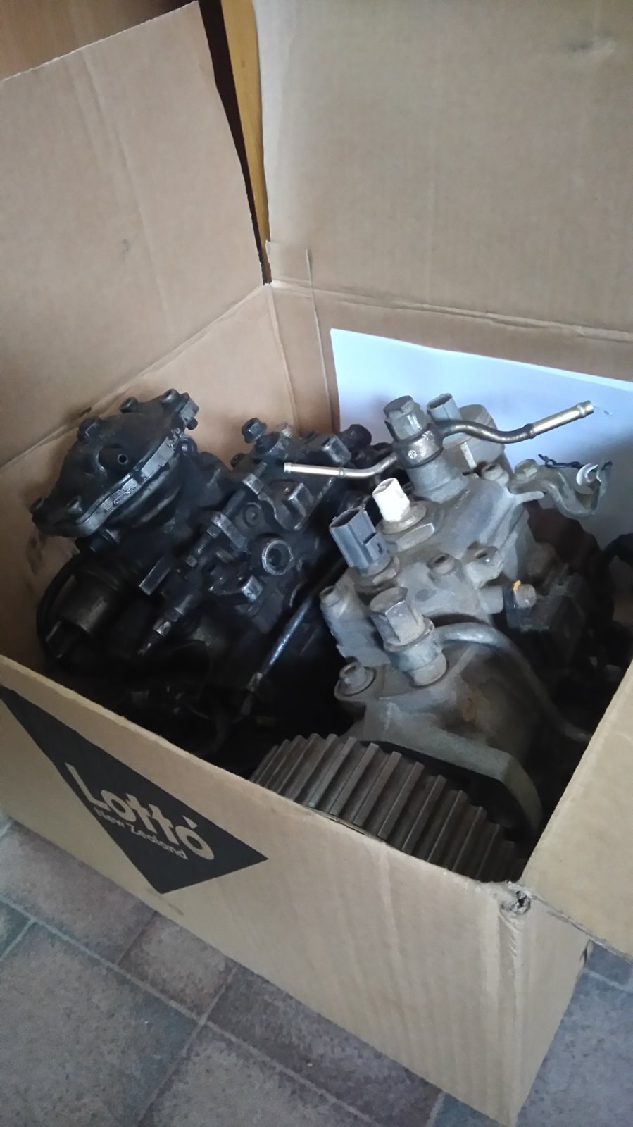

Just picked up my doner fuel pumps for kaiapoi repowers. I'll be in the South Island in December so I'll drop them off then. Its a 1kzte pump and a 2lt. I'll be back home in Febuary/March so a while off the install yet. I'll also need to make up a new accelerator cable but Cori from Kaiapori has assured me there are cables from other toyo trucks that will do the job.

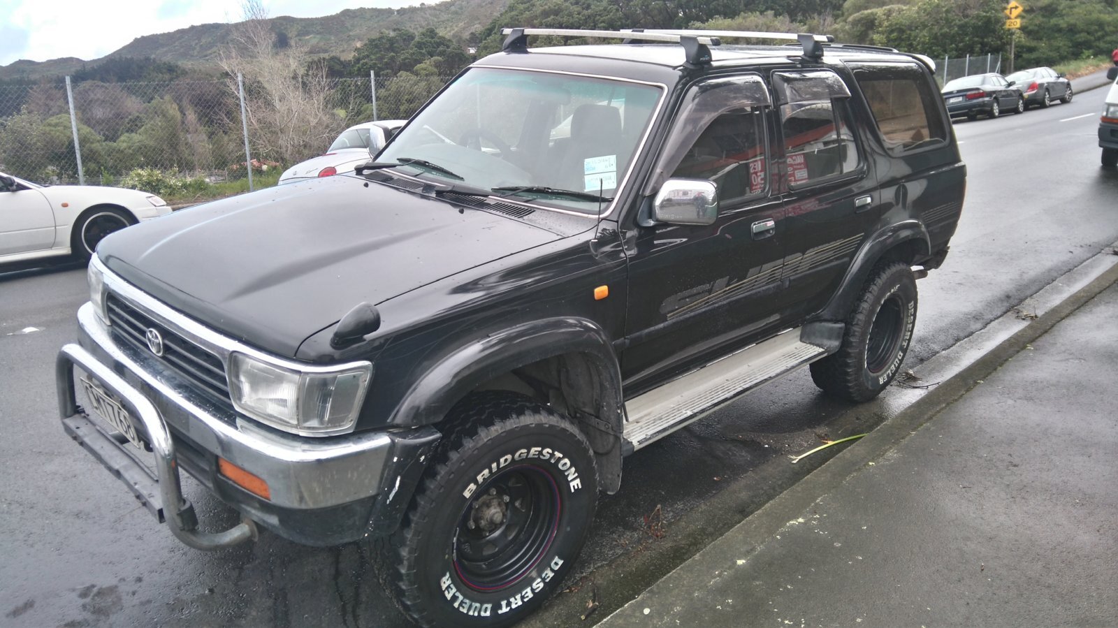

In other news I have picked up a Surf for our last leg of tripping around NZ. I am well jealous of them over here, no big deal having a 4WD or big diesel/petrol engine over here. They are cheaper to own and everything is high spec. You can pick up some superb examples for 3-4 sterling/euro.
I have an Xrox winch bumper on the way home and also a few other mods, its just so easy to pick them up over here that I just had to. Also inspired by the amount of modded Prados/Surfs and Landcruisers grunting around the country so plenty of ideas for when I get back ;)
