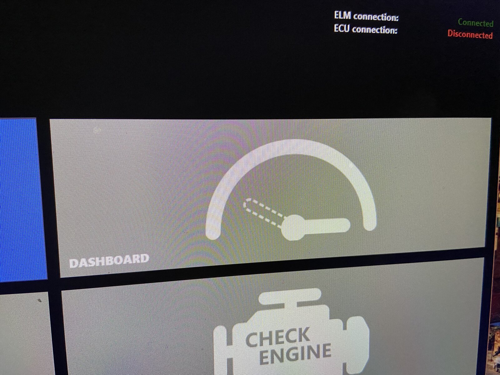

hand held multi car obd2 readers only work on 120s around 2006 onwards , you will need toyota techstream to plug in cost about 20 euros on ebay , techstream covers all parts of your 120 .Ok guys
I tried like tony said but i cannot open my car with key. Key not turn right . Only I can lock door with key.
I connected obd2 and tried to connect but ecu not want to . See image
I tried connect obd2 with my bmw and works fine so I don’t know what is going on with land cruiser.
So your key remote doesn't work either?I can only lock with key
