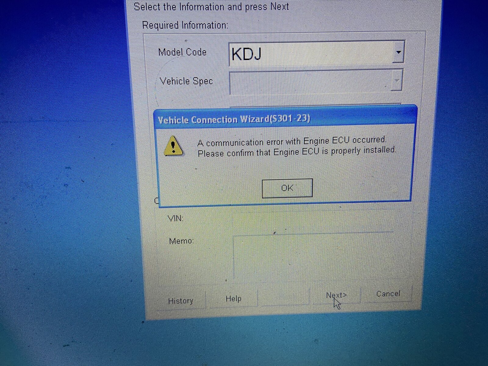

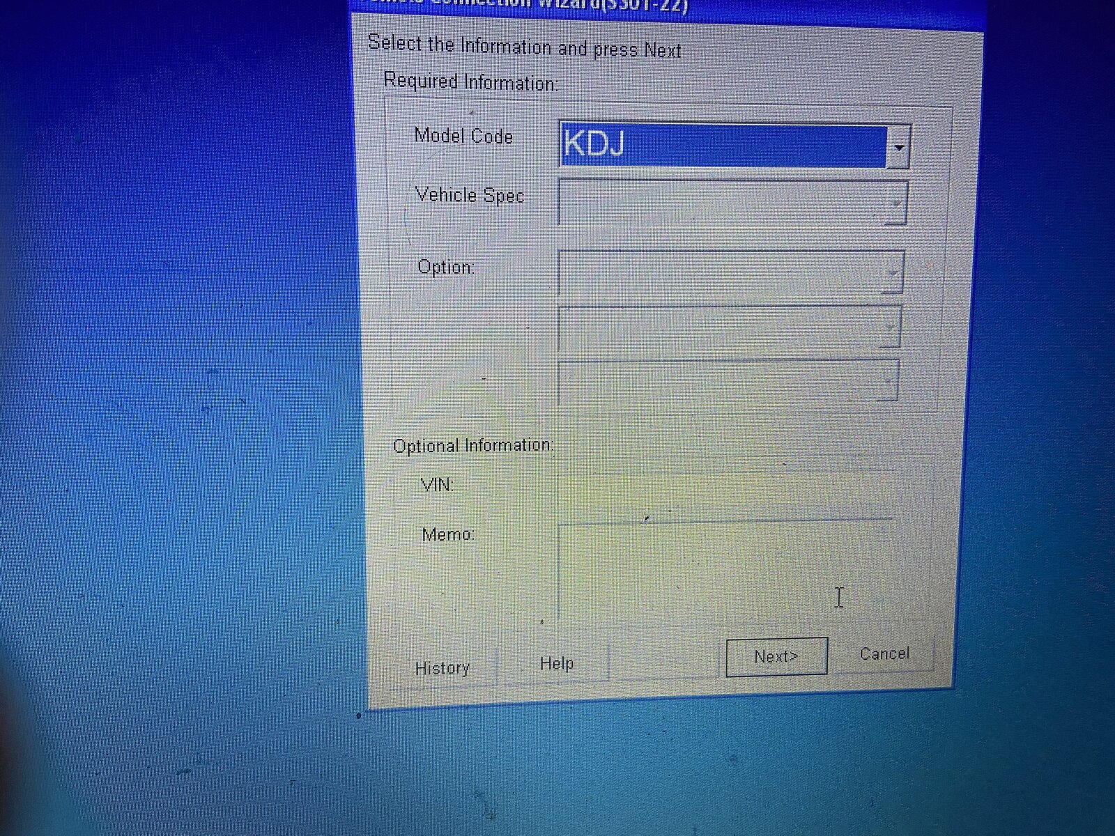

I connected obd2 and checked connection with obd2, it was correct , and ran techstream . Program not found my vehicle . So I chose manually kdj cause I checked model and this kdj120. But I got error

If you are going to put car in manually after typing 1KJ on the top box on the next box down where it says vehicle spec type in 1KDFTV and then below the year and month specs of the 120s and 150s should come up click on you month and year . then you should get into the system for use
