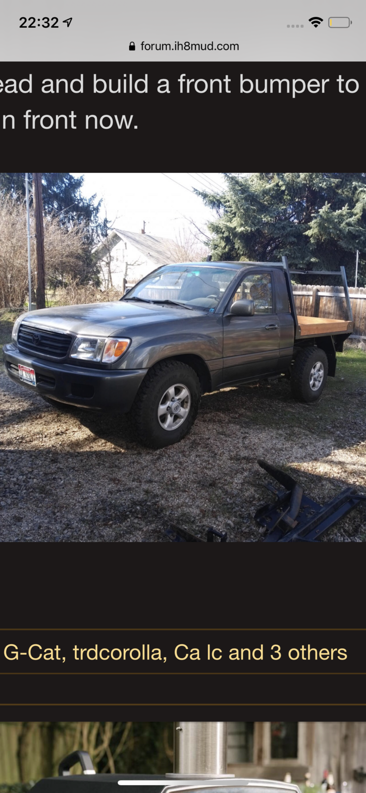

so few years back my mate Barry from Portsmouth chopped his 100 into a double cab pickup, think it ended up on eBay a few years ago. I always thought it was cool.

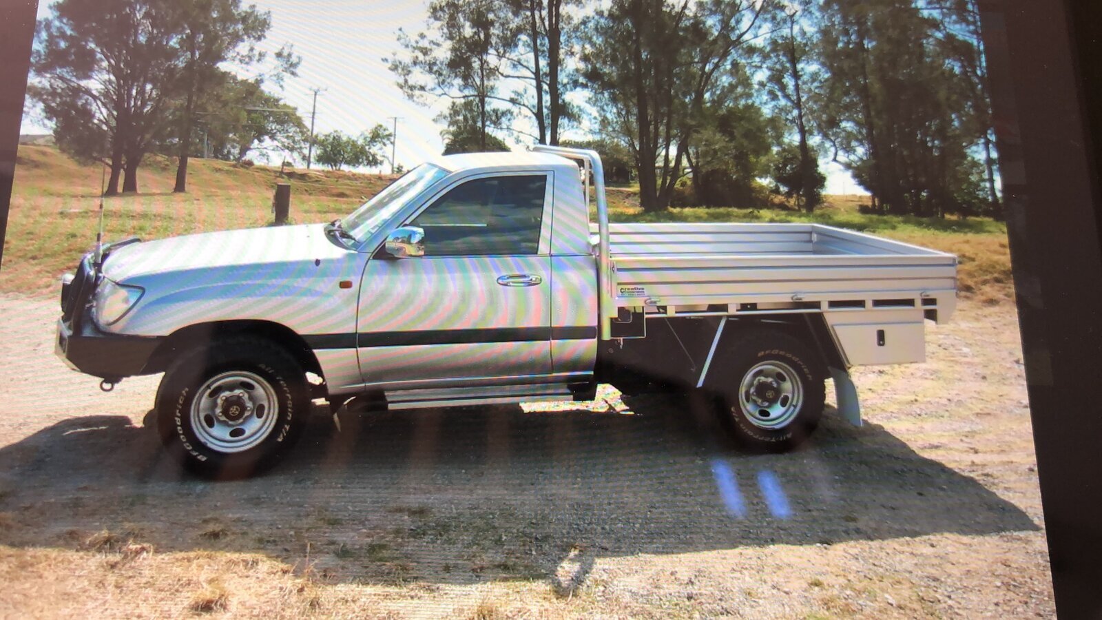

more recently been sent pics of another one that been done as a single cab which is also really cool and that’s the way I think to go.
Just wondering if any of you on here have done it?

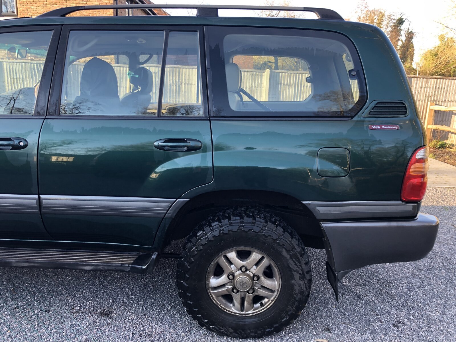

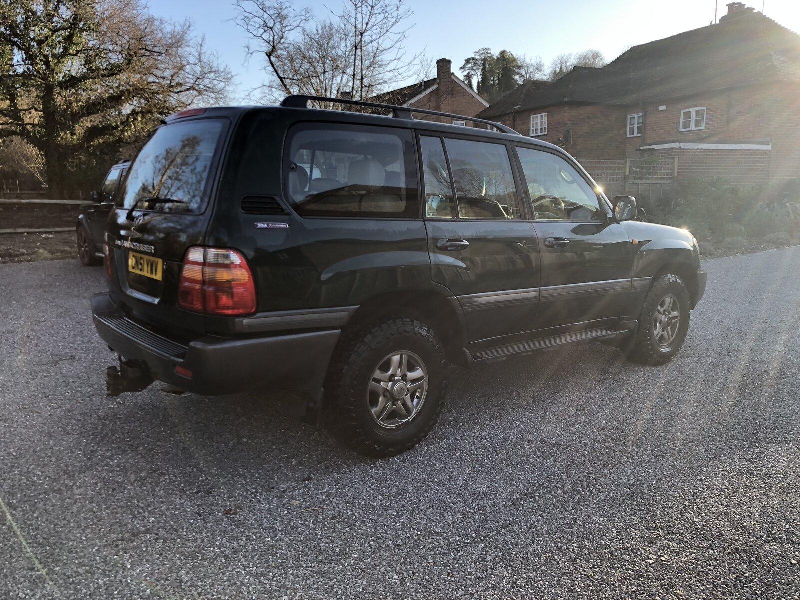

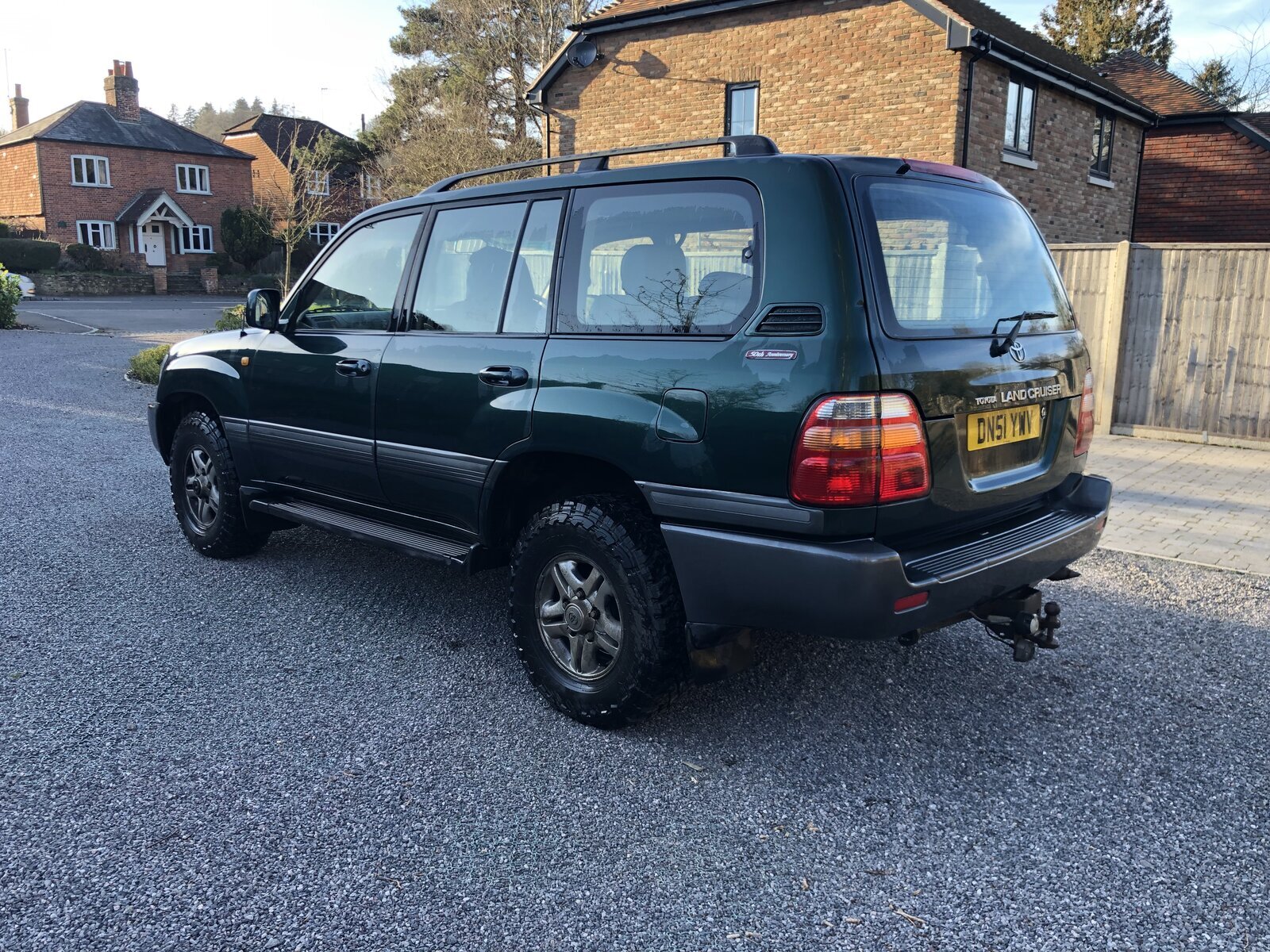

the car I’m going to use is a 50th edition 100 series 1hd fte
the rear of the sills inside and out are a bit rotten now at the very rear, so chopping will mean I don’t have to worry about that, so another bonus. Also the car has a water leak from the sunroof, so again il be getting rid of that too.
The car has also done 330,000 miles, so it’s pretty tired. I just think it’s the perfect candidate to chop into a pickup. It also means I can sell my hilux.

Im sure you've already looked but Google images have a few 100 series utes, And there are a few 80 series pickup/ute youtube vids... Cant find anything regarding 100 series... But i bet they are on youtube somewhere...... Crack on :thumbup:
Thanks for support lads, il shall start to make a plan going to see the rear body hopefully next weekend, I got the choice between double cab and single cab Vw body, so need to have a measure up, I quite like the idea of the bed having no overhang at the rear, might sound odd but there’s a really cool patrol one that’s just been finished
your right about YouTube lots of 200 and 80 and gu patrol Ute / pickup conversions but only a few images on there of double cab 100 pickups.

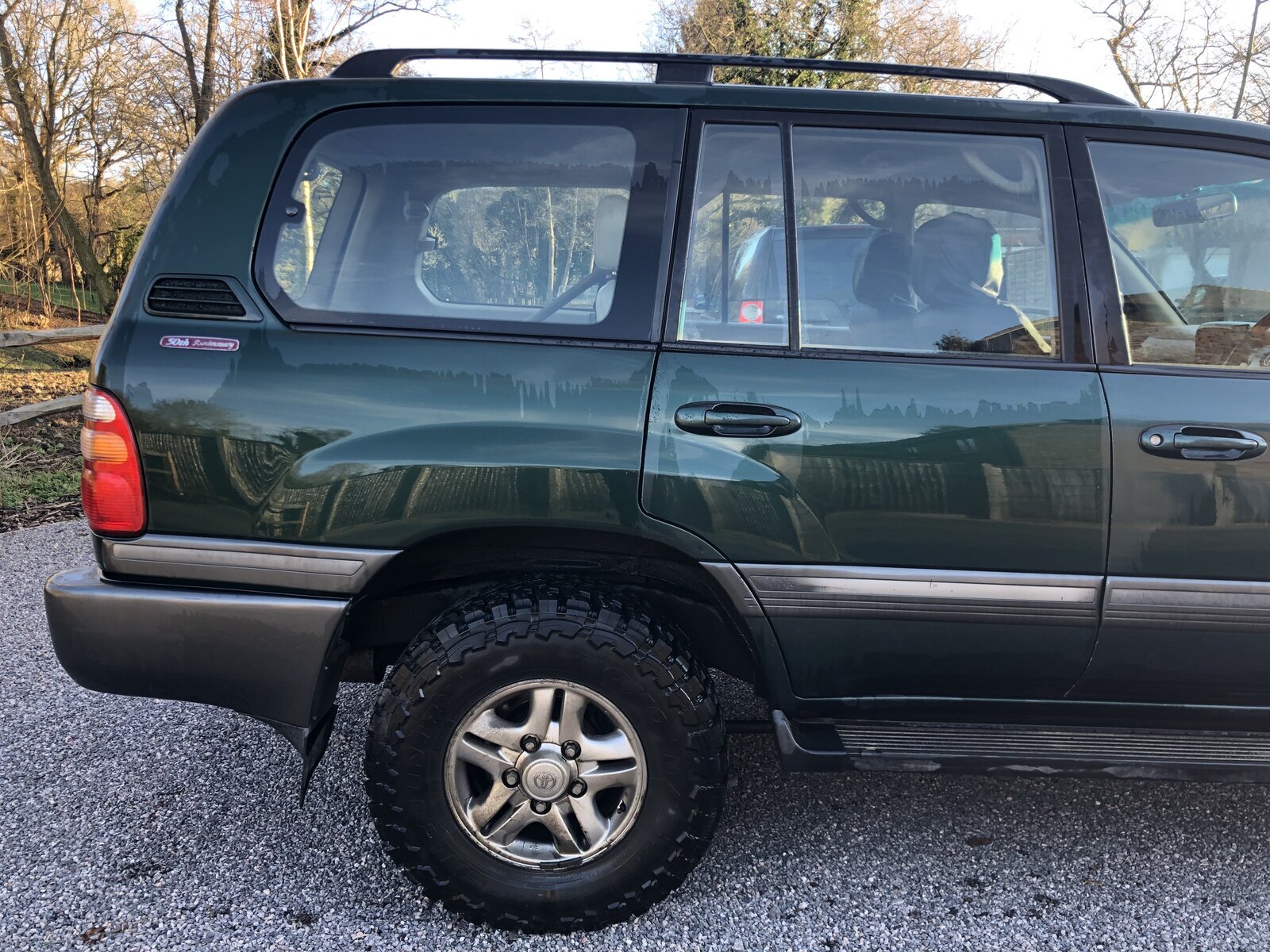

This is the truck I’m planning to cut

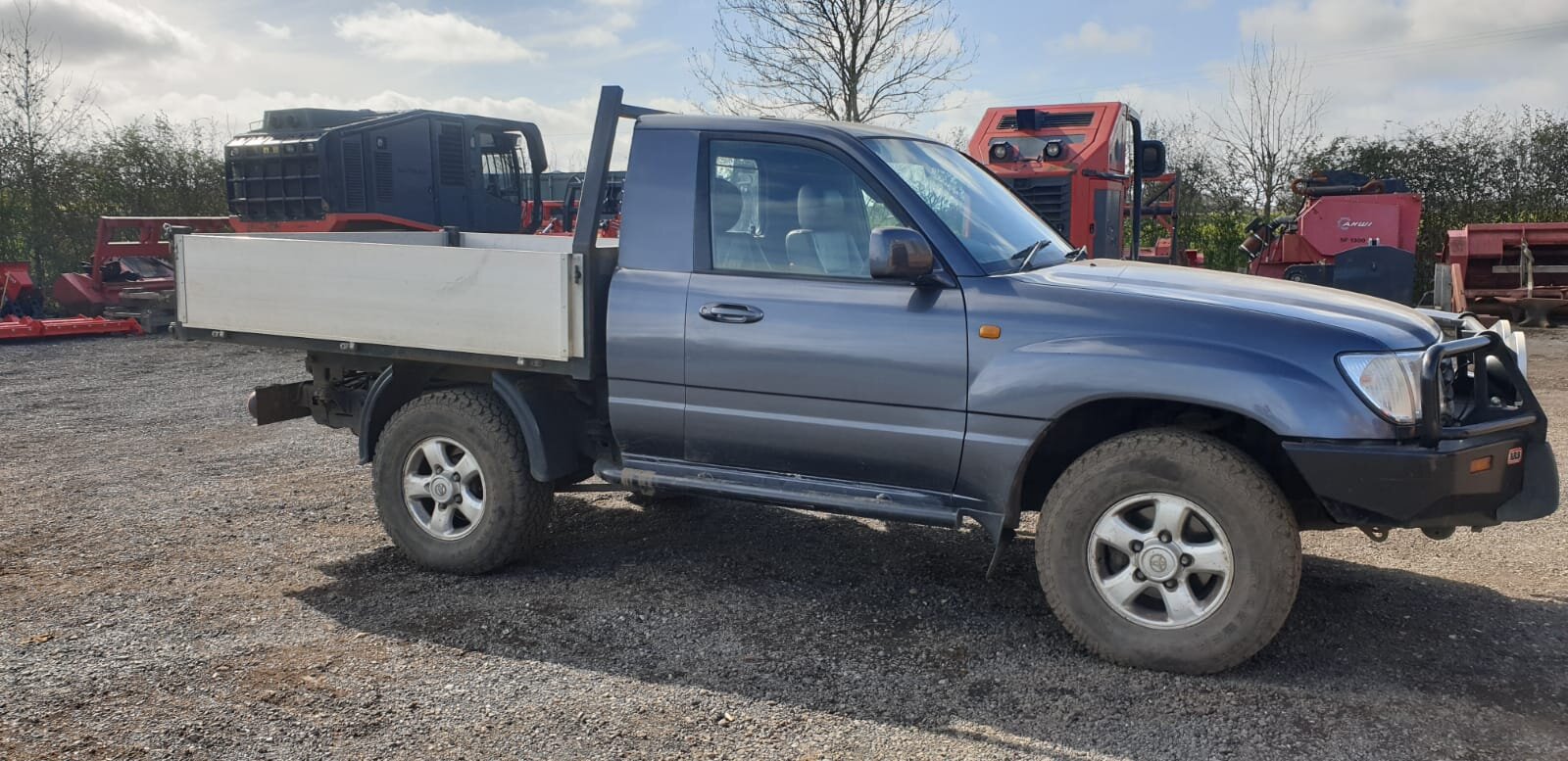

What your opinion guys, I’m going for a single cab, using the body from a Vw drop side transporter, there quite cool looking body’s if you’ve ever seen one. The body I want to have same length as current rear bumper, so there not loads of over hang at the back.
