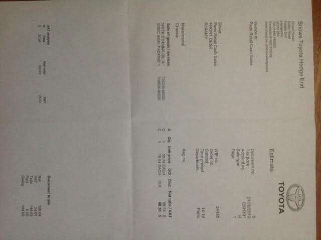

I have the 3.4 V6 Auto and was going to do the filter in the autobox until I got a quote from Toyota. I couldn't find the parts anywhere else. The filter (T35330-600200) and tube of sealant as they don't have a conventional gasket (T08826-80020) were £59.74 and £60.30 plus VAT making a total of £144.05! I decided to just change the fluid. Attached pic of the quote but it is poor quality.
