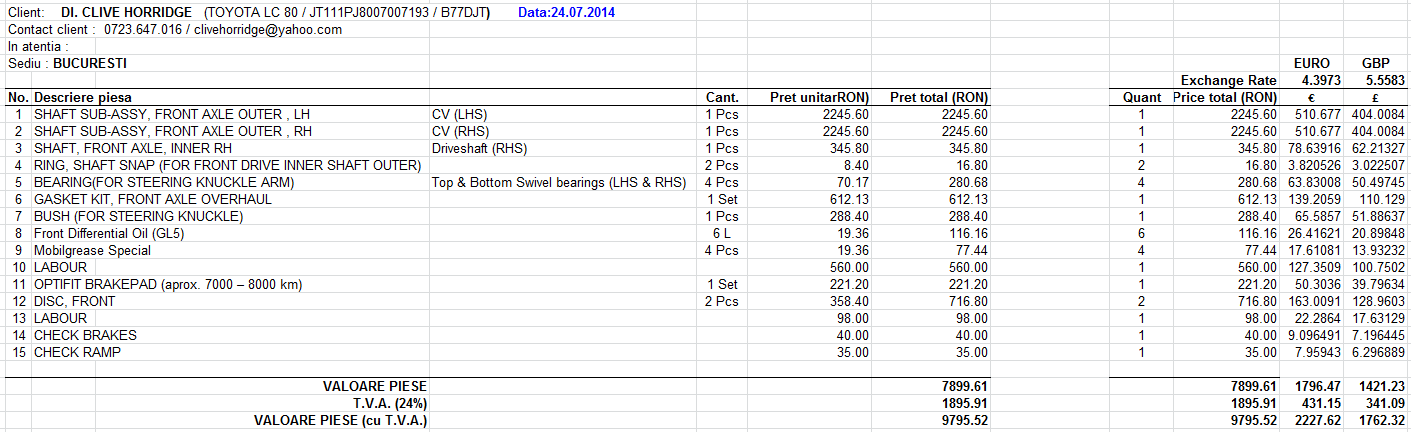

All in, I'm going to have new driveshafts, wheel bearings, (maybe CVs they called something "outer shafts"), swivel bearings, brake discs, pads, oil seals, wipe seals, new oil, grease etc. etc. including labour for appx 1,800 GBP

Well I hadn't understood the quotation very well, in my rush to report. Here's a more considered translation...
New RHS Driveshaft, new CVs (but not wheel bearings), new swivels, discs and pads, and the usual rest...

OEM CV's this time Clive?

I truly hope so, at that price!
The CVs fitted 7 years ago were very cheap, but they've held up well. I haven't abused them but they've had some hard work to do.
I thought that was cheap for Toyota cv's, a lot less than I was quoted here a year or 2 ago!!

ps, also like the labour charges!
... yeh I have a couple due to go in soon, not many people opt for OEM CV's. HDK being the common choice, with good and bad experiences.
For an overlanding rig I think it's a safe choice, let's hope the return matches the price!
Andy IIRC UK dealers will want 800ish for one CV. Even the guy at the counter couldn't believe it.
Andy & ajnabi...
I don't know what make these will be. They are not cheap, but as you have said, not Mr T prices.
I'm interested what make they will be and can't find out till Monday. :think:
Yep, less than 300 quid labour for a front axle strip down and rebuild and the brake disc replacements can't be bad, can it! :dance:
Clive, I got mine around the same price, from abroad, so they very well may be OEM. That's what I was thinking anyway.
