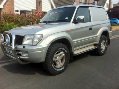

I ended up getting some 265/75/16 hankooks, I like them and they aren't that noisy. They look good too, next is wheel repaint (DIY style) and spacers. :)
