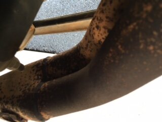

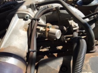

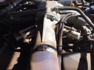

Can you post a picture of the 3 Y pipe and explain why the extra 2 injectors

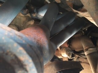

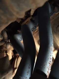

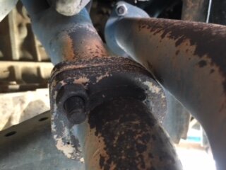

I grabbed some iPhone shots for you mate, not sure they are decent quality but hopefully shows what you want to see.
These injector pix show the two extra ones placed at the cross-over pipe to add the required amount of fuel into the system to keep the AFRs right with the extra air pumped in.

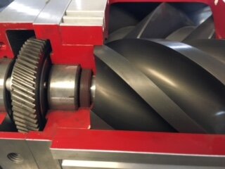

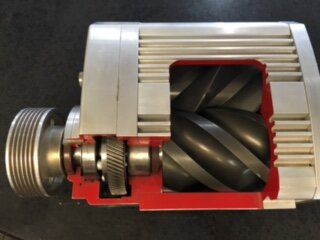

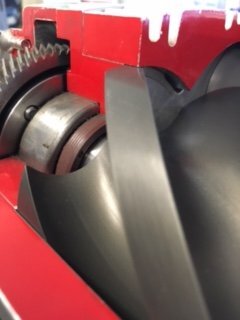

I still have a cut counter display unit here which has been cut away to show the internals.
The engineering and machining is just beautiful.
This is a smaller model to suit Mini's and Harleys.

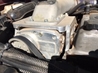

Craig, this is the Sprintex unit on mine. Genuine product made here.
I'd be checking on the background and quality controls of any third party manufacturing of any product that can potentially shove metals bits inside your engine.
It often has a less than desirable outcome.
The other important element is solid mounting and pulley alignment of course.

Cover your eyes from this filth!
Yummy precision engineering, at its best :thumbup:
