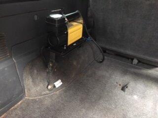

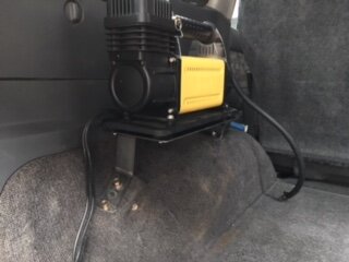

With the front half of the drawer system removed, I have to find somewhere for my second air compressor. This one fills my twin air tanks and is for quick tyre inflation, so has to go back in.

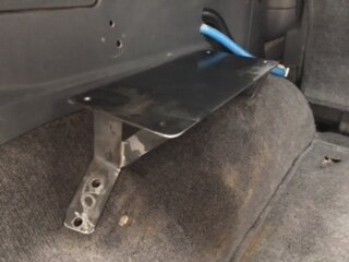

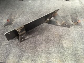

When the cut down drawer system goes in, it is the full width from arch to ach across the floor, so I have made a neat little mounting tray for the compressor to bolt to above the wheel arch.
The switching is still operated from my overhead centre console via a heavy duty solenoid and 25mm wiring from the batteries.
Theres plenty of room for ventilation and I can still use some of the side storage space.
I'll get it electroplated and powder coated before bolting in and wiring it up again.

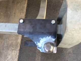

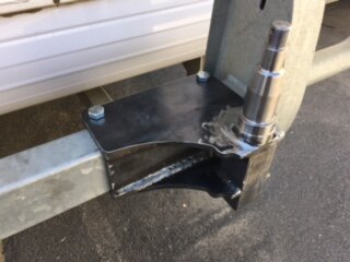

Our van has a rear bar with one fixed spare tyre on a bracket.
I am adding a second spare plus bike rack, but as there is nothing 'off the shelf' I've designed and making one ourselves.
First per these pix is the swing arm system for the second spare.
It has to be on a swing arm as there is an access door behind the position which must be opened to access the split system air conditioning unit.
So a quick scribble in CAD and it was off to the laser cutter, then we started to put it together.
