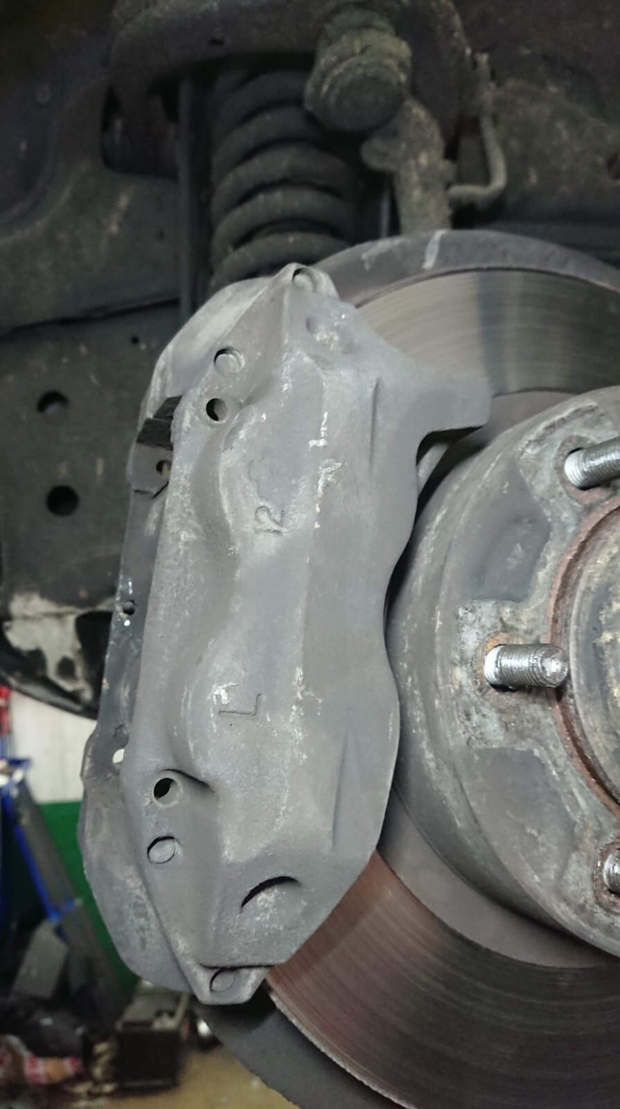

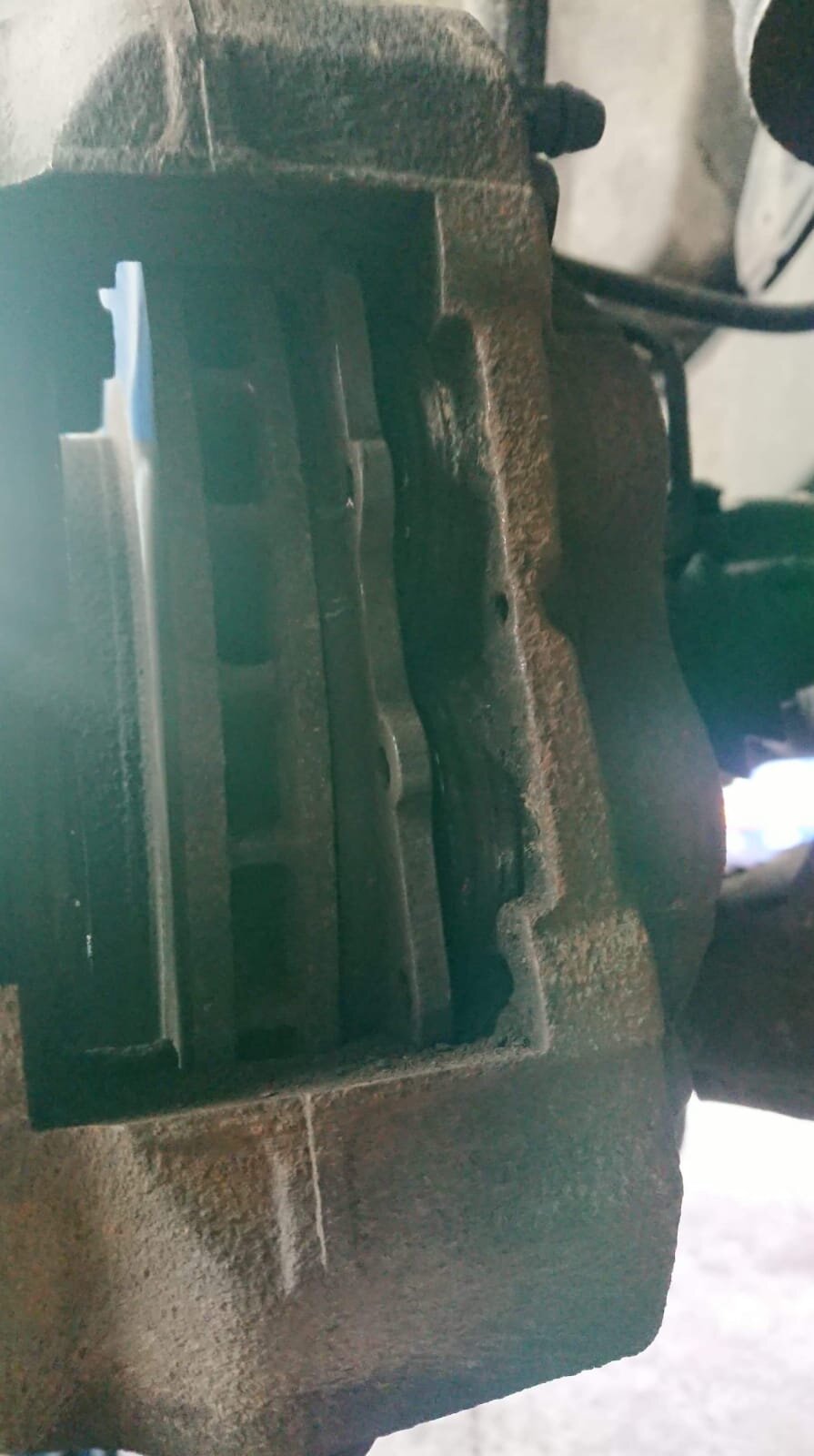

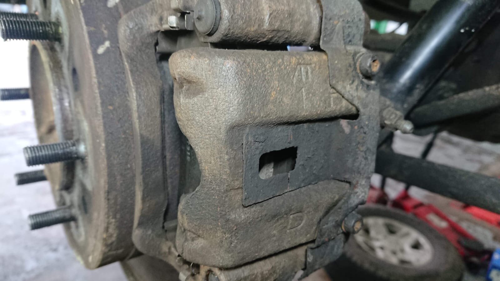

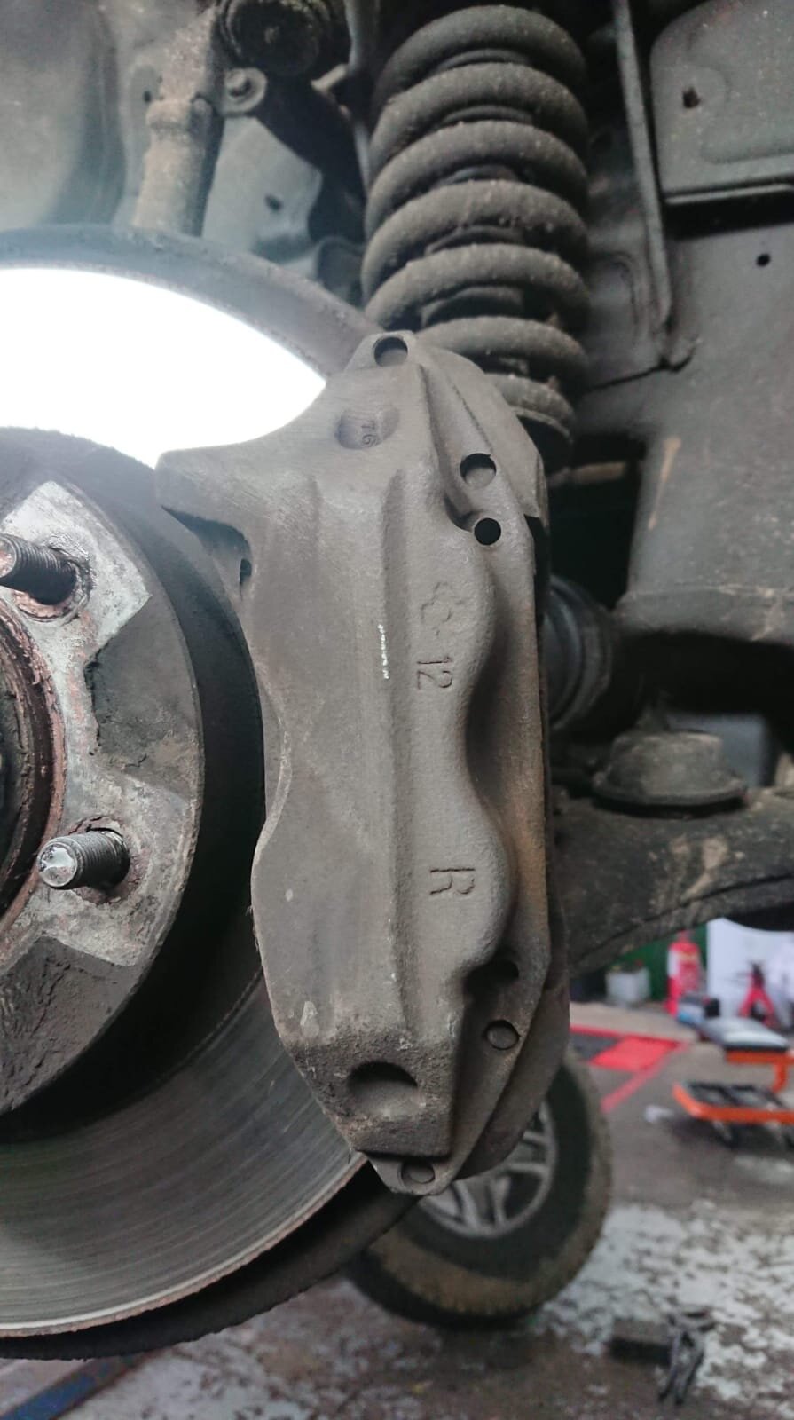

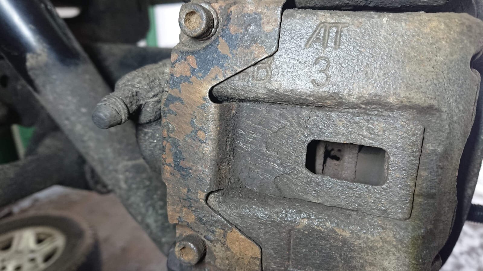

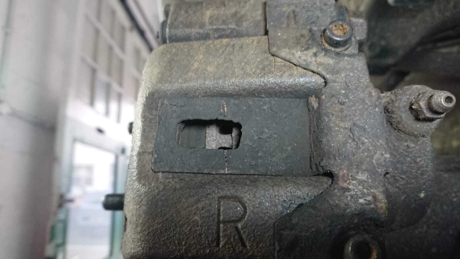

a./ what kind calipers do i have? worth of rebuild? (see attached pictures of my calipers)

All things considered, those calipers look pretty good. It's very hard to advise when we don't know how good you are on the spanners. I'd get a rebuild kit and have those done on the bench by lunchtime. If the bodies were shocking, I'd perhaps go with Big Redd but they aren't. So really if you replace them you're paying all of that money just for a few quid's worth of seals. You could buy replacements, swap them and then rebuild the calipers yourself and have a spare set. Reason they look good is because it's an import. Give that 2 UK winters and they'll look terrible. If you're ok on the the tools then get the seals and rebuild them. Quick wire brush of the outsides and you'll be golden.
i was told right side calipers stuck. killed pads fast. left side pads good. disc better on left side.
rear all good. except calipers.
car can stand till i sorted out.
